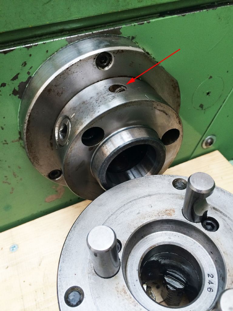

        I have a Boxford lathe fitted with a D1-3 headstock chuck mount.
        Just discovered that 3 Allen headed screw in the adaptor are not tight.! What are they and what do they do.?
        Just thought I would ask if they are meant to be tight or are part of some adjusting system before I start behaving like a mad octopus tightening them all up.
        Cheers, Nick

          They are for retaining the cams within the spindle nose. Certainly shouldn't be loose. Unless your system is unconventional or not original, I suspect there should be a spring and a pin behind them that mate with a groove in the cam. It may only be the spring force that is preventing them from coming completely undone.
          On my Bantam (and in the spec) the bolt is a cheese headed thing that bottoms out hard against a counterbored shoulder, so I'm not convinced your grub screws(?) are original or correct.
          Perhaps a Boxford owner could confirm.
          Here's a link to the spec for the Camlock system **LINK** showing you how it works and the recommended components. See 33.5.2 and 3.5.3 for the bolt and pin. No spring is shown unless I've missed something.

              my early 1980's is11.30 is built in a similar way to yours, just like in your photos. The screws are not loose.
              you might consider to telephone Boxford and ask them.
