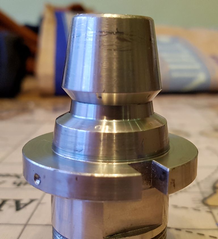

              I would be interested in something like this if the master shank were readily available in MT3 and the holders could be shop-made. The holders appear to locate on a taper but I couldn't see how they are prevented from rotating.
              #534370
              John Haine
                @johnhaine32865
                There's a dog (or two?) on the face of the "master shank" that engages with a slot(s) in the holder. Nice system in principle but expensive, not so easy to change as first appears, and they eat daylight between spindle and work. My Novamill came with an Easychange BT30 shank and a couple of ER16 collet holders, but I quickly got a couple of ER16/BT30 chucks and later some BT30 split collets to make better use of the limited daylight.

                    The Coventry type system is also available for slightly less from engineeringsupplies.co.uk. I tried making an ER25 holder from 304 stainless, but although it was made accurately, it soon developed runout because of indentations in the taper from the locking balls. It would need to be hardened at least in that region to be successful.

                        I see. The PDF helpfully linked by DC31k does indeed state that the tapers are hardened.
                        I assume that the balls bear on one flank of the taper groove rather than the main taper of the holder so that the holder is pushed into the master shank.
                        #534421
                        Andrew Entwistle
                          @andrewentwistle
                          The balls locate in the groove near the bottom of the taper, as evidenced by the indentations! Surprisingly both flanks seem to be engaged by the balls.
