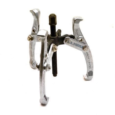

          I'm guessing some sort of spigot would have to go in the hole?
          Tony
          #463767
          Nick Clarke 3
            @nickclarke3
            Reverse the three legs so the 'toes' point outwards – but this type of puller is mainly meant for using this way round so this model is unlikely to fit a small bearing – but there are slimmer ones available
            #463774
            Bernard Greatrix
              @bernardgreatrix61453
              The bearing I'd tried to remove was about 2-1/2" diameter so plenty of room for the legs of the puller I borrowed.
              Incidentally the picture is lifted from the net, but is pretty much the same as I had.
              As I said its a matter of a few minutes work to reverse the legs.
              The problem is what does the centre screw push against.? I even found a U-tube video which spent ages showing how to reverse the legs (rather longer than it actually took) – it then finished without showing the critical part
              regards
              B

                  I would never have imagined that that type of puller is for anything other than external use
                  #463784
                  Robert Atkinson 2
                    @robertatkinson2
                    This won't work as an internal pulller unless the race is in a blind hole ot you can bolt a support across the back of it

                              Looking at the puller I would suggest that you unscrew the bolt completely then put it back in at the bottom (upside down) and then the top of the three legs can be used on an internal bearing.
                              #463816
                              Clive Foster
                                @clivefoster55965
                                Quite a few different designs of this style of puller. Depending on the details they may or may not be able to work on internal bearings.
                                As Ian says the key is to reverse the bolt and swing the arms the opposite way so they point away from the bolt head.
                                If the puller can work in expanding mode curve of the legs where they contact the spider must be such to force the legs further, or rather harder, apart as the bolt is tightened. Sometimes you may have to attach the short flat steel arms to the legs via the second hole. Mine is a 1970's (ish) vintage Sykes Picavant, allegedly the original one, and that essentially won't work in expanding mode to remove a bearing from the inside. Only one hole in the legs and the shape is such that generally there can be no reliable forcing out effect except over a limited. pretty much impractical, range.
                                You still have to find something for the screw to push against.
                                I tend to make up internal pullers on an ad hoc basis using an expander in a slotted alloy tube alloy with a small flange to grab the bearing. Or for smaller ones a threaded end expanding concrete fixture (Rawlbolt style) may do the deed. For larger bearings the same sort of expanding fixture may work is padded out with a suitable alloy tube saving significant work in making the device. I've gotten such to behave at tube wall at a thickness approaching 1/4". Hafta say I didn't really expect that one to work but I had appropriate sized parts so it was just a matter of turning a flange and cutting some slots. If it hadn't done the deed I'd have made a proper expander.

                                    If the bearing is in a blind hole you can just poke the screw through the bearing, otherwise you need to improvise a bridge of some sort.
                                    I've found it easier to improvise a custom puller with a bar with a central threaded hole pulled up towards a bridge piece with a couple of screws heads against the end of the casting.

                                      Or you can combine the two and use an angle iron bridge like Neil's above and pass the centre bolt of the commercial puller in the OP through the bridge so when tightened it extracts the bearing.

                                            I tried something similar to Neils set up and also tried an slide hammer lash up but couldn't get a lasting grip on what was left of the bearing. It was at this stage a friend lent me the puller
                                            At least I now know that the puller would not have worked despite being sold with int/ext suitability.
                                            I eventually removed the outer race with a grinding point but to no avail.
                                            Its water under the bridge now – we have a new washer and I'm glad I didn't fork out for the puller as well.
