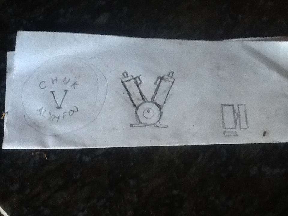

      The initial “Concept” sentto me via FB Mesenger
      Photo 1

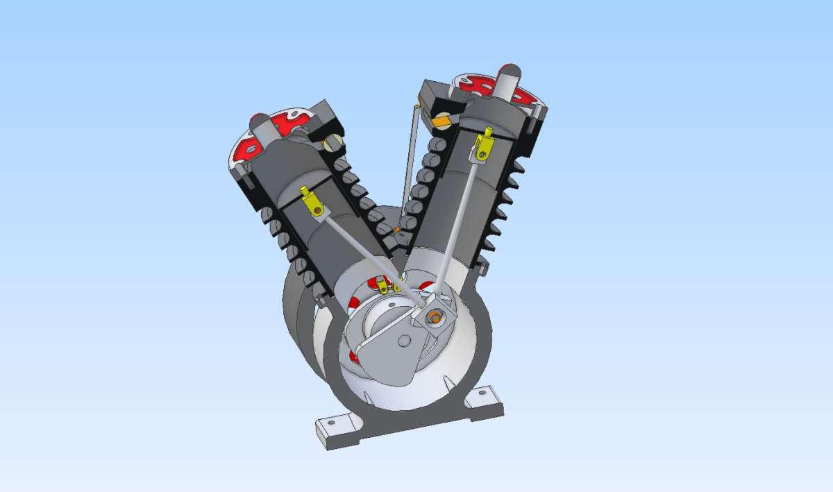

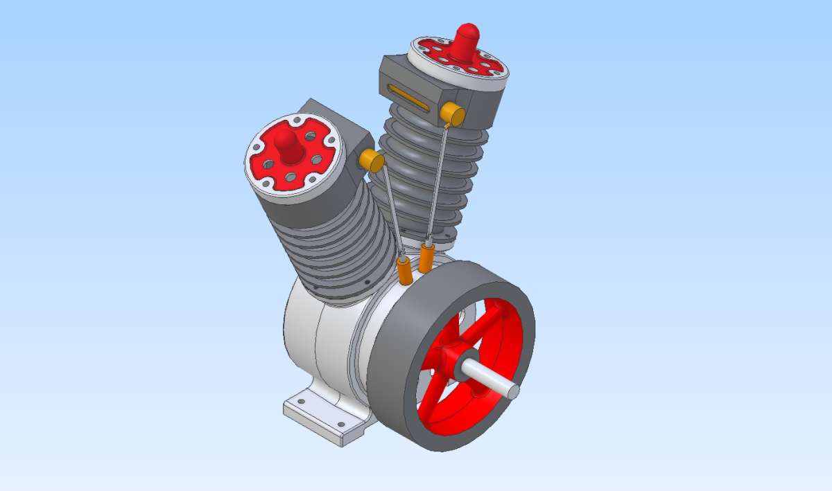

      My CAD design done in Alibre
      Photo 3
      What’s inside

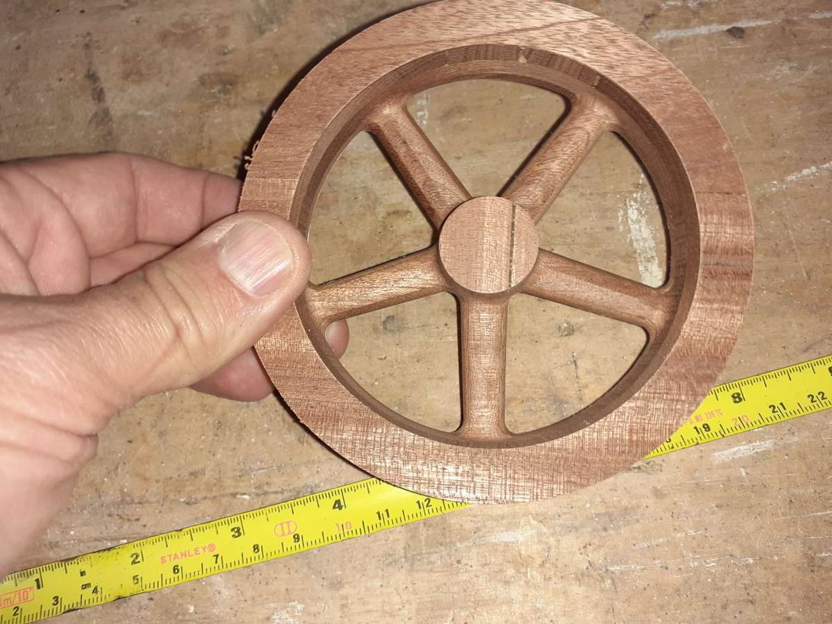

      Flywheel half pattern straight off the CNC

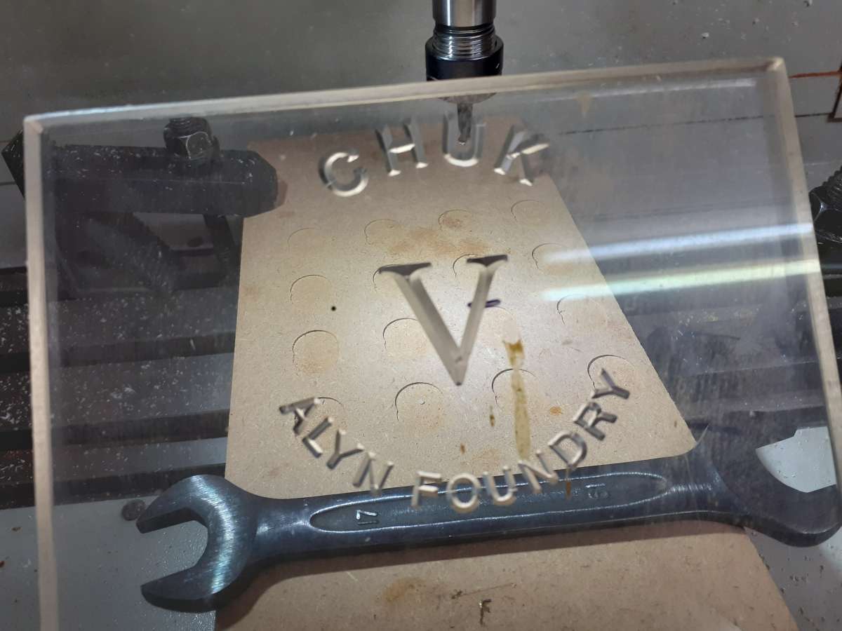

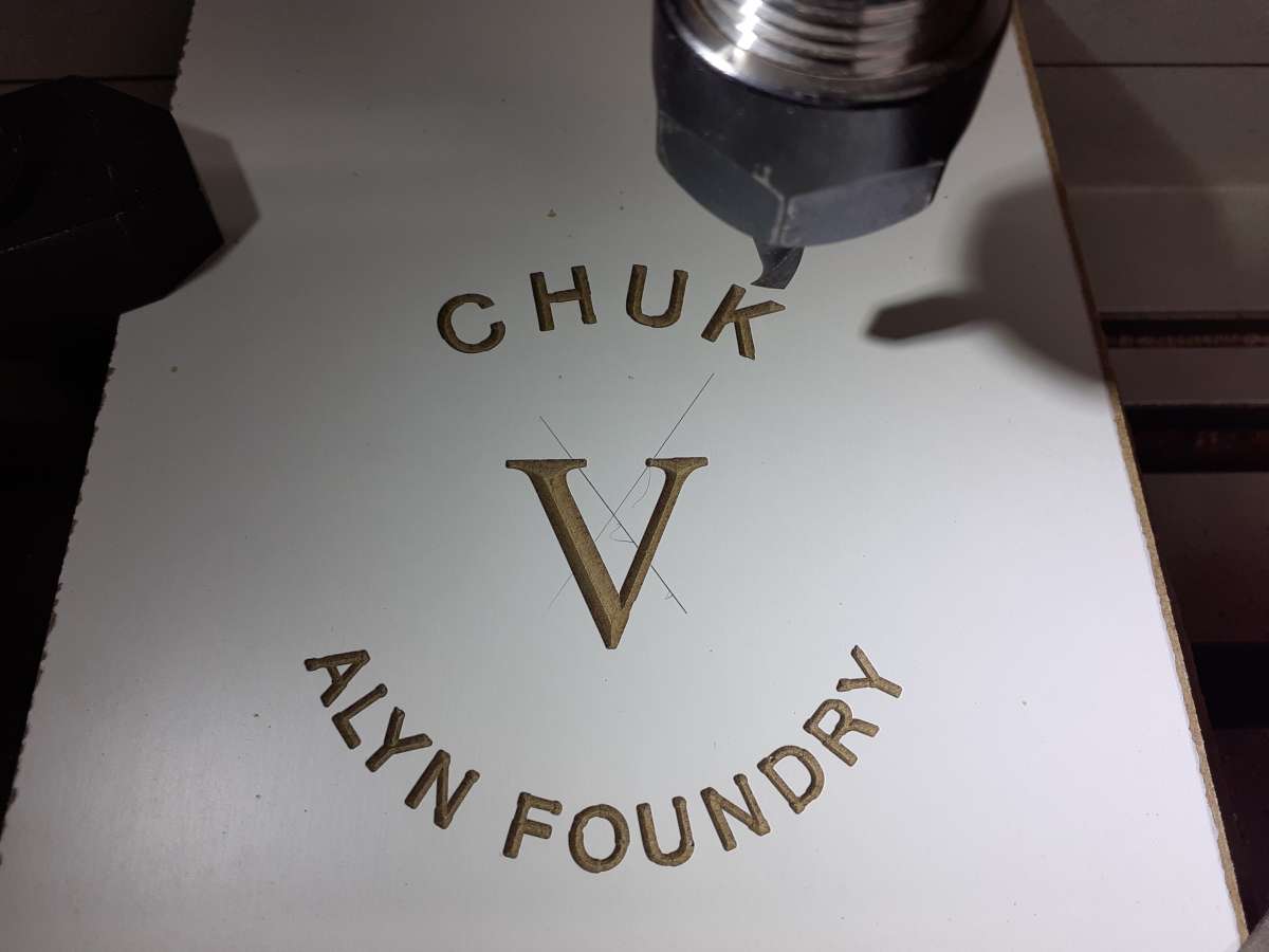

      Test cut for the coverplate engraving done in Melamine faced MDF
      20201026_145343

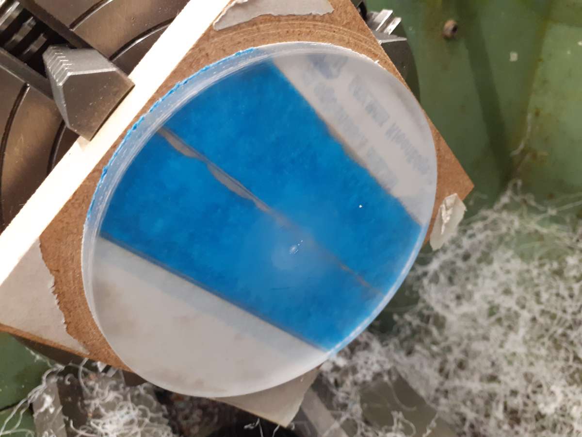

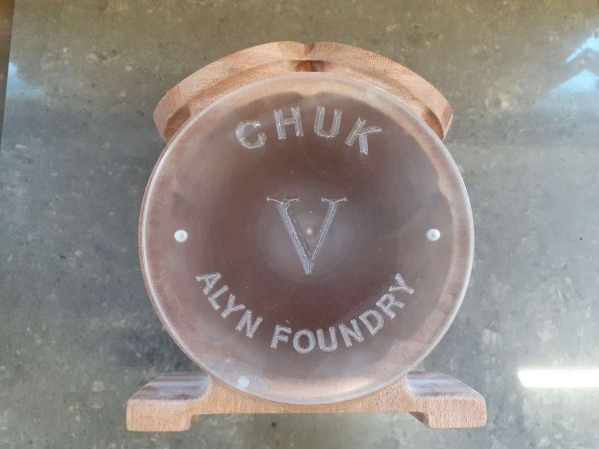

      Test cut in the actual pattern material 6mm perspex/lexan type material.
      20201029_103355

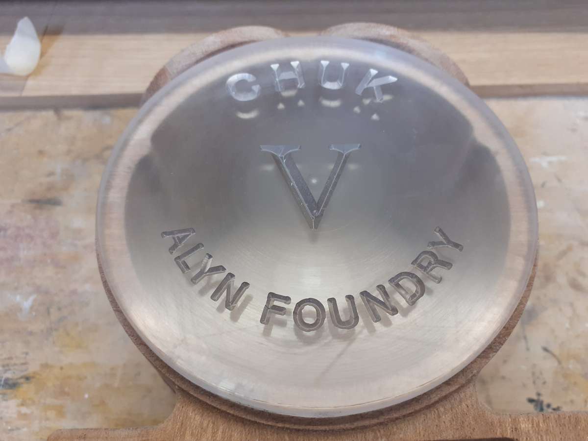

      Turning the pattern using masking tape and superglue method to hold it
      20201029_140324
      Completed coverplate pattern

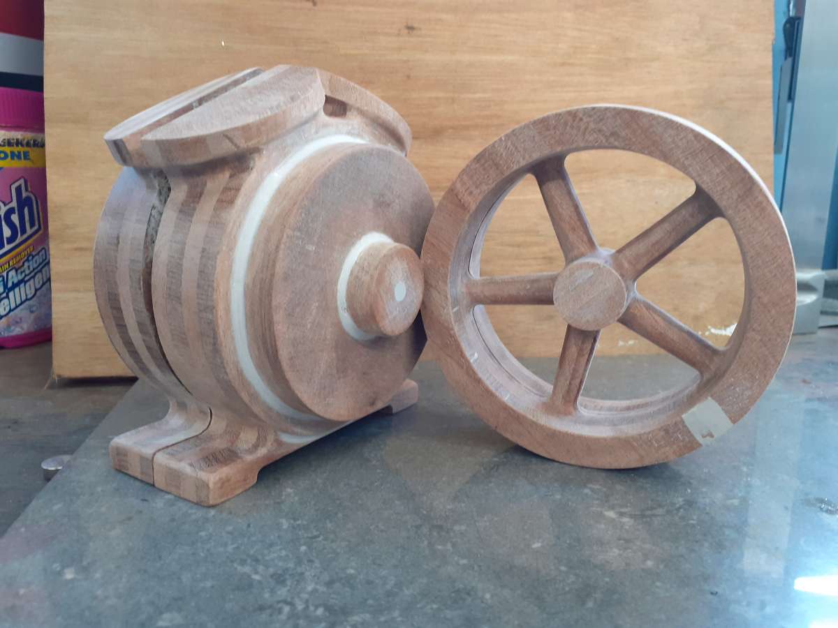

        The completed crankcase and flywheel patterns
        Photo 10
        Photo 11

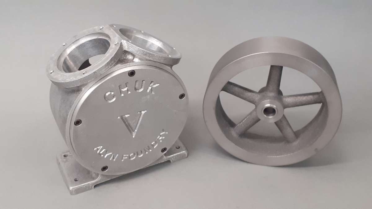

        What came back from the Foundry plus several flywheels that may come in handy
        Photo 12

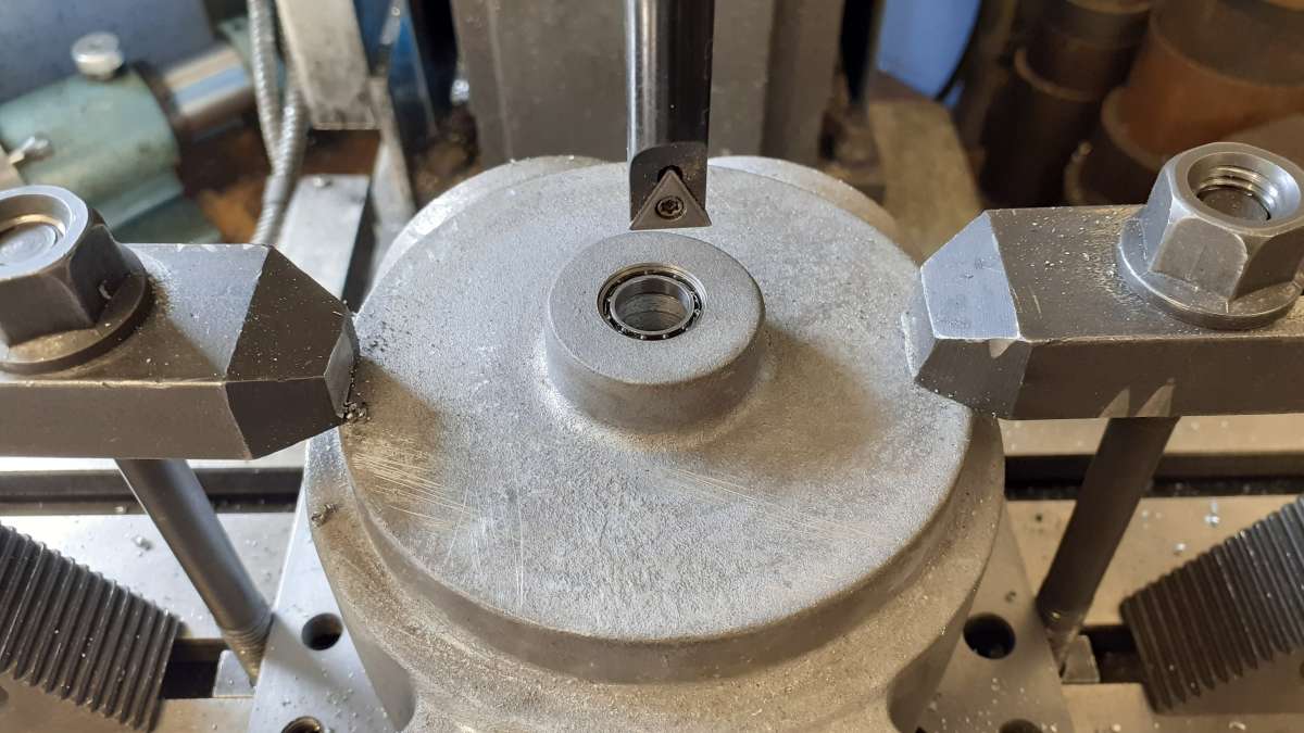

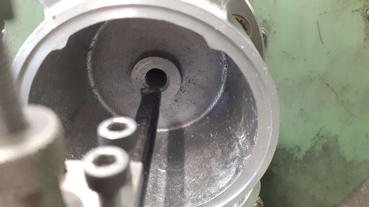

        Some initial lathe work, boring out for the ball races and coverplate recess
        20240512_093335
        And the one on the other side
        20240512_120518

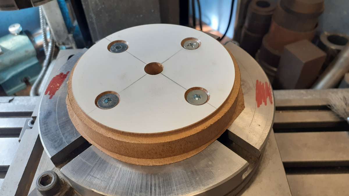

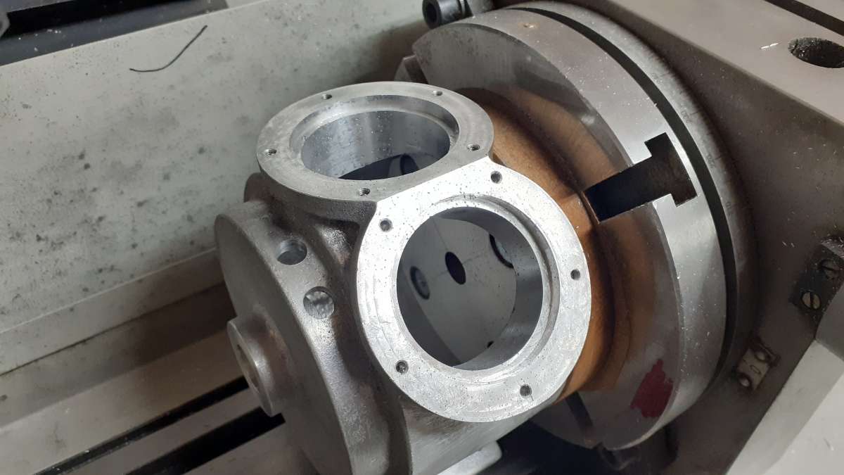

        Jig to locate crankcase on the rotary table which was my poor man’s 4th axis
        20240519_093431
        #827143
          Remaining machining all done on the CNC
          20240530_131754

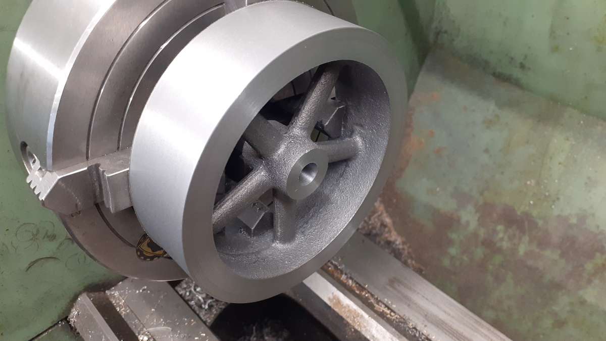

          Flywheel turned on the manual lathe
          20240531_144339

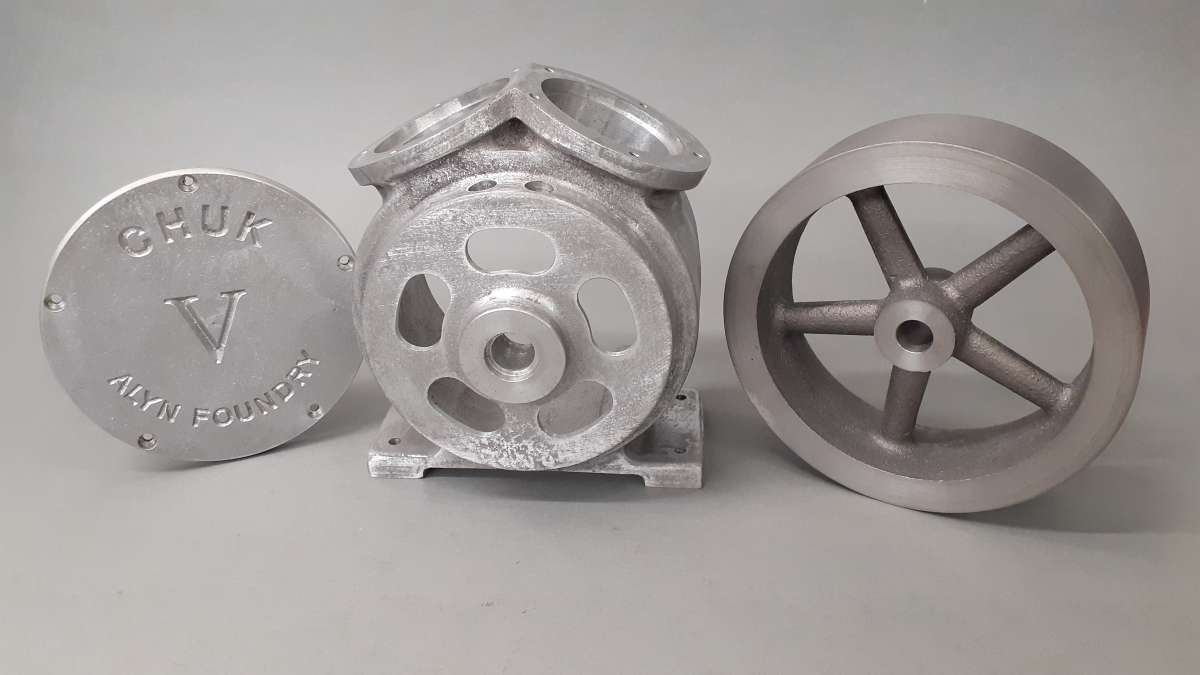

          The three parts complete
          20240601_082600
          20240601_082858
