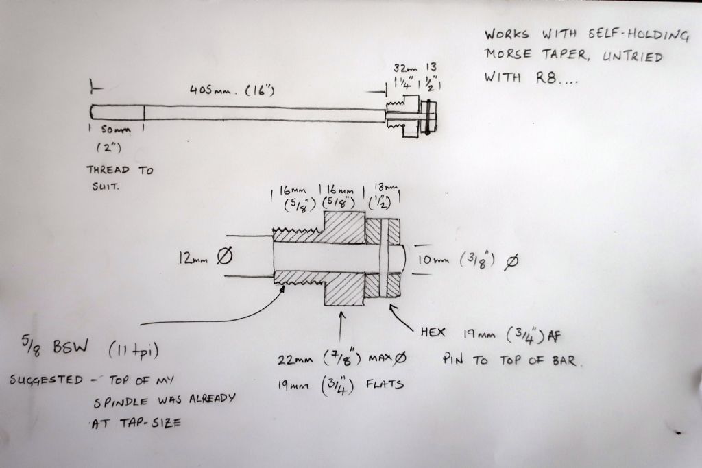

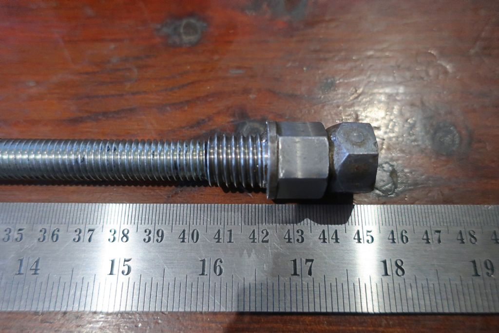

          On the basis that 4 1/2 years late is better than never..
          FWIW, a Major with MT..
          Decided that a 'ring-immediately-above-the-taper' wasn't going to work for lack of room. Investigating the top of the spindle revealed a recess of convenient dimension to accept 5/8 BSW thread (11tpi) – coarser than I would have liked, but with the reat advantage of being able to be cut in situ without disassembly.
          A sleeve nut was bored 10mm, through which was passed the suitably reduced portion of a 12mm drawbar, with a 19mm AF hexagon cross-pinned above to retain it and give a spanner-hold.
          Some attempt at concentriicity, squareness and 'fit' are desirable for smooth operation, the spindle bore being long and tight.
          It's been fitted for a few weeks and some dozens of tool changes, and has performed faultlessly using a ring spanner c. 150mm long to secure and release the tooling. Nothing has spun and nothing has taken anything harder than my hand to release.
          Although at first sight a 1mm land seemed a rather small area with which to eject a morse taper, when circumferential to a 12mm bar it provides a respectable total area that feels both adequate and positive.
          It'd be interesting to see if it would hold up for R8 use.
          #525733
          Howard Lewis
            @howardlewis46836
            Should be even better on R8 with the steeper taper, so less force needed to separate.
            Howard

              #525830
              DiogenesII
                @diogenesii
                ..those posts / pictures were revisited more than once during the long 'mulling-over' stage, Old Mart, so an overdue acknowledgement of gratitude to you for them – thank you for putting 'em up.
                ..The Major spindle nose has lug-slots, and once nipped up the sleeve nut is happy stay put and just gripping the tool and using a short cranked ring spanner like a handle makes for quick tool changing, and of course no more rapping with a hammer..
