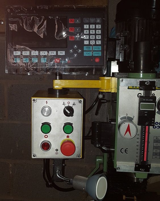

              As nobody has come back with any horror stories, I decided to take the gamble.
              An LCD display and 3 scales have arrived over the last few days.
              All seem to work okay and look to be reasonable quality.
              I have fitted the easy bit:20200812_162152.jpg

                Looking good. Good luck fitting the scales. Youtube has lots of vids of fitting these to most machines. So have a good scout round just in case there are problems, which you may encounter.
                Steve.
                #490353
                IRT
                  @irt
                  I have been watching and re-watching videos. One chap called ADE recently posted a very good series of 4 videos fitting a DRO to a Warco WM16. At the moment I am considering following his approach.
                  Anyone with any advice/pictures/links that may help would be appreciated.

                    All went well fitting the scales, and all seems to be accurate and repeatable,
                    I have set the direction to what I think is conventional:
                    Y increases if the table is moved back, X increases if the table moves left.
                    i have been using the mill for a couple of months now without any issues.
                    I have seen something today that I do not think is right.
                    If I set up a line hole position right/up the line is actually right/down.
                    If I set up a bolt hole circle, the holes are mirrored in the Y direction.
                    I have found someone's video on YouTube that demonstrates this:
                    (jump to 13 minutes into the video).
                    I think I have 2 options: Invert the Y direction so that Y increases if the table moves forward, or remember that the angle must be reversed when defining the pattern.
                    Has anyone else seen this, or am I doing something silly?
                    Edited By IRT on 06/02/2021 23:39:56
                    #525356
                    Steviegtr
                      @steviegtr

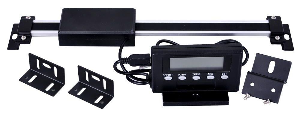

                      I have the MDRO fitted to my Mill. British supplied i believe. Also i see the supplied from overseas models fitted to most others because of the cost. I have not heard of any makes causing any problems at all. The way you describe the problem sounds like a mirror type error. I would think that in the settings there may be a way to correct the problem you have. If you are like me then you fit & switch on. After the Mushroom cloud clears , you decide to have a good read of the instruction manual. Hope you get it sorted. Sorry not to be of much help.
                      steve.
                      #525366
                      Paul Lousick
                        @paullousick59116
                        I used similar scales with a simple display on my first mill which were OK for about 12 months, then started giving false readings or not returning to zero and replaced the scales with a second set which also gave problems. The scales are not sealed and don't like moisture and dirt. When I upgraded the mill. I fitted Easson glass scales and readout and no problems for 7 years.
                        Paul
