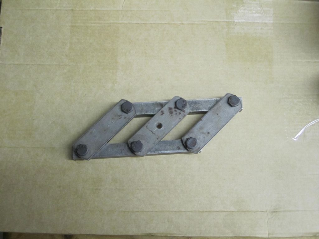

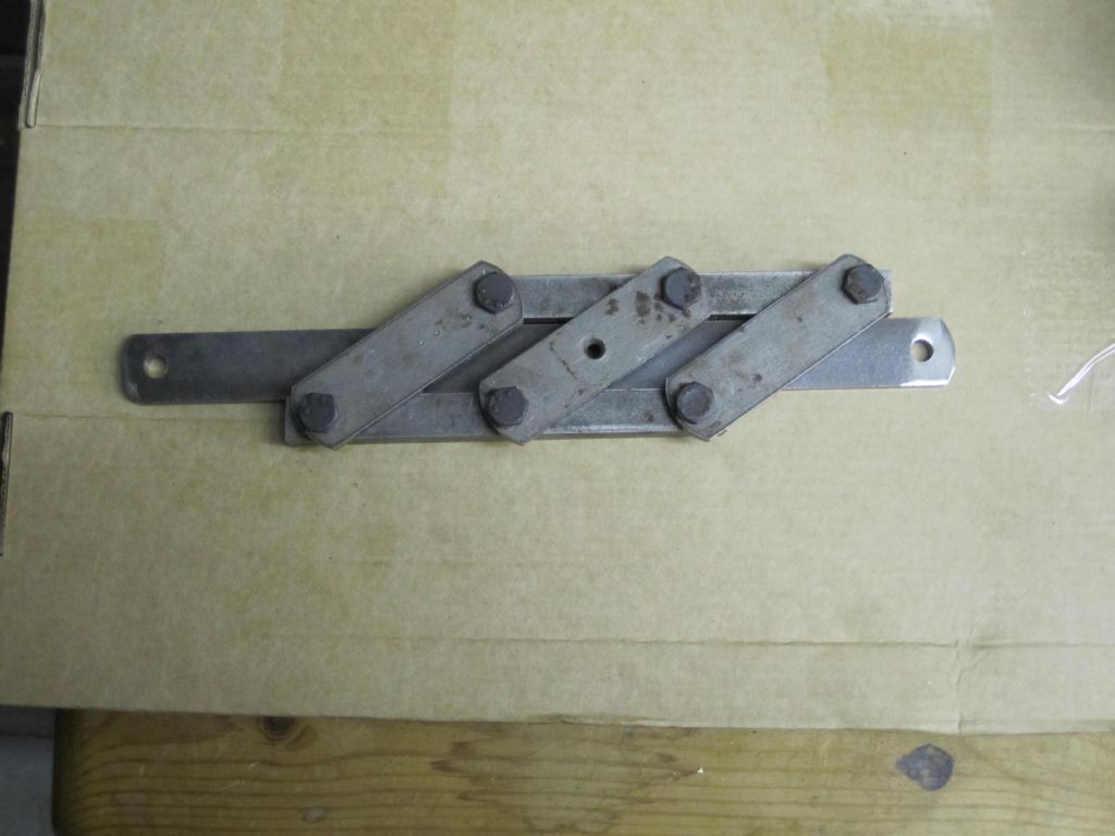

      I made one of these first when I was an apprentice. They are really useful if you need to mark multiple holes in a straight piece of bar.img_1398.jpgimg_1397.jpg

          I would dig out my odd leg scriber if the dro was not available on the mill.

            nice little apprentice piece is it held together by bolts or rivited?

              Bolts with loctite to allow minimal clearance. And it's quicker than odd leg caliper.
                Time is not generally a limiting factor these days. Rough and ready is a couple of pencil marks, one from each side, at each end – like a chippy makes – and scribe a line midway between the two pairs along the length. Close enough for gate hinges. Otherwise, on the mill if accuracy is needed.

                  Brilliant in its simplicity. Thanks for the idea. Is the hole in the middle made to accept a centrepunch or is it for scribing a small circle?

                    I have made several of these for different jobs. I tend make the hole suit a transfer punch.

                      If the tool is made accurately when closed on the strip the hole for drilling or marking through will always be on the centre line of the strip, no further measuring needed. Far simpler than setting up an odd-leg but I guess we all have our preferred methods.

                            A Wolf dowel jointing attachment I bought many years ago came with a much simpler centre drilling jig.
                            A flat bar with 3 equally spaced holes, the outer 2 have pins, the centre one has a hole for drill guides, rotate the bar to bring the pins firmly in contact with the work and the centre hole is on centre, like this –

                              The dowel jig does what it says as you are unlikely to want a dowel hole too close to the end of a chipboard shelf or end panel.
                              The metal jig shown earlier allows the hole to be drilled or marked at the very end of the bar.
