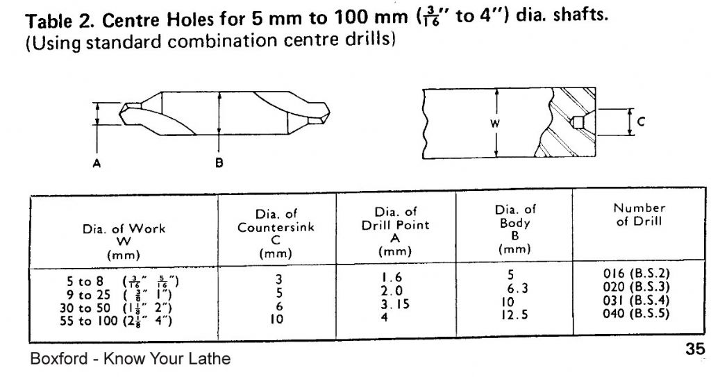

      i noticed that there are several sizes of center drills whichyou can purchase. What designates the use of certain sizes when drilling the end of a bar, for use with a dead center while turning? They are all 60 degrees, but they come in different sizes.
      Which sizes should I be purchasing for my myford ml10?

                  Thor 🇳🇴
                    @thor
                    Hi Jeremy,
                    Know Your Lathe from Boxford has a table showing Centre Holes for 5 to 100mm dia shafts:
                    Thor
                    Edited By Thor on 09/04/2020 10:32:36
                    #463425
                    Bill Davies 2
                      @billdavies2
                      I find I use a No.3 for most jobs, which matches the table provided by Thor. Looking at very large items turned on YouTube, I note that the centre sizes are quite small relative to the work. I wonder what the failure mode is.
