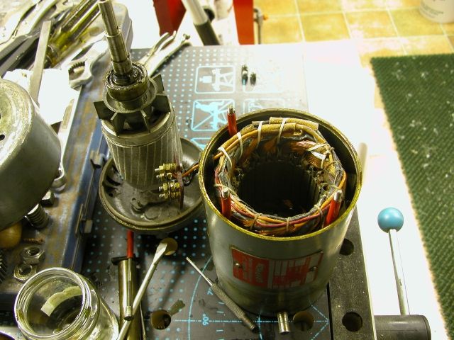

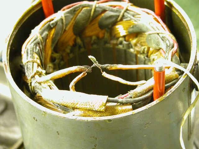

                                          I use two Mitsubishi VFDs on my 2B, both operated from a single box attached to the end of the table.
                                          #523658
                                          PropPete
                                            @proppete
                                            Nice setup, Gary. Are your motors original? If so, did you have to do anything to them to suit the VFDs output?
                                            #523836
                                            Gary Wooding
                                              @garywooding25363
                                              Both motors are original and both were wound in star only. I had to remove each motor and open it up to gain access to the star point which was then 'burst' and extension leads added which were then connected in 'delta' mode. The spindle motor, although heavy and awkward, was not too difficult to remove and replace inside the cabinet, but the table motor was another matter involving removal of the lead screw.
