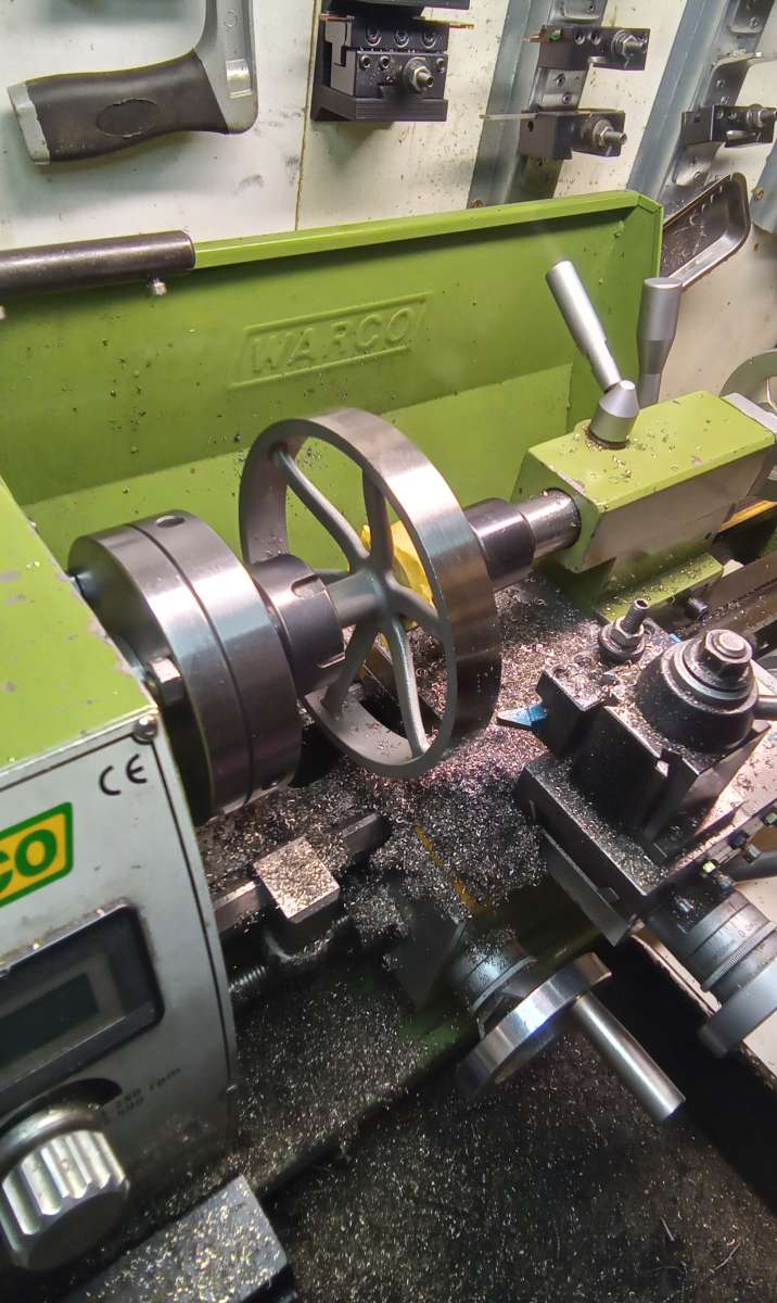

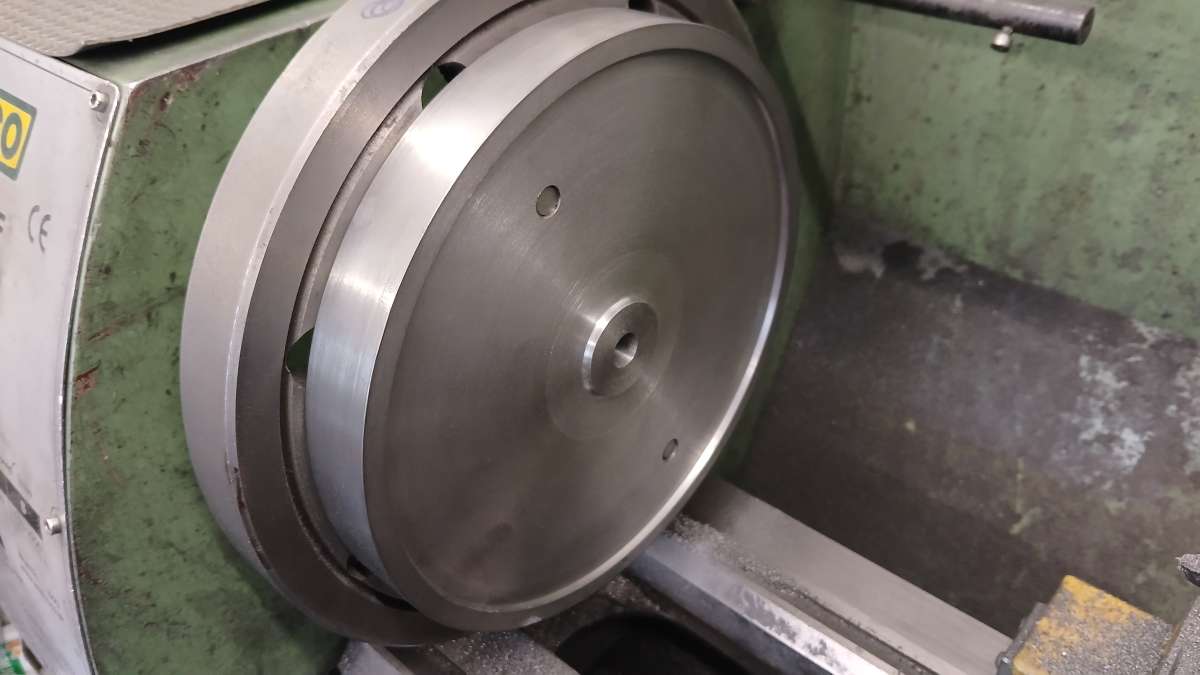

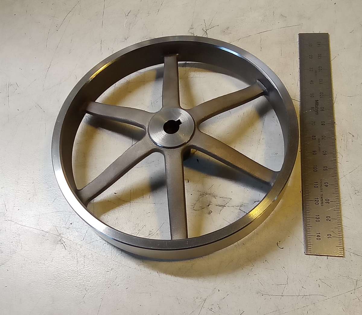

                    I don’t usually use brazed carbide, but I have a few tools courtesy of being in boxes of other stuff, and I recently found one perfect for the tricky job of machining a 3D printed stainless steel flywheel on a lathe which has no backgear and hence very little torque at its slowest electronically controlled speed.
                    At a speed fast enough to prevent the motor stalling, HSS rapidly lost its edge, and CCMT inserts tended to dig in and also stall the motor.
                    Brazed carbide to the rescue:
                    20261008_123042
                    It came out very nicely:
                    20261009_152616
                    (The irregularity adjacent to the keyway is a photographic artefact)
