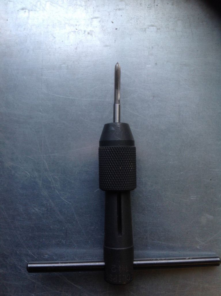

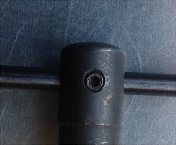

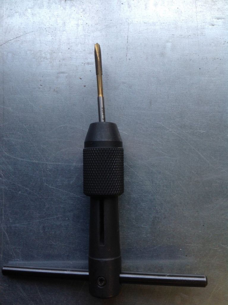

                                  Updating this thread, I've just bought a new Eclipse 142 tap wrench off an Ebay seller. It's going straight back, I'm afraid.
                                  There are two problems with it. Firstly, the flats on the set screw that holds the tommy bar captive are already rounded off after one tightening and loosening. If the tommy bar hadn't been such a loose fit in the hole it might have helped; as it is, the set screw has to be tightened down particularly hard to eliminate unacceptable wobble in the tommy bar. I've plenty of better-quality set screws to replace it with, but the second fault makes that not worthwhile.
                                  The second fault is that taps will not sit straight when the jaws are tightened up, whether you use the outer jaws or the inner ones.
                                  My older Eclipse 143 has none of these faults. Sadly, like a good many other established brands, it looks like Eclipse is in eclipse.

                                    Or it is a knock off
                                    #465104
                                    Bill Phinn
                                      @billphinn90025
                                      Posted by AdrianR on 16/04/2020 19:05:32:
                                      You can judge for yourself.
                                      #465105
                                      Tony Pratt 1
                                        @tonypratt1
                                        The grub screw looks like a typical Chinese cheapo item, I would say it's a copy or Eclipse are having their stuff made somewhere east of Ipswich. My Eclipse tap wrenches are decent bits of kit.
                                        Tony
                                        P.S. S & J are getting them made abroad
                                        Edited By Tony Pratt 1 on 16/04/2020 19:16:20

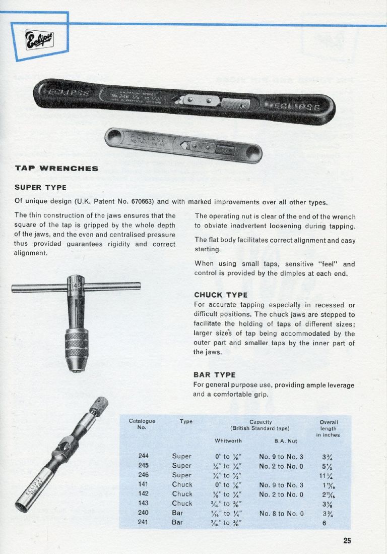

                                          Hi Bill, this scan is from a 1967 catalogue.
                                          Regards Nick.

                                            Thanks, Tony and Nick. I really like reading the old catalogues.
