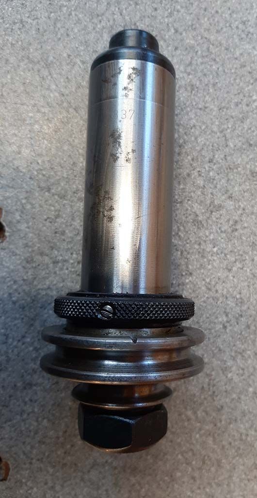

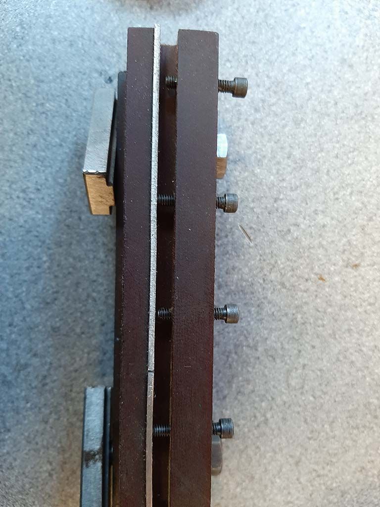

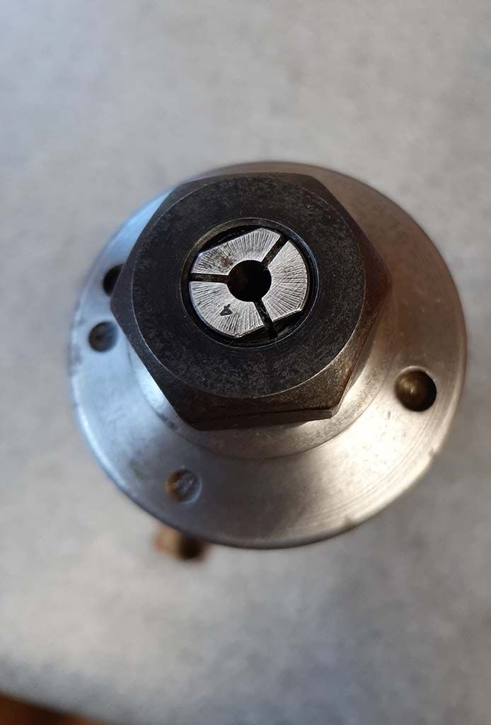

        Been having a clearout and found 2 items which I have no idea what they could be for. I got them when I bought an old mill a few years ago

          First looks to be some sort of a toolpost grinding/milling/engraving spindle
          Bill
          #451861
          Joseph Noci 1
            @josephnoci1
            Engraving spindle, driven by a round belt from a 'sewing machine' motor…
            the second – maybe used to hold the engraving stencils on the table – sort of Pantograph machine?

                If you search for images of Taylor Hobson Engraving machines you will see this part on some of them.

                  Ah right –Taylor Hobson
