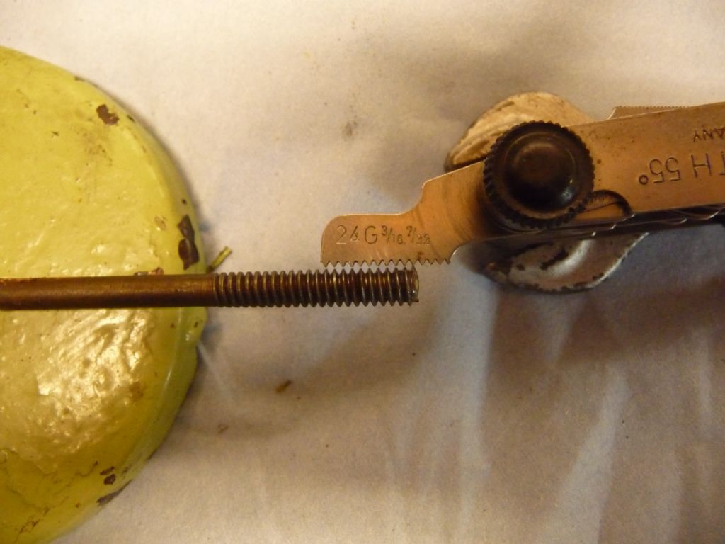

      Stripping down Brook "Cub" motor off Myford Super 7 lathe. It has 4 long studs threaded each end holding the front and rear casings together.
      The studs are 5/32" diameter with a thread which is 24 tpi.
      What thread form would that be? It doesn't correspond to anything I'm familiar with. Some of the threads are damaged so I need to tidy them up and was hoping to run a die down – nothing is ever as simple as you'd hope!

          Possibly BA? Commonly used on old British electrical gear. Plenty of BA thread charts online to check.

            Technically its probably specified as Admiralty Fine as all sizes below 1/2" are 24 tpi Whitworth form. Admiralty being notorious for appearing on all sorts of odd-ball sizes.
            Good luck with finding a die! Maybe a thread reforming file will be close enough.
            In practice I guess its just "the thread wot they used". Seems to be common on smaller UK made motors of a certain era.
            BA, as suggested by Hopper, is too fine. 4 BA and 3 BA are close in diameter at 0.1425" and 0.1610" respectively  (5/32 is 0.1563" ) but the threads are 38.7 and 34.8 tpi respectively.  I've seen several motors with 3 BA studs.

                    Posted by Philip Edwards 2 on 28/03/2020 09:53:55:
                    Sounds non-standard, but could the measurements be off? I usually manage to miscount TPI.
                    Any chance of a close-up photo of the screw-thread laid next to a rule?

                      Yes, def. 24 tpi. See photo.
                      Admiralty thread is not one I've come across before.
                      I'll try tidying with a file or as Duncan suggest, substituting M4 studding .

                        Very few of the books include Admiralty Fine as it was primarily intended for special jobs where normal threads wouldn't be appropriate. Usually odd ball diameters or where you don't want a standard fastener thread used to protect against the wrong thing being screwed in. ( 0 BA in 1/4 BSF being the classic example of where the wrong thing can be screwed in with potentially disastrous results as the joint is very weak and has insufficient wedging action to reliably stay tight. )
                        Admiralty fine is whitworth form:-
                        24 tpi up to 1/2" diameter
                        20 tpi from 1/2" to 3/4" diameter
                        14 tpi from 3/4" to 1" diameter
                        12 tpi from 1" to 2" diameter
                        8 tpi from 2" to 4" diameter
                        6 tpi above 4" diameter

                              The tail end of the thread looks very truncated. I'd try a 3/16 bsw nut if you've got one
