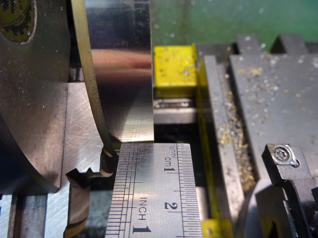

I still have the offcut from my Hoglet flywheel so stuck it on the chuck and cleaned up the cast surface with a CCGT tipped tool to get a clean start to try the HSS on.Taking a couple of light 0.010" deep cuts as Nick is not worth wasting more bronze on and besides he said he only wanted to skim a little off. Came out like this at 600rpm which is not too shabby.

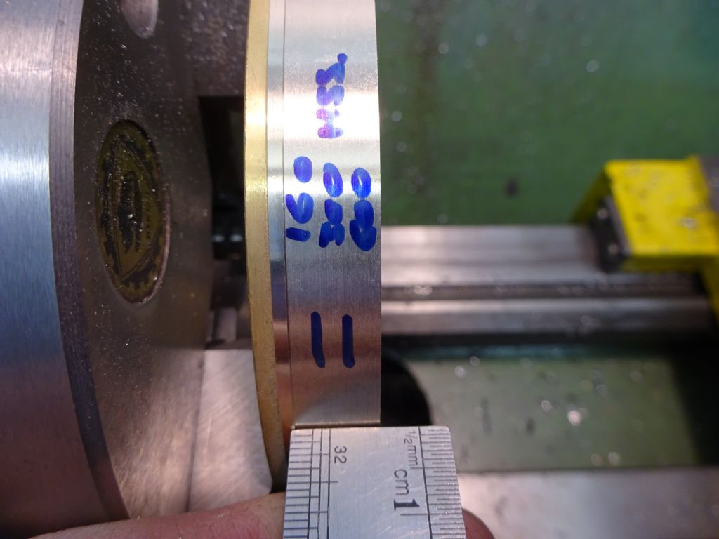

I then tried some HSS started at 600rpm, stopped the feed and twiddled my knob down to 300rpm and cut a bit more, stopped and twiddled to 160 and cut a bit more. I know what tool and speed I would be going with
Probably could have faffed about tweaking the HSS tool geometry but would have had the job done in less time than that would take with the CCGT.
