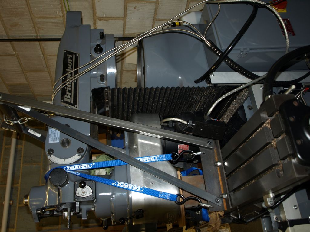

            Bridgeport Spacer
            When you have found one, you can do this on your own. Sorry about the rotation, I cannot seem to turn it through 90. This uses the knee and table to lift the head, it weighs around 400lbs.

              No need for special brackets etc.
              just wind the ram forward as far as possible, bolt a box plate onto the bed and bolt this to the ram dovetails and you can then wind the table up to lift the head.
              I was a bit uncertain with mine as it has a Beaver slotting head on the rear which is bigger and heavier than a Bridgy slotting head. I thought I may have to follow it up with a porto-power but no need, lifted Ok and was able to get a 4" spacer in.
