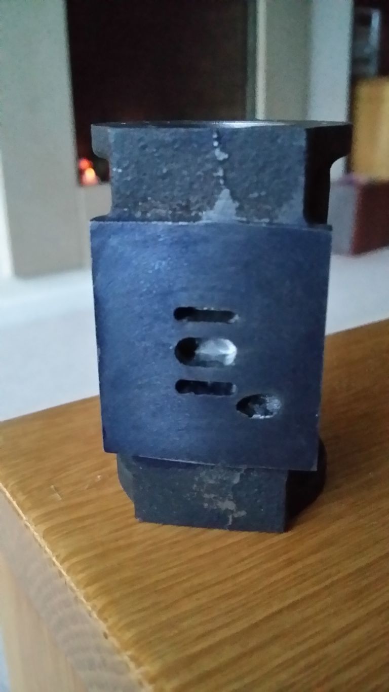

        Hi All
        As you can see I have a rather large inclusion on the port face of this casting. Unfortunatly I am unable to send it back. Do I either a) do nothing as it may not interfere with the performance? b) fill it with JB weld? c) plug it with cast iron? the last option as I see it is probebly the best but i'm reluctant to do this (I'm still a bit of a novice). What are your thoughts on this. Thanks in advance for all replys.
        regards
        Paul
        #306554
          As its a bearing surface, I'd probably plug it, but using brass or gunmetal.
          That said, it looks like a stationary engine cylinder, not a loco cylinder so it may never work hard and JB weld will probably to the job – choose the original, slow setting flavour.

            Yes it is a stationary engine cylinder. Why would you use brass or gunmetal and not the parent metal to plug it??

              It's much easier to make a small plug out of brass than cast iron, especially if you want to thread it.

                  It doesn't encroach on the ports, there looks to be room to make a seal on the valve chest. If it's blind live with it

                            I had an old Stuart No.1 that I was restoring. This had very poor ports, and an inclusion right next to a port. I don't know how it ever ran. After taking some advice, I milled the whole port area away to a depth of about an eighth of an inch then fitted a plate of cast iron (a spare steam chest cover) in the excavation with epoxy resin: then milled new ports. Worked very well.

                              You could braze or silver solder it up and re-machine. I had T13 Bugatti inlet port on the block, when I filled the radiator up water poured out of the carburetor!

                                Just cover the complete port face with a brass or bronze plate with the ports cut in it, this a perfectly acceptable way of working some designs use this method, Tubal Cains Beam Engine Mary was designed using this method.

                                  For future ref… I had an inclusion fault with my S10V, similar to the above, what I did was to use cast iron filings mixed with 2 part epoxy resin to plug the inclusion, worked fine. I had earlier decided to collect & keep CI filings in a tin with thought 'just in case' in mind, usually when I've filed the flashings of castings, these tend to produce fine CI dust so easily mixes with any binding media. I've done the same with brass filings.

                                    If the void in the underside of the valve will move over the hole which it looks like it may do then you could get steam/air escaping down the exhaust.
                                    Can't see the exact shape of the hole but if it is just half an egg shape then it is going to get smaller as you machine the port face so may clear the valve.
                                    I would do as Stew says and machine up a thin piece of CI about 1mm thick, cut the ports in that and retain with a couple of CSK screws that fall under the steam chest edges, smear of JBWeld or Araldite to seal. Steam chest studs will hold it firmly in place on assembly

                                      Thank you all for all your reply's. I think I'm going to try and make the cavity in the valve smaller and see how I get on with that. I'ts a great idea of stew and Jason B but i'm not confident enough to cut a 1mm slice. the cavity is indeed egg shaped and is about 4mm deep. I will keep you informed of how I get on. thank you all once again.

                                        The point that the valve will seal on the surrounding metal is a good one, if you fill with JB Weld it shouldn't wear into a low spot.
