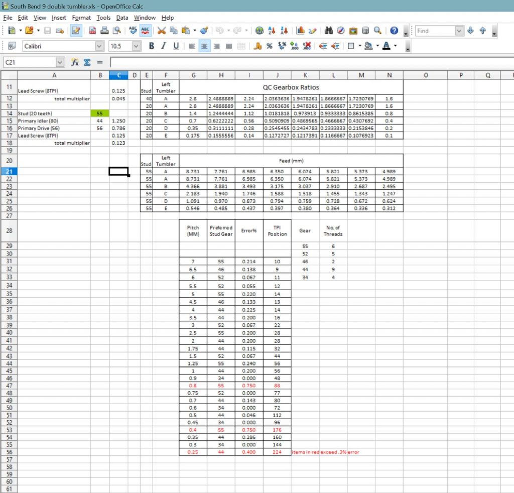

                                                  Cupboard
                                                    @cupboard
                                                    Thank you so much, and DC31k that table is fantastic.
                                                    Just to check I'm understanding things correctly, when you say "change gear ratio", I think 1:1 would mean something like a 40 on the top gear, 80 on the middle/idler and 40 on the bottom gear? Then 7:10 would need a 35 and a 50?
                                                    I think my best bet from here, assuming I've understood things correctly, is to get a pile of gears printed for testing purposes, try a few combinations then depending on how I get on and what I decide possibly look at the leadscrew from Ian P
                                                    It's quite frustrating being thousands of miles away from my shed, but got to earn the money to buy random chunks of rust somehow!

                                                    mark smith 20
                                                      @marksmith20
                                                      I use a southbend 9A which is similar to the boxford . When i make metric threads using the imperial leadscrew ,i use a spreadsheet calculator that i was sent by someone in the US . Its quite good and calculates which gears you need on the gear train to use in conjunction with the gearbox. Gives all the pitch errors and enables me to cut metric threads without the need for the expensive 127/100 gear.
                                                      I would upload it but i think you can only post photos. heres a screen shot.
                                                      Edited By mark smith 20 on 27/10/2019 16:57:47
                                                      Edited By mark smith 20 on 27/10/2019 17:05:47
                                                      Edited By mark smith 20 on 27/10/2019 17:17:40
