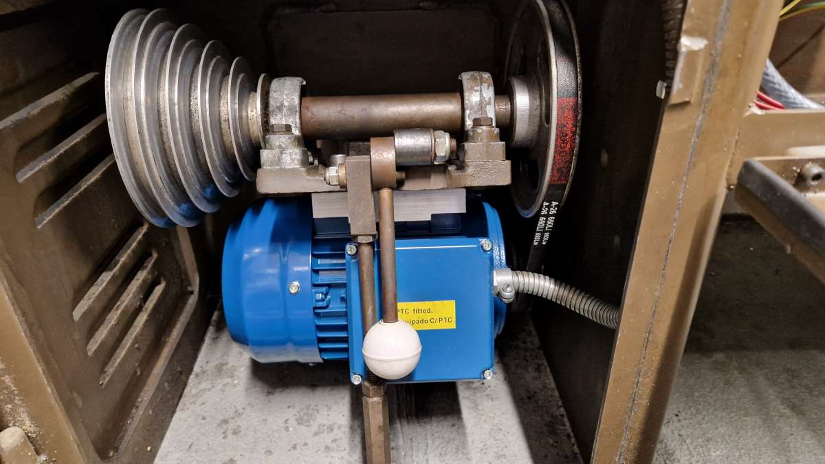

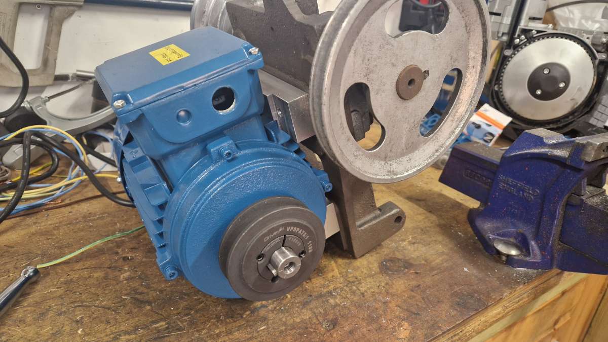

                            I have done the motor swap & fitted a VFD, here are some pictures.
                            20260404_171226
                            Motor fitted to it’s bracket, I replaced the supplied feet with new ones that match the bracket, whilst they are chunky and have not adjustment in the feed, just the bracket, they do the job with about 20mm of adjustment. I replaced the puller with a new one, that is taper-lock, surprisingly cheap compared to an imperial one, this is 75mm rather than 3″.

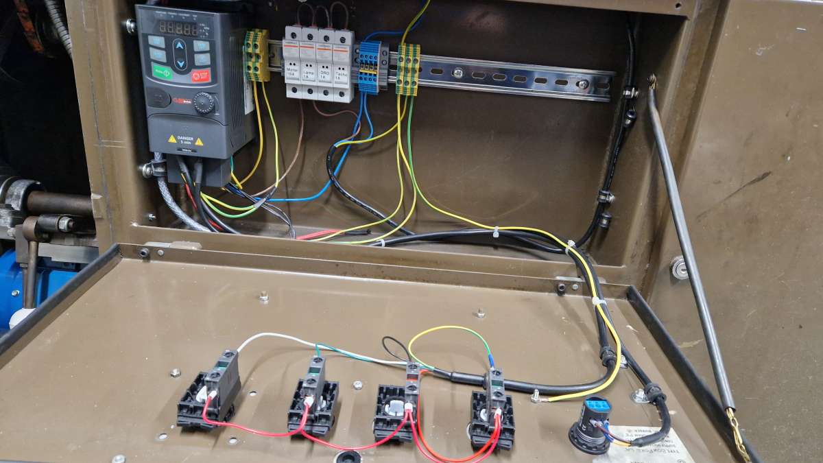

                            20260411_120905
                            Electrics mounted in the cupboard, I have added fuses to allow for me to add in a DRO & tacho in the future. The only issues I had were that the number of earths I could fit in the VFD is limited, hence extending the control cable screening to the earth on the DIN rail.
                            The supplier suggested a 16A fuse, which i fitted, even though it is fed off a suitably fused 13amp plug.

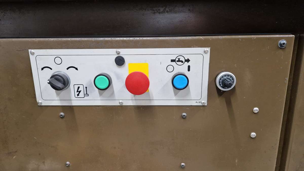

                            20260411_121054
                            I have used the existing hole for the suds pump, that I do not have, so the jog control, only jogs forwards, but I don’t imagine it will be an issue for me. I decided to replace all the switches as I was adding one, also replaced the rubber edging on the door. Since taking this picture, the coolant image has been painted out.

                            One thing I found from the manual for the motor, don’t run it below 30Hz, without external cooling, even though the motor is rated down to 5Hz, if I want to go slower, I will add that, I decided for the occasional jog, with no cut, when you hold the button, it will be OK. Perhaps I should have looked at the minimum motor speed more, I was expecting there to be a point it would need extra cooling, but not that high.
                            The suppliers quick start guide was useful, but adding the jog control meant I had to make some small adjustments, like make the minimum speed about 5Hz, but set the lower limit of the potentiometer to 30Hz.
