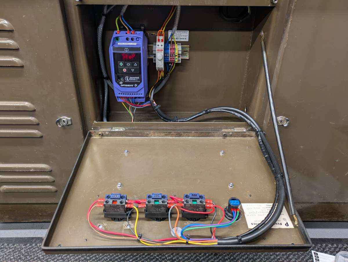

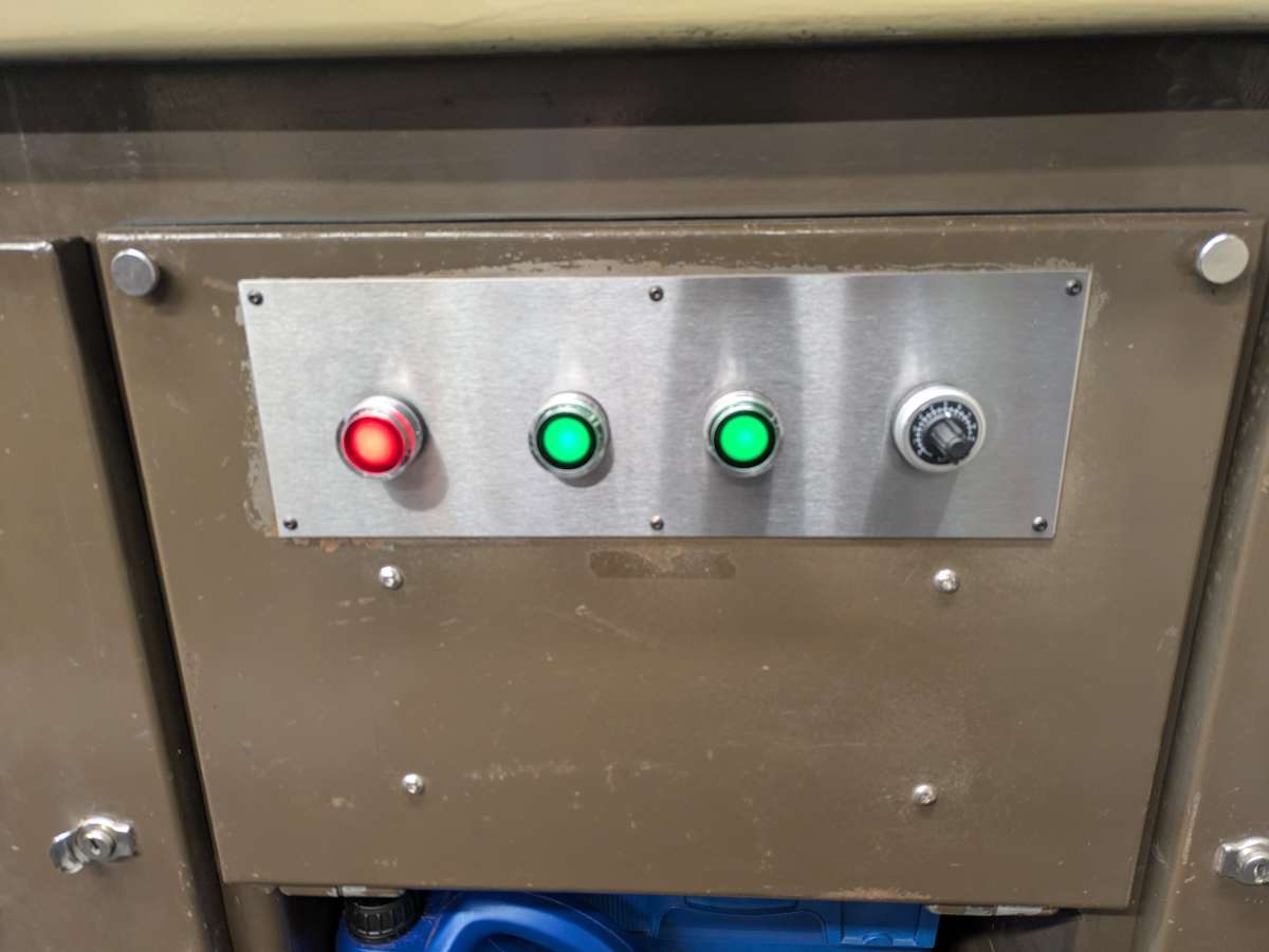

                Fitted one to my Boxford a couple of weeks ago. I used an Invertek drive. (This is the 3rd one I’ve done since I have been very happy with them). The middle of the Boxford cabinet is the perfect place. I wouldn’t worry about cooling too much, IIRC the only requirement is about an inch gap all the way around. The fan in mine very rarely kicks in so it can’t be getting hot.
                I went the whole hog with this setup. VFD, Shielded cable, illuminated buttons, din rail mounts etc and the whole lot came to just over £200. A package would be double that!

                  Hollowpoint’s design is excellent and easy to achieve. I used an Invertek optidrive of 750W for a 1hp motor and added an aluminium heatsink to the back just in case to increase the cooling area. The rated heat output of my one was only 40W at 100% output so it was probably overkill. When you also need a new motor, get one with the same power as your old one, but be prepared to deal with mountongs and also the motor shaft may be different in diameter and length.
                  As always, I recommend the Inverter Drive Supermarket for inverters and motors, especially if you are going to do the electrics yourself. Many of the inverters they sell have the excellent “quick start guides” which can be printed out showing how to wire up the remote butons and controls as well as the programming that is needed, worth its weight in gold.
                  I have just noticed that the Invertek Optidrive is now made in the UK, a little more costly than the WEG.

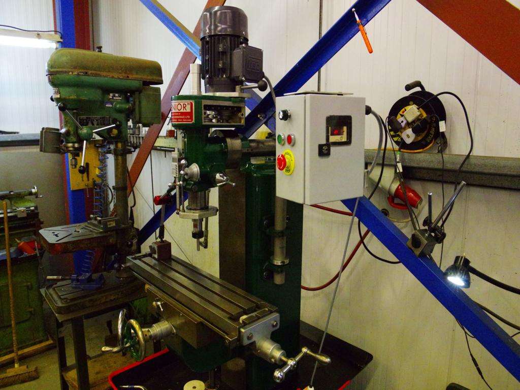

                    I thought I had used an Invertek VFD, but it was a Schneider VFD, screaming out at me when I checked my photos from when the Tom Senior was first running. That particular model is now obsolete. The other thing I had forgotton is that three phase motors that you would be interested in come in different speed ranges. 2 POLE =3000RPM @50hz, 4 POLE =1500RPM, 6 POLE =1000RPM AND 8 POLE =750rpm. The more poles the slower speed, and they cost more. I used a 6 pole on the Tom Senior with the VFD programmed from 25 to 75 Hz which gave speeds from 500 to 1500 rpm which in addition to the four belt speeds gives a very good total range without loosing too much power at low speeds.You should check the speed of your existing motor before ordering a replacement, it will probably be around 1425rpm. Most of the motors in this power are sealed but with a small cowling and an end fan.
                    IMGP0938-1024x768 ts mill

                        I do like that setup, having the controls mounted like that, rather than on a box/panel sticking out or elsewhere is exactly what I would like. I have a couple of questions from that, was the £200 including the motor? Can you also say what the items are on the DIN rail? It looks like there is 240v going to the front panel, which surprises me slightly. I looks like you have not included the option for forward/reverse, which I assume would just be another switch.

                          Plus one for an explanation of the DIN rail widgets, please.

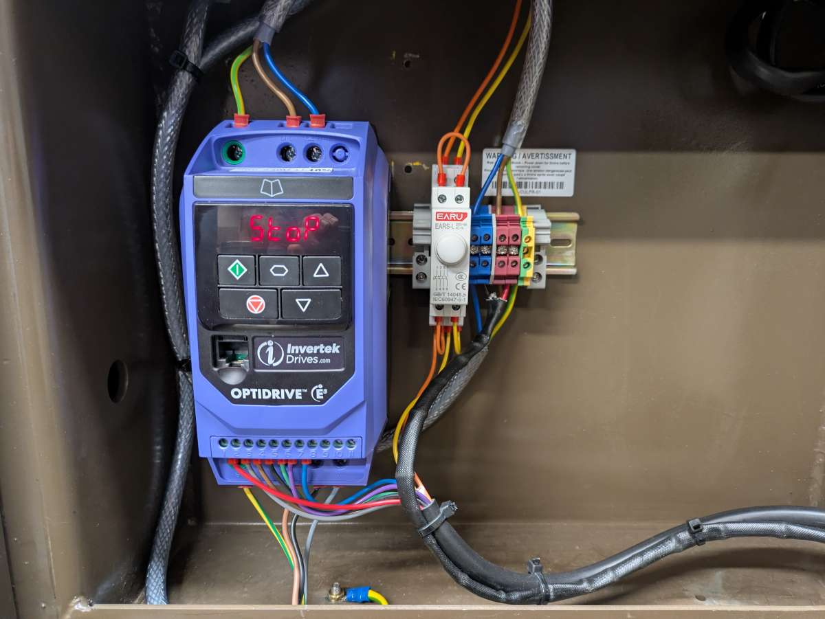

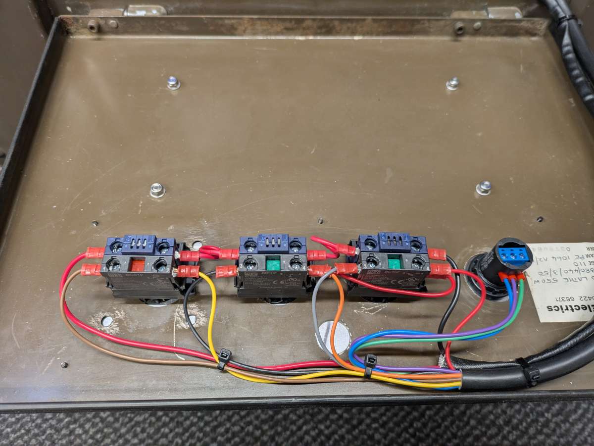

                            Looks like the white item on the DIN rail is a relay / contactor. The coloured items are terminal blocks.
                            I assume the relay is providing a latch / no-volt release for the stop start buttons. As there are two green buttons I assume one is forward and the other is reverse.

                              Hollwpoint’s installation looks neat.  My only safety comments would be that of an apparent lack of earth straps (from doors to cabinet) and that technically, the doors should be securely fastened by a lock or other means.  Picky, I know, but simple means to avoid of an unwanted shock by anyone at any time.

                                And I’ve been berated for commenting on people having VFDs completely exposed!
                                While a earth strap o the top panel with the controls would not go amiss, as there are no mains components on that panel one is not strictly required by the standards.
                                As long as the lower panel is fastened by normal screws i.e. ones that need a tool rather than a thumbscrew that would be compliant too.
                                We can’t tell if the mains inlet, fusing, isolator etc is OK as its not in the images. Overall it’s a good installation and no glaring safety issues.

                                  That lockable electrical box which I used for the Tom Senior mill has earth straps for the door and extra ones to the mill and motor. All cables except the mains lead are screened with both ends of the screens earthed. All wiring ends either have crimped on connectors or crimp tubes. At the back of the box are three detachable plugs held like Plessey connectors which have different fitting sizes so as not to ever get accidently miss connected. The 230V mains plug has a 5 amp fuse, plenty for a 1hp motor.

                                    OK guys, I’ll try to explain, but please don’t take anything I have done as gospel. I am not an electrician and some of my work may not be best practice.
                                    The £200 figure didn’t include the motor (my lathe motor was already 3 phase). I already had some cable and the potentiometer.
                                    The “DIN” rail is just a standardized way of mounting electrical components. The coloured blocks are terminals – positive, neutral and earth.The earth terminal grounds everything through the rail. The white thing is a latching switch with two positions. The lathe safety interlocks are connected in series with the circuit going through the switch, when the button is pressed the circuit is broken and bypassed. This allows me to override the safety features but still operate the lathe if needed. (Testing purposes).
                                    The buttons are forward, reverse and stop. (Non latching, low voltage). The potentiometer is obviously for speed control. The buttons are permanently illuminated and simply wired to the incoming supply. This is the only part I was a bit unsure about? Though there is no high voltage going through the buttons themselves. The button lamps are completely isolated.
                                    The shielded cable is grounded.
