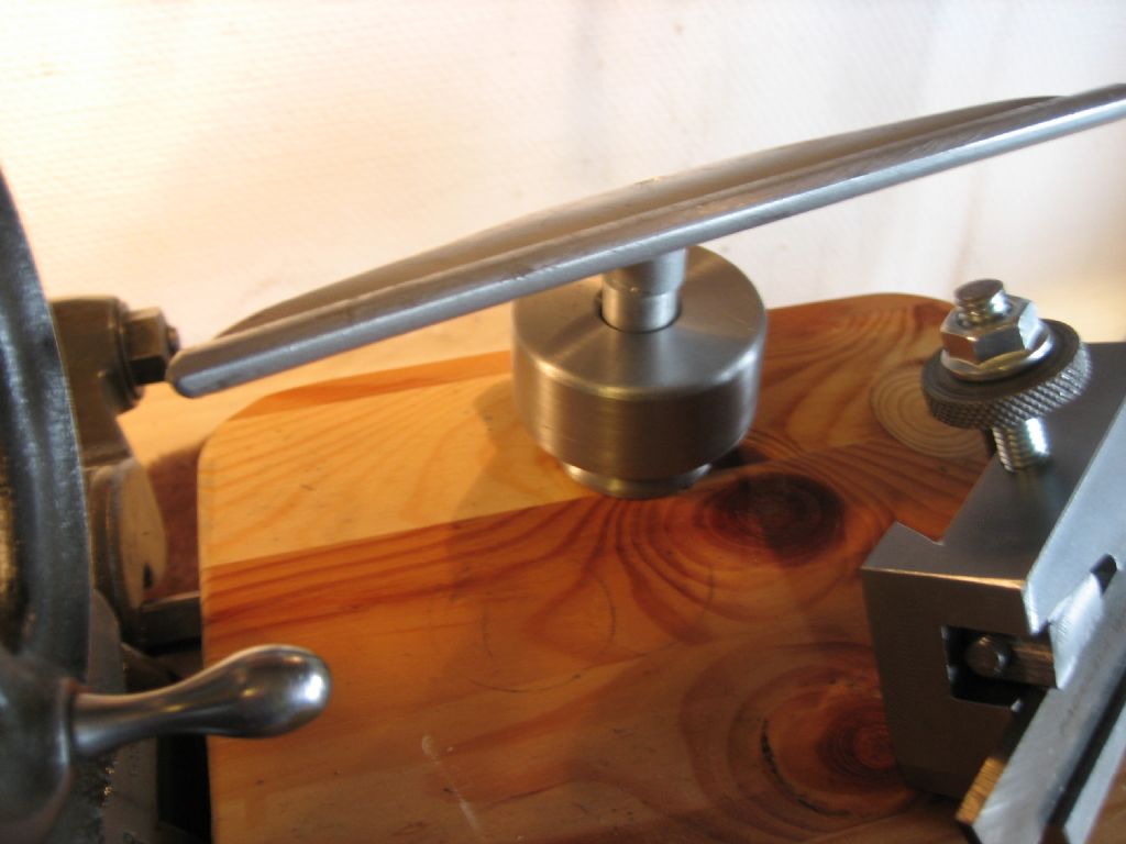

                                                Wood toolrest
                                                Don't know if your lathe has the old style south bend/boxford compound,
                                                If it does adapting a woodturning toolrest works a treat
