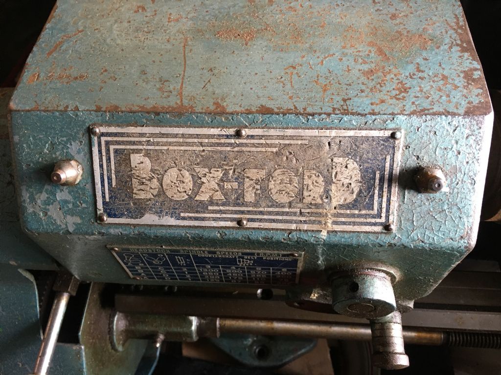

                                Grindstone Cowboy
                                  @grindstonecowboy
                                  There ya go! (Must get a replacement for that when I get round to it…)
                                  Box-Ford label

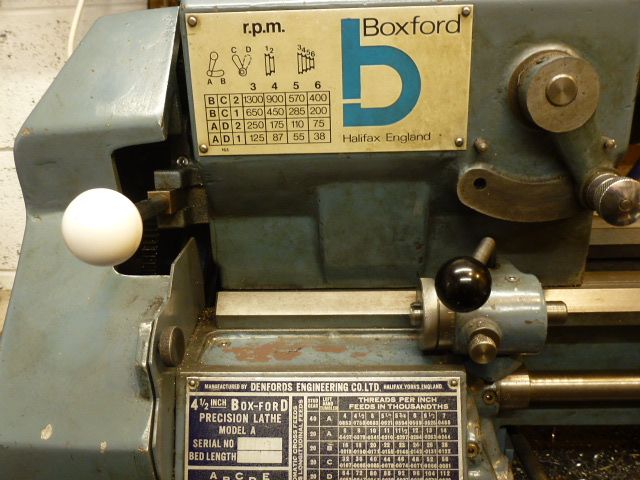

                                    Clive Brown 1
                                      @clivebrown1

                                                  Posted by Grindstone Cowboy on 31/03/2020 14:06:37:
                                                  Box-Ford label
                                                  Boxford stopped stocking that type of badge sometime in the 1980's, all they have is a smaller one like this
                                                  **LINK**
                                                  #461378
                                                  Grindstone Cowboy
                                                    @grindstonecowboy
                                                    Oh well, never mind – I did find these people who seem be able to make one. As an aside, any ideas what the original colour of this circa late 50's Model C would have been? I think it may have been a dark blue, but bits of the countershaft assembly are greenish-grey (underneath the blue Hammerite that the previous owner must have had a large tin or two of).
