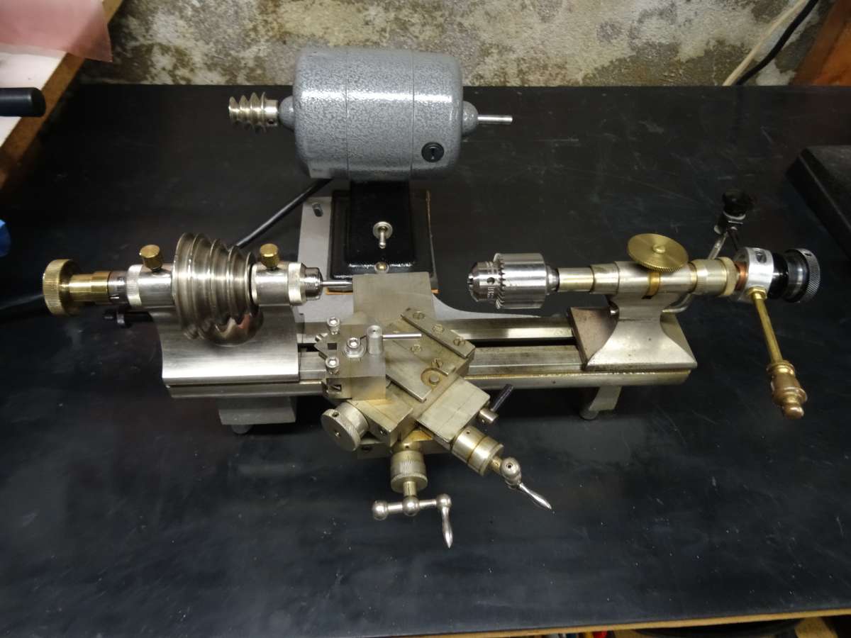

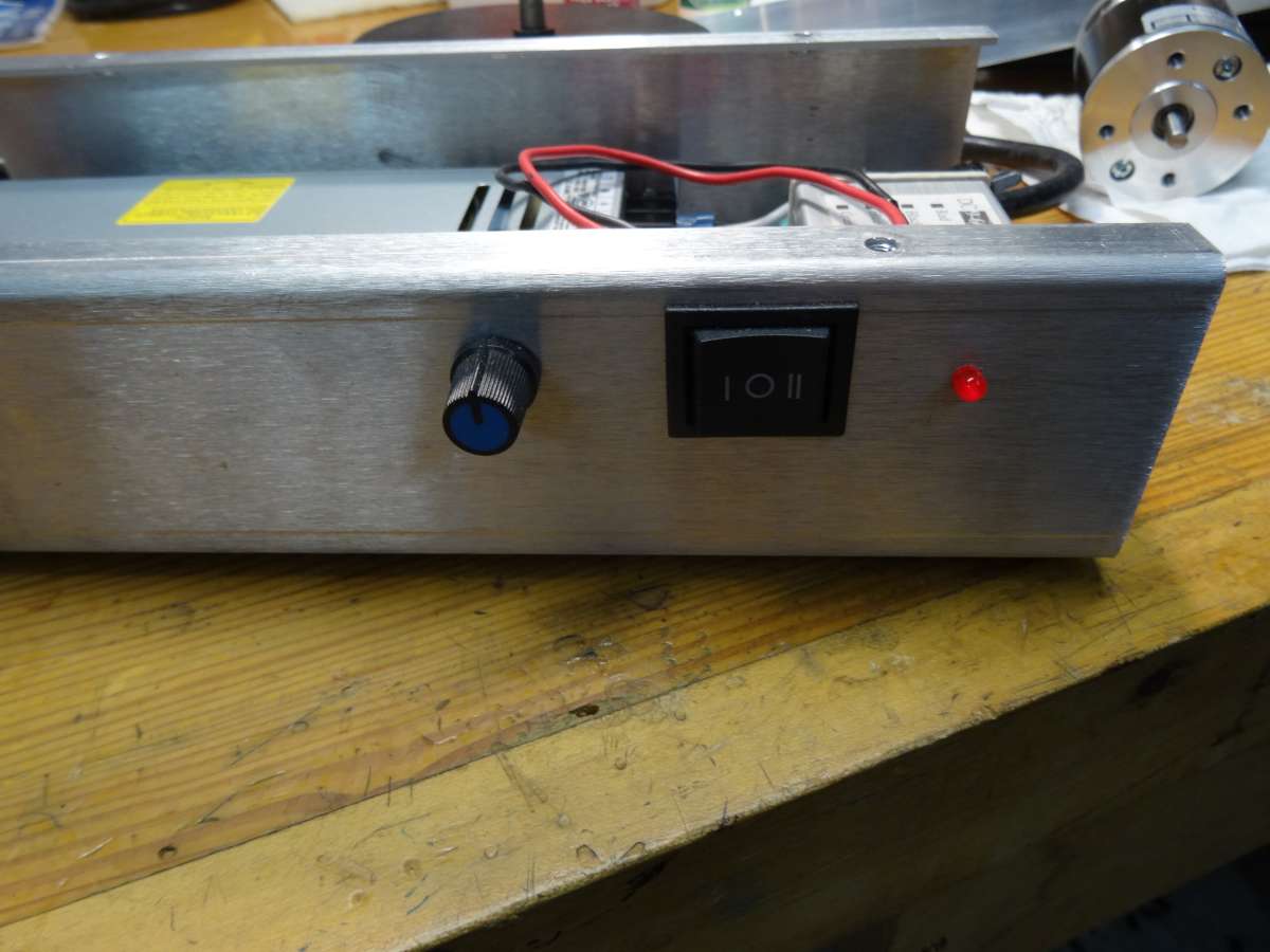

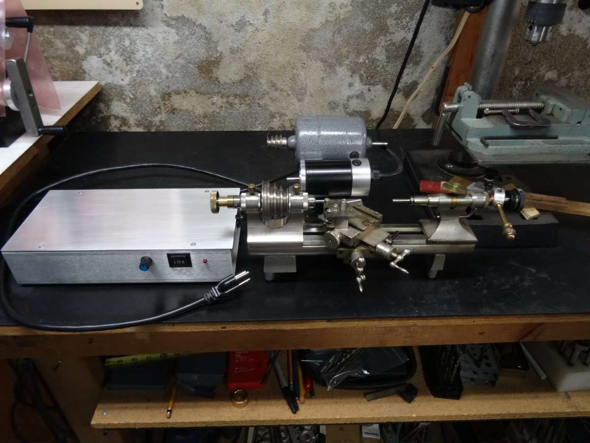

      I’m looking for some help in what would be the best setup for selling my Boley Leinen lathe. Right now it has an AC motor with a foot pedal, but I made a new setup with a brushed DC motor, and a power supply and speed controller in an aluminum enclosure. One photo shows the present setup. The other photos show the new equipment not yet setup with the lathe. The new motor is just leaning against the AC motor. What one would you guys prefer?

      bernard towers
        @bernardtowers37738
        Either as both looked brushed so speed control possible, I would go for the quietest.

        Peter Cook 6
          @petercook6
          Personally I would prefer the DC motor with speed control. I find holding a foot pedal at a constant position tiring on the ankles. It’s also harder to go back to the same speed when you stop for inspection/measuring.
          Both my watchmakers lathes have variable speed control (mine are AC), and both are wired with an on/off footswitch so that I set the speed with the knob and switch the lathe on and off at that speed with a footswitch.

              I should have mentioned that the AC motor max is about 1,500 RPMs and based on existing pulleys give a max of 1012 RPMs. The brushed DC motor max is 5,000 RPMs and based on the same pulleys gives a max of 3,375RPMs. So DC motor provides much more speed flexibility. And, in general, AC motor torque drops at low speeds and DC motor torque remains strong at all speeds.
              #837965
              Henry Rancourt
                @henryrancourt22682
                Just realized the flexibility that a 5000 RPM motor provides. For example, with a speed control knob and a belt running from one 1″ diameter pulley on the motor spindle to one 1″ diameter pulley on the lathe spindle, that would provide the capability to run from 0 RPMs to 5,000 RPMs. So, no need to move the belt to different pulleys, so no need move the headstock to align different pulleys, now that’s flexibility. The finishing touch would be a digital RPM display showing the lathe spindle speed.

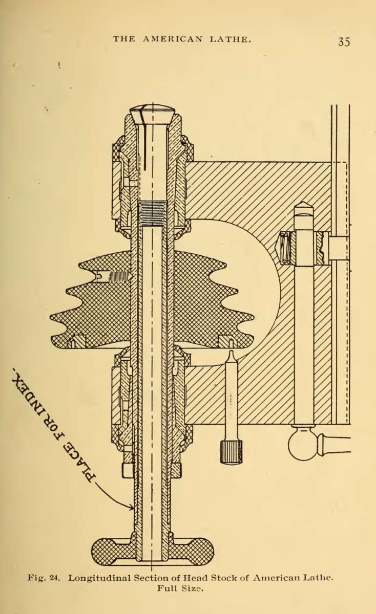

                          Link is to a white paper comparing ball bearing and FDB use in HDDs
                          https://documents.westerndigital.com/content/dam/doc-library/en_us/assets/public/western-digital/collateral/white-paper/fd-white-paper-final.pdf
                          IanP
                          #838124
                            If the plain bearings in Henry’s lathe are the classic “opposed double cones” in glass-hard steel AND are properly adjusted and adequately lubricated … they should tolerate being run at 5,000 rpm
                            But it’s a big IF

                                Double Cones

                                  My brushed DC motor is far from powerful. At 4350 RPMs it only outputs 96.5 Watts which equals about 0.129 HP or 1/7th horsepower.
                                  #838161
                                    Good show, Henry … that’s appropriate.
