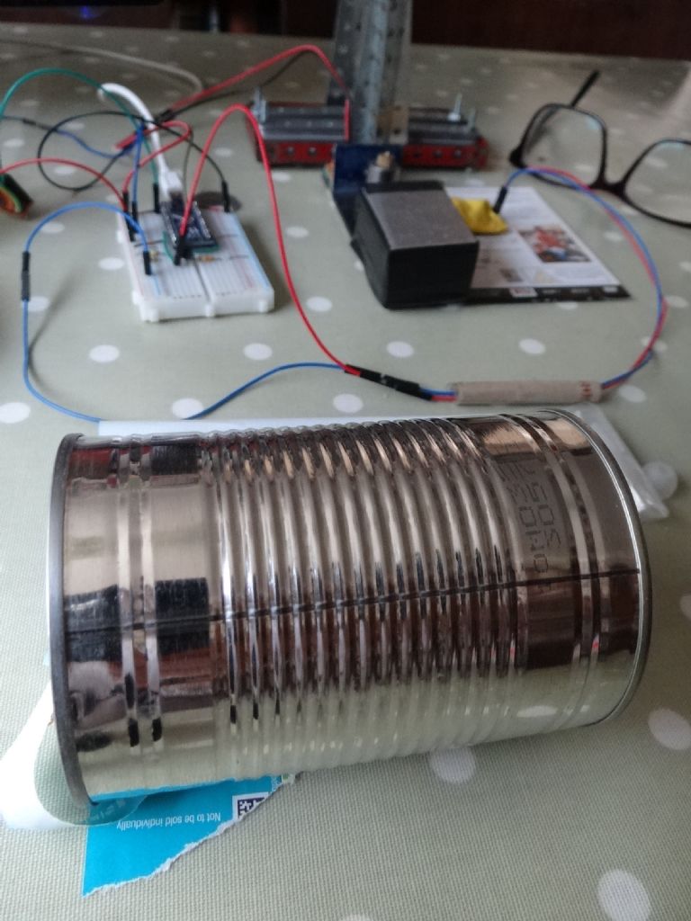

                    #360351
                      Posted by Rik Shaw on 02/07/2018 09:12:04:
                      I was chatting to a bloke at the boot yesterday and he told me he had used baked bean cans for his loco, he was quite serious!
                      Bean (ho ho) a long time since that was possible. For at least 30 years most tin cans have been corrugated:
                      Quite hard to find plain tin cans; last time I needed one I found only Condensed Milk and Fish Roe, though I expect there are others. Biscuit tins are more useful especially if your family snack between meals!
                      Not sure what the corrugations in tin cans are for: possibly it allows thinner steel to be used, or perhaps it makes them easier to crush for recycling. It's a mystery.
                      #360354
                      KWIL
                        @kwil
                        Corrugations make them stiffer, so they do not crush so easily with radial pressure.

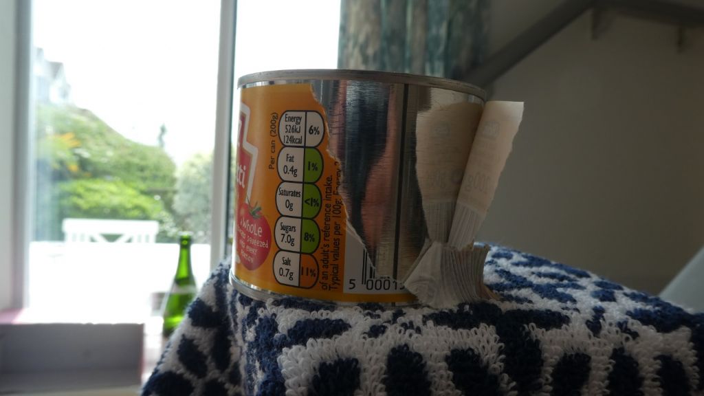

                        #360357
                        Rik Shaw
                          @rikshaw
                          As we left our holiday let earlier I took this pic of the last can of food left in our supplies box.
                          Rik
