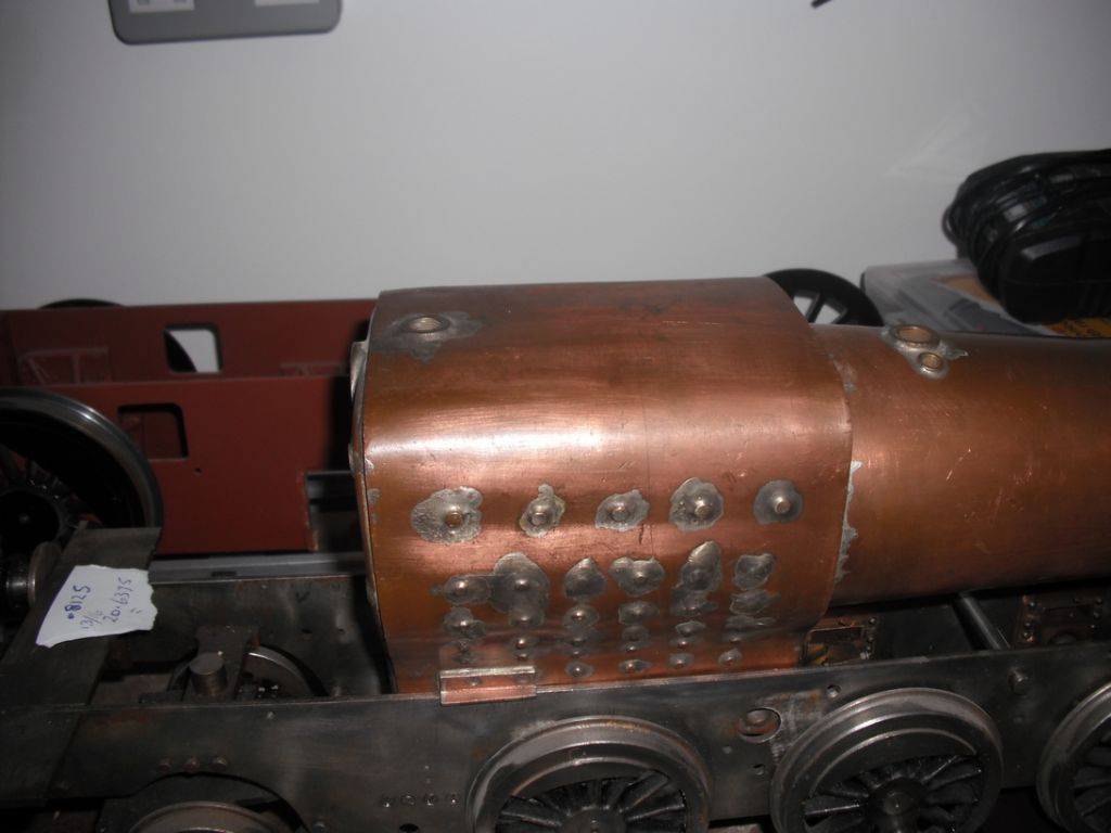

                      #182752
                      KWIL
                        @kwil
                        How have you stayed the firebox above the row I can see half way down the side in your single picture?
                        #182757
                        Ron Hancock
                          @ronhancock63652
                          #182758
                          Ron Hancock
                            @ronhancock63652
                            The stays where done to the top of firebox as per drawing thought i would add photo better than a thousand words
                            Ron
                            #182759
                              I think Kwil was asking what stays you have used across the top and down the sides to meet the ones in your photo above, something like this. Or are there girder stays that we can't see?
                              Edited By JasonB on 10/03/2015 15:47:00

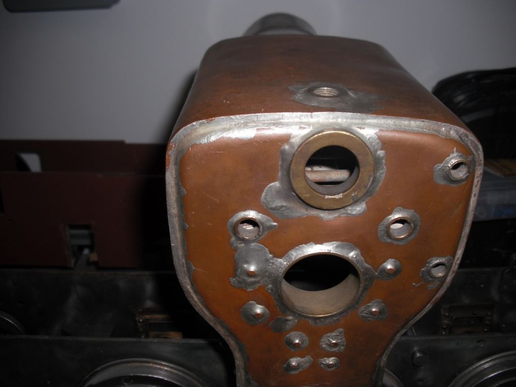

                                  I have cut the Barrel of witch i will Tig weld back on after i have sorted the pipes I have been asked about the top bridges they are welded from inside with the Tig to top of Firebox and top of Boiler.
                                  I am not sure where to go know i don't know if i should just weld the Back of the new pipes i have Fitted or to Remove the Back of firebox plate whilst i still can and make new Plate flanged and weld pipes in before welding new back of firebox or just silver solder Back of Firebox tubes.
                                  I really don't want any more problems so not sure which way to go welcome feedback
                                  Ron

                                  Bob Brown 1
                                    @bobbrown1
                                    Even with girder stays at the top of the fire box I would still expect to see stays across the two outer sections above the stays that are shown joining the outer and inner fire box sections. the pictures below show the boiler of my firefly which other than being 3.5" it does show the stays across the boiler above the fire box.
                                    #182788
                                    KWIL
                                      @kwil
                                      Without the cross staying shown in Bob's picture, you will for sure end up with bulging sides because of the extent of the area of unsupported material. Who's drawings were you working with?

                                      Ron Hancock
                                        @ronhancock63652
                                        I will put them in but still trying to sort out the other problems.
                                        I have centre punched where they go i I have the Bronze stay bars ready to weld in.
                                        I thought you meant the Top Stay's sorry still learning.
                                        I have just welded the tubes from the other side of fire box look dreadful in Photo but look like they are really in tight now more confident now.
                                        #182795
                                        Ron Hancock
                                          @ronhancock63652
                                          #182796
                                          Ron Hancock
                                            @ronhancock63652
                                            Hope this will seal now might have been ok but now i will be surprised if this does not seal now.
                                            Just going to fit a sleeve and Tig weld the Barrel back on then.
                                            Also fit front Smoke Box Plate and fit the Stays.
                                            Just hope and Pray its all ok after all this,
                                            #182797
                                              Ron is that silver solder you have used more liek a brazing rod to tig braze the tubes in. Also also looking at the tube in the foreground on the first of those three photos has teh copper melted as it looks like "runs" on teh surface of teh tube.
                                              Don't want to come over as being negative but would be a shame to seal it back up by welding the barrel back on and have problems later. I'd be tempted to get your boiler inspector to take a look at it now before covering things up.
                                              Edited By JasonB on 10/03/2015 20:00:17

                                                #182874
                                                Ron Hancock
                                                  @ronhancock63652
                                                  Hi i used silver solder but 40% ready fluxed rods yes the silver solder is on the outside of the Tube not gone through from inside.
                                                  I still thinking of making a new complete smoke box just worried about drilling all the stays out.
                                                  I am far from proud of this and very expensive mistakes but have to learn from them.
                                                  I would do it totally diff rent when i make my simplex Boiler just wish i had started that one first and not the Black 5.
                                                  Time to sit back before taking the Next step
