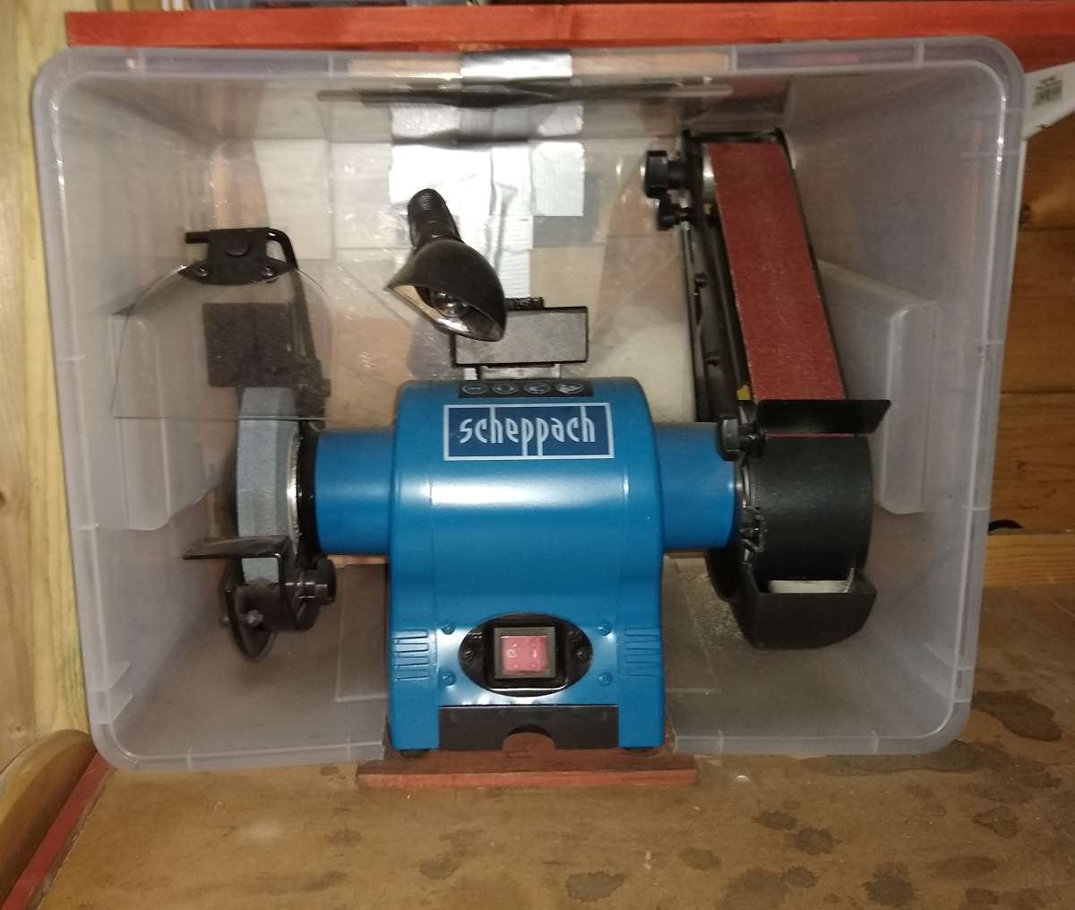

      I need to make a protective box for my bench grinder ,as it will be used in front of a window.
      I have in mind an open front box with a top hinged lid, which is raised when using the grionder, thus protecting the window from flying debris.
      I wondered if anyone has made anything along the same lines, before I proceed.
      Mike.

                      Ches Green UK
                        @chesgreenuk
                        Mike,
                        I use an Ikea plastic box, not so much as a ‘safety box’, more as a dust/grit collector box.
                        Dust still comes out the front but it is easy to collect with a dust pan/brush.
                        grinder box 3
                        The Ikea box was cut in half and a couple of inches removed to reduce the width. A portion was also removed at the bottom to fit the base of the grinder. Then it was duct taped together, with a wooden stiffener in the top rim to keep the box reasonably straight and stiff.  It has been in use for a few years now…no issues.
                        The box only has a few inches clearance at the back but can be easily tucked down and over the grinder into position.
                        Ches
