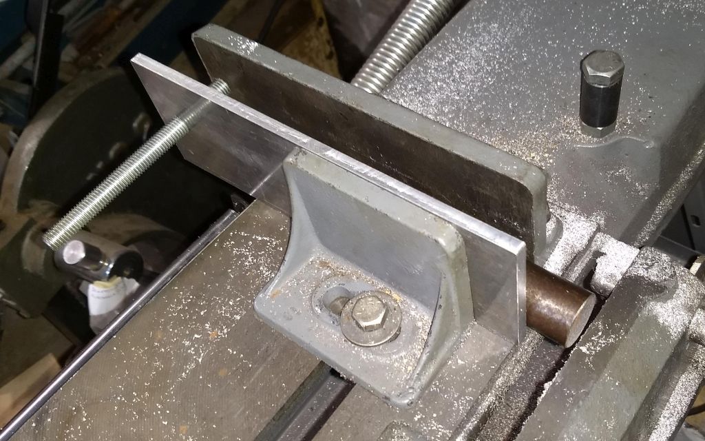

For holding short items, I made a clamp. Can't find the stupid thing for a photo, but it's just a flat plate about 10mm thick about as long as the width of the fixed jaw and 60mm wide, with a couple of studs to hold a bar that clamps down on the work. Crude, but quite useful.
