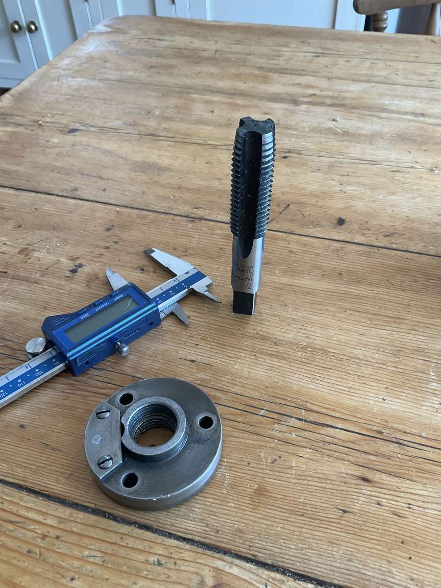

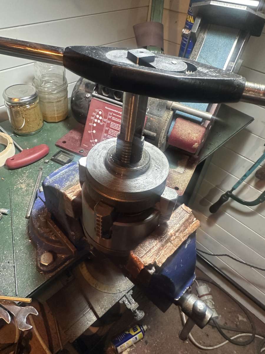

      My main 3-jaw chuck is too big for my little lathe. It actually came with the lathe, but without a backplate, so a while back I made a cast iron backplate for it. It was one of the first projects I did with the lathe, and it worked out pretty well. But the fact remains that the chuck is too big.
      So I’ve kept an eye out on eBay for a suitable, small, low profile chuck with the required 7/8” thread and recently one came up as 7/8” BSF, so I negotiated a cheap deal for it. I thought it likely that in fact it was BSW and the seller was wrong. However, it turns out that the seller was correct, so now I have a nice little chuck but with a 11 TPI rather than 9 TPI backplate.
      So I have a few options:
      1) run my 7/8” 9 TPI tap through it to “convert” it to BSW.
      2) buy a piece of (bright steel?) rod slightly larger than the exactly 2.5” that it currently is and proceed in the usual fashion to make a backplate. Existing backplate can be used as a template for the holes.
      3) CNC a new one
      Thoughts ?

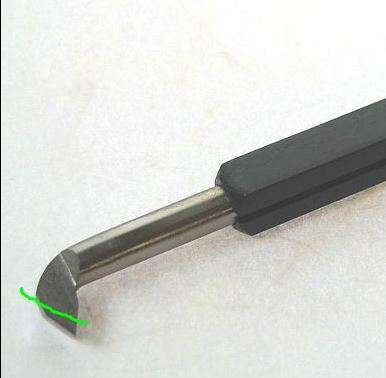

                                        So…. I have some cast iron on order for the new backplate, and I’m trying to find a suitable “proper” internal threading bar for the job. It needs to be as long and as small as possible to cut the 7/8” 9TPI thread. Not much room in there.
                                        I did have a homemade one but I have lost or repurposed it, so I should buy a commercial one.
                                        Chronos have a bunch of potentials…
                                        https://www.chronos.ltd.uk/product/imperial-55-soba-5-16-hss-threading-tool-holder/
                                        but they don’t seem to publish the key number, which is surely the distance from the tip of the threading tool to the opposite side of the bar.
                                        Any thoughts on a suitable threading tool?
                                        thanks
                                        Steve
                                        #813007
                                        bernard towers
                                          @bernardtowers37738
                                          there is live chat available if you scroll to the bottom of the page and ask the question.
                                          #813032
                                          cogdobbler
                                            @cogdobbler
                                            thanks
                                            Steve
                                            It says on the linked advert that it is 6″ long. So that would leave about 5″ sticking out from your 1″ or so deep backplate thread. More than enough.
                                            I am not a great fan of that type of boring/threading bar though, as the shank is a lot thinner (5/16″) than it needs to be, due to the large turnover on the cutting end. Can get a bit chattery.  I would look for something like a 13mm diameter shank with 55 degree carbide insert (preferably the ground  xxGT type). They are cheap enough these days if you shop around.
                                            Or a 3/8″ diameter boring bar with the square hole in the end to hold a piece of 1/8″ or 3/16″ HSS. You can grind your own toolbit with way less overhang than the linked-to type.
                                            #813050

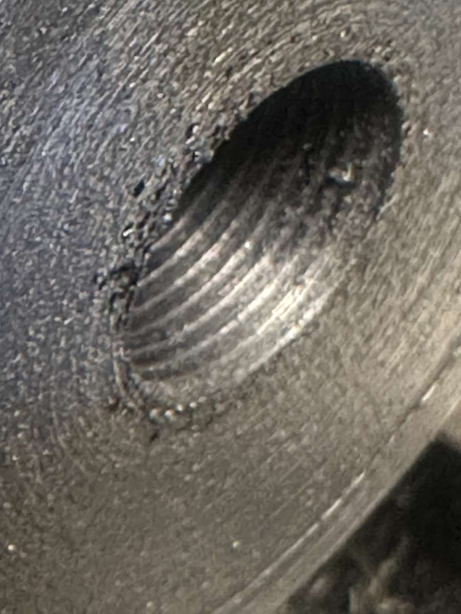

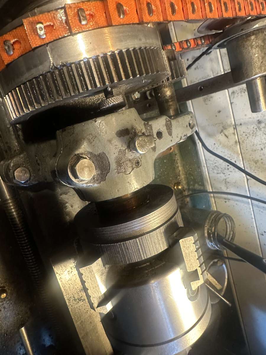

                                              Steve355
                                                @steve355

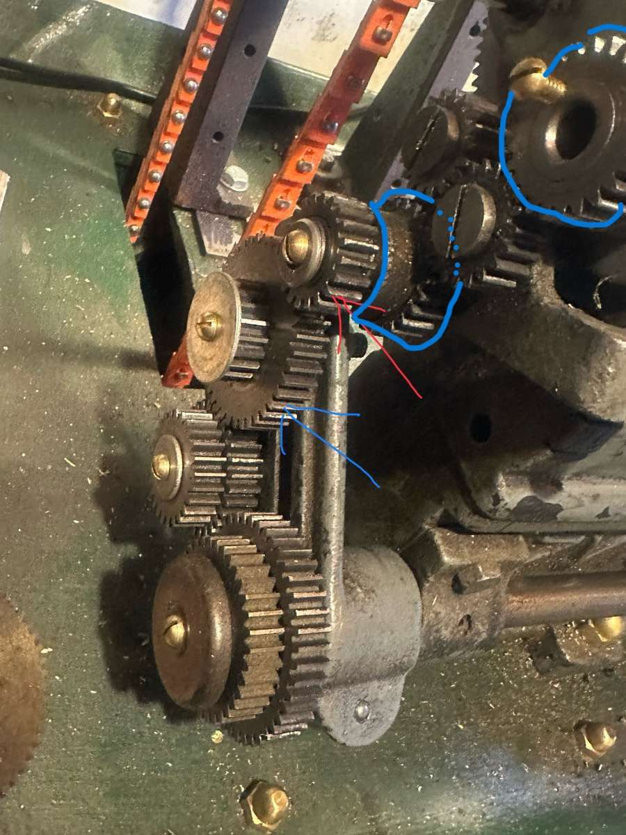

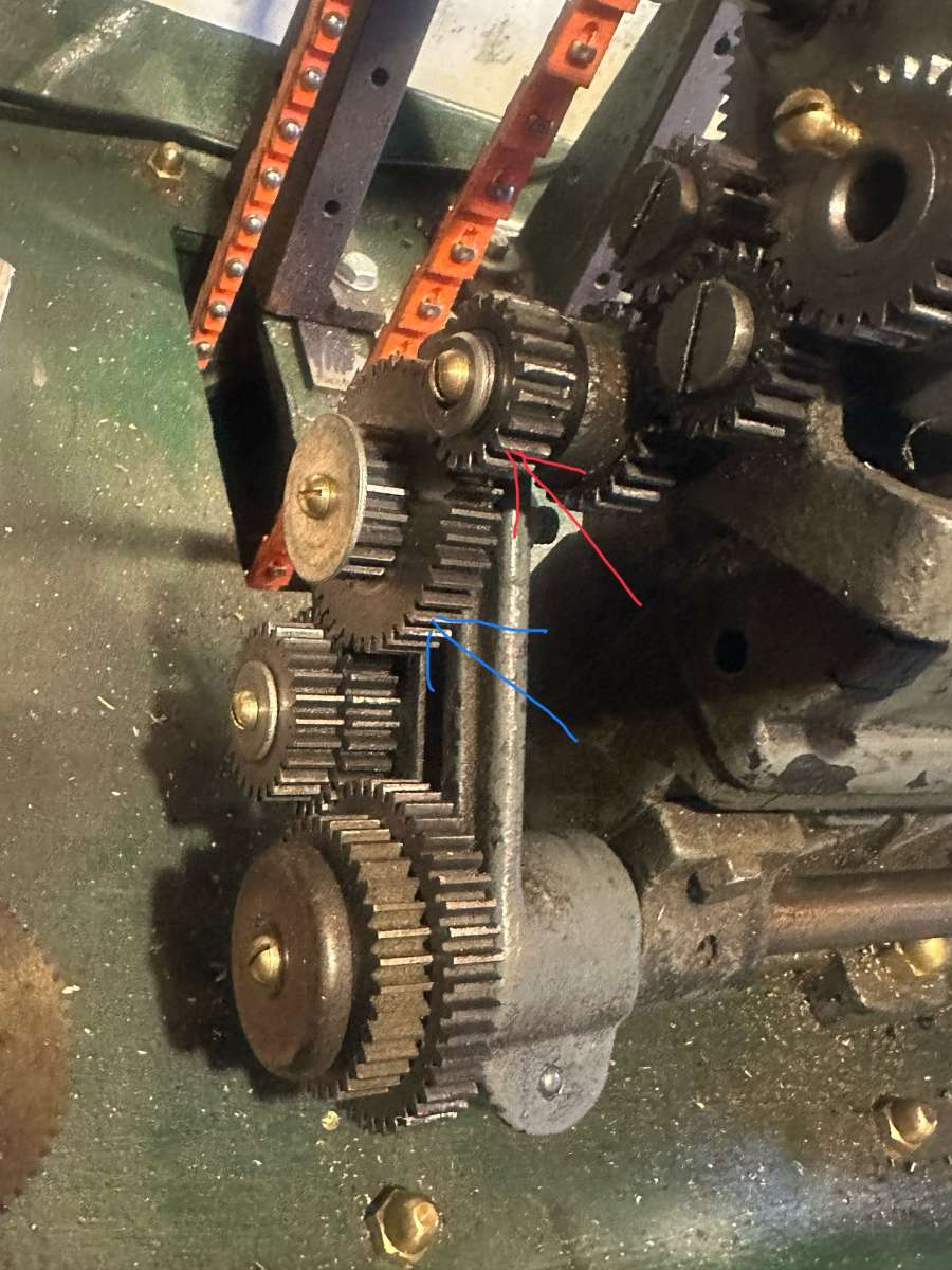

                                                Quick question on this now I’ve got around to doing it. On my scratch pass I’m getting more like 14TPI than the 9TPI I am expecting. It’s a long time since I used the change gears and I can’t remember everything…
                                                Scratch pass
                                                IMG_5634
                                                Here’s the TPI chart.
                                                IMG_5636
                                                I think I have the 40 tooth gear on blue when in fact I should have it on red, with any gear between that gear and the 45 tooth gear on the lead screw.
                                                Does that sound right?
                                                IMG_5635
                                                #815759
                                                Diogenes
                                                  @diogenes
                                                  Yes – put the blue one where the red one is, and then use any gear on any stud that will fill the gap between that and the leadscrew 45.
                                                  That said, do check that the two gears that I have outlined in blue DO actually have the same number of teeth.
                                                  Zyto gear
                                                  #815826
                                                  Steve355
                                                    @steve355
                                                    Thanks for that, I checked and both gears had equal teeth. All working nicely now. I took it perhaps 75% of the way using the threading bar and finished off with the tap, which was very easy.
                                                    Test fit seems great, I’ll put a DTI on it tomorrow and turn the chuck side.
