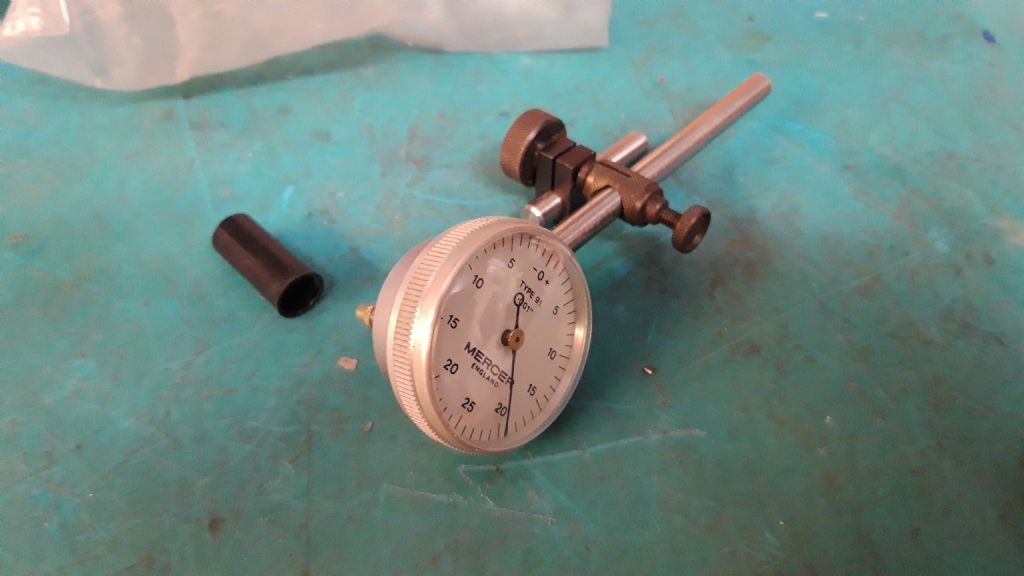

        I have just aquired a rather nice Starrett #650 'back plunger' type indicator. I've never used one of these before as I have always used the more conventional dial indicators and lever type dial test indicators. The back plunger type seem more common in America maybe.
        Any tips or comments on their use? Any advantages over the more usual types for general workshop indicating?

          Very occasionally, I use one.
          They can save a lot of craning of the neck in some situations.

            Can be handy for jobs like mill head tramming as the face is always in view.

                    I've got a nice Mercer which is only really used for tramming the mill tables, easy to see the dial face. Other than that particular job I can't see any advantage of using a back plunger dial gauge rather than the usual type or Verdict lever type.

                      Works well for tramming in a vise also. use one all the time.

                        I nearly bought one at Christmas (Amazon had some seriously silly price reductions of 75% or more) thinking the "see-saw" deep hole attachment looked handy but in the end went for a vertical dial DTI which, like the back plunger indicator, can also be read in any position on the mill. I have to say though, US made Starrett kit always looks and feels lovely, especially in the padded jewellery boxes.

                              Use mine for tramming the mill and shaper vises in.
                              Dial face is staring straight at me.

                                I use these all the time, never owned a lever-type. One is a Mercer in a fitted case with all the trimmings, and I have a couple of others from car-boot sales, permanently fitted to various bits of equipment.
