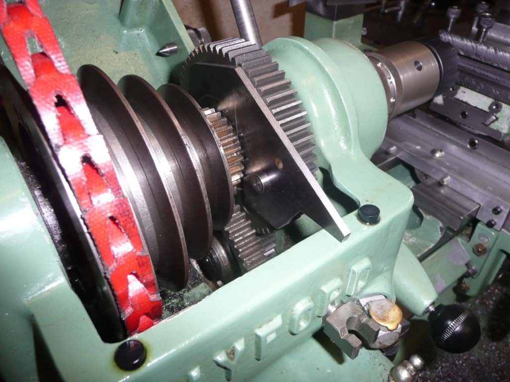

                I have had my share of stuck chucks on my Super Seven, but much less so since adopting the practice of a quick squirt of oil on the register and thread when changing chucks. These items should, of course, be kept scrupulously clean.
                I have also seen the suggestion that a chuck which has been used for heavy or intermittent cuts should not be left on the spindle overnight (the chuck should, perhaps, also be loosened at intervals during the job).
                Prevention apart, there are two requirements for removal: immobilising the spindle and safely applying releasing torque to the chuck. Lawrence Sparey has very good advice on these points in his little book "A Man and his Lathe", in particular his design for a spanner to lock the mandrel without risk of damage to the backgear. I could post a photo of my version of this if anyone is interested. His suggested way of rotating the chuck is via a bar gripped in the jaws.

                            Posted by ega on 10/12/2015 12:09:54:
                            Yes please I'd be interested in seeing a photograph of your spanner.

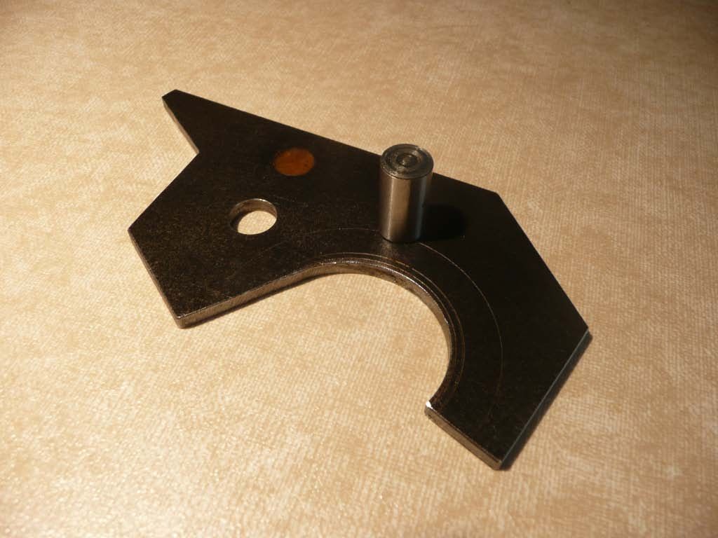

                              ega
                                @ega
                                Bill Wood 2:
                                Thank you for your interest. A couple of photos: the first shows the spanner installed on the S7 spindle, the second the device itself with the loose pin which engages in one of the holes in the bullwheel. When used in earnest, I interpose a bit of brass between the projection on the spanner and the lip of the headstock.
                                The spanner was just sawn and filed up from a scrap piece of 8 gauge MS, hence the redundant hole. The pin is a bit of HT material but MS would do.
                                I will send you a PM with more information.

                                                #216065
                                                Lambton
                                                  @lambton
                                                  Take great care when using any method of locking the bull wheel on a Myford Super 7 whilst using force to free a stuck chuck as there is only a small woodruff key (item H22 on the exploded diagram) that secures the spindle and bull wheel together. Keyways, especially in cast iron or heat treated steel are stress raisers and excessive force or shock loading could easily cause serious damage.
                                                  Take precautions to prevent the chuck getting stuck e.g. lubricate the spindle end with anti seize compound and never "spin" the chuck onto the spindle at speed or with any undue force.
                                                  #216072
                                                  ega
                                                    @ega
                                                    Lambton:
                                                    Good point – although my understanding (and reading of the diagram in the S7 manual) is that it is the bullwheel that is keyed to the spindle by the woodruff key (H22); the pulley is connected to the bullwheel by the backgear key (H5).
                                                    So, ideally should we be looking for a method that doesn't involve the pulley, the bullwheel or the backgear? Perhaps by gripping the spindle tail in some way?
