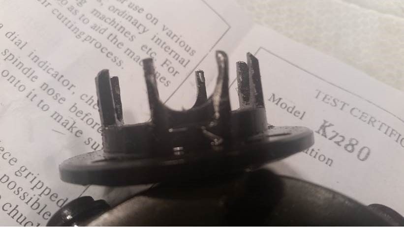

      During period of 1 August 2015 to 16 May 2016, out of a new batch, ARC sold a total of 23 chucks to end users with the following specifications:
      ARC Product Code: 040-040-00500
      Description: 4 Jaw Independent Cast Iron Lathe Chucks – Chinese Origin.
      Shortly after the sales from the new batch started, we received one complaint about a chuck which was belling. Simple drawing of 'belling' below:

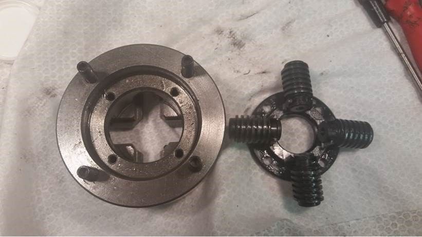

      We received it back, checked, agreed and refunded. Between the period of 3 May 2016 to 17 May 2016, we received three similar complaints in a row, so we suspended sales of this product pending investigation., which were completed today.
      Findings in agreement with one of the complainants was that tightening of a jaw resulted in bending of of 'the forks' which retained the jaw and 'worm screw' in place. An example/extreme case after use is shown below, after dismantling:
      This is a safety concern, and we will be contacting those 23 customers to request them to stop using this specific chuck. The reason we are making this public announcement is we are uncertain about how long it will take us to reach the 23 concerned. So, if anyone of them is reading this, and If you belive that you are one of the 23 who may have purchased this chuck from us and who may be effected, please do not use this chuck, get in touch with Ian or Ketan at ARC, so that we can also check and cross you off our list, as well as arrange a refund.
