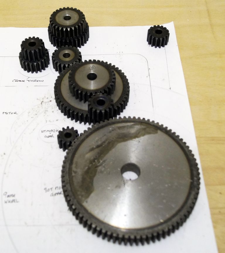

                  @ronladen17547
                  Phil,
                  I have gone with a set of Chinese gears (picture below) for my electric engine, its my own design but a lot of it is loosely based on the Minnie. Scale is 1.625 and the gears I have gone with are 1.5 MOD.
                  The good points with the gears are price, the set cost 1/3rd the cost of the best UK prices I could find. They are well made and machined true and mesh together nicely.
                  The couple of not so good points are that they are quite thick at 15mm so the 6mm and 8mm width I need does mean quite a bit of machining. Also the dark ring you see around the teeth is from the hardening process which is on all of the gears and it really is hard, HSS doesnt like it at all so it does mean insert tooling then its not so bad. I have no idea if all Chinese gears are hardened this way so it was a bit of a surprise when they arrived.
                  For me the main reason for going Chinese was the cost, it was way cheaper than I could find anywhere else.
