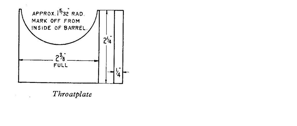

          As far as I can see the throatplate needs flanging on the sides backwards into the firebox and forwards into the barrel. This makes for an interesting shape to the copper where the backwards flange meets up with the forwards flange. Must be possible, I imagine all loco type boilers have this double bend at this point, but can't find a photo of one in my limited collection of books.
          Not necessarily. This is the drawing of LBSC's Tich loco throatplate, although admittedly some boiler designs do have the 'forwards and backwards' flanges you describe.

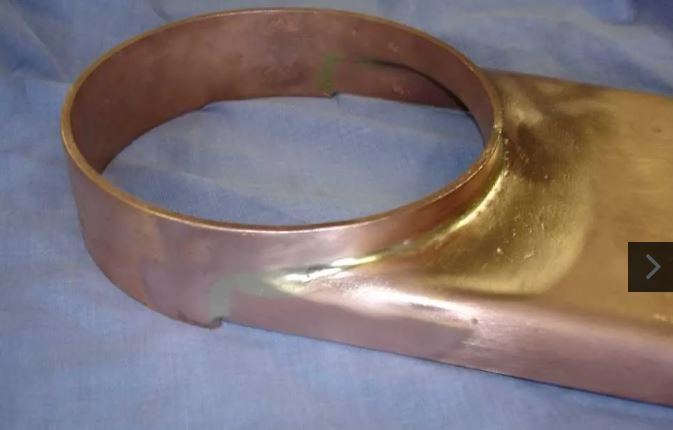

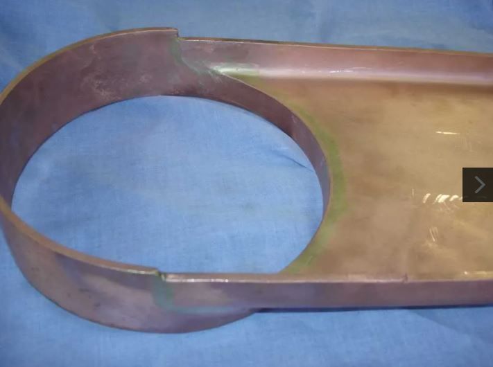

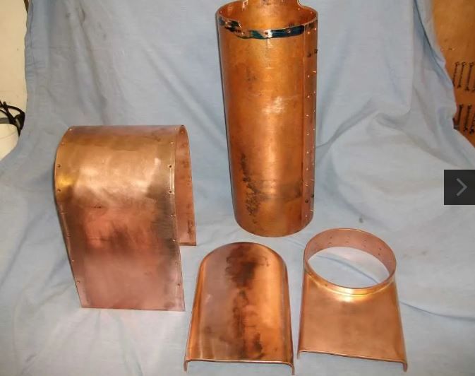

                      No confusing here.
                      Th throatplate and ring can be made up as one and brazed so no problem with the higher temps affecting anything else so Brazing is OK , much like this one for a Fowler
                      You can then pop a couple of loose rivits or bronze screws in to the ring to hold it to the barrel while the joint is silver soldered, ditto the wrapper. The lower half of the barrel will need some tidy fitting to get a minimal gap where it joins the throatplate.
                      Which should allow for a good solder joint
                      Nothing wrong with changes to construction provided boiler inspector is happy with them though having seen the copper strip after I posted about brazing I can't see any need to deviate from the strip method.
