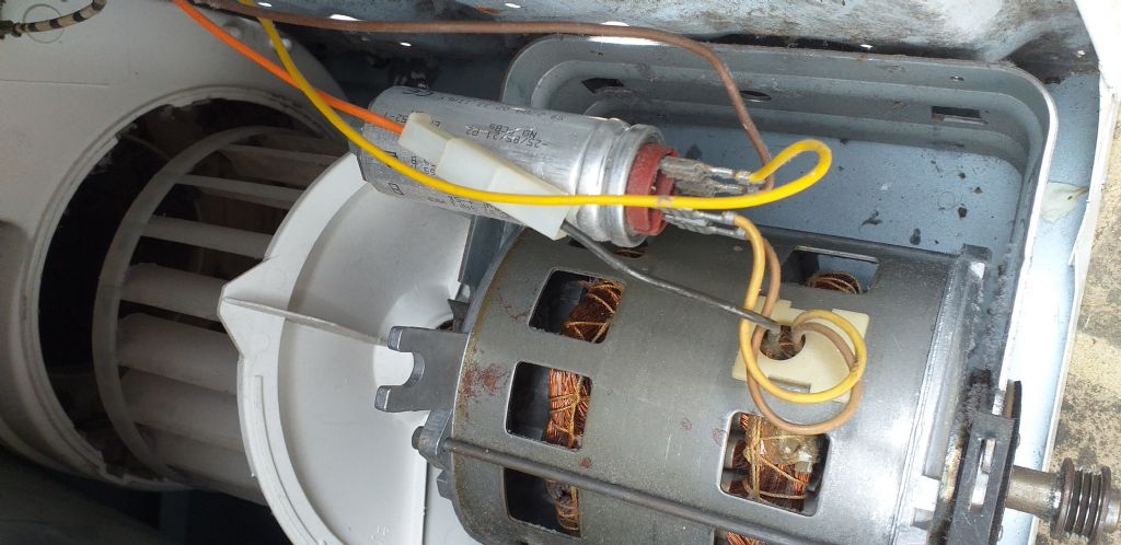

        I was thinking of using my old tumble dryer motor for a gadget builder style four facet drill grinder. Only thing is I am not sure how it is wired. I have included a photo because it has three wires going into it and two of those go via a capacitor. The capacitor has four terminals which I think might be because it is a start capacitor for a motor that runs both ways. My question is does anyone know what the connections would be if i just wanted to run this motor one way for grinding. Does anyone know what rpm this motor might be when run on UK mains single phase. I have seen before that some of you can tell the speed of some motors just by looking and knowing the frequency of the mains.

          The motor will run at 2850 rpm. But without the information on the capacitor its difficult to say whether it is simply an interference suppressor or a start capacitor. The way that its wired it could be either.

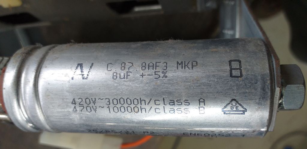

              John thanks for the info I have just taken a photo of the capacitor.

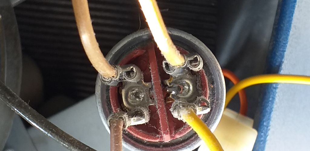

                Are you sure that the cap has 4 terminals? not 2 terminals with 2 conections on each terminal?

                  Quick google on the cap confirms it's a start capacitor. Also I think that it has 4 terminals but in 2 commoned pairs. Did the machine reverse in operation? Nothing to say that this is a 2850 rpm motor – could be 2 or 4 pole, if the latter it would be 1425.

                    The capacitor has 2 terminals with 2 wires on each terminal.

                      Thanks for the picture ! Yes its a start cap, and yes the motor will run either way.
                      Your earlier picture made it difficult to see that there were only two connections.
                      Effectively the black wire is mains neutral. The live goes to one side or the other of the capacitor depending upon which way you want it to spin.
                      If you do a resistance check between the black and yellow wires it should be the same resistance black to either yellow wire.

                                      The capacitor is, strictly speaking, a run capacitor, in that it is permanently in circuit. The motor almost certainly has two identical windings arranged with one end of each connected together, and brought out as one lead, typically the black one. The other end of each winding is brought out as a lead, and the capacitor is connected across these leads. The identical windings allow the motor to be reversed at will. As has already been said, one wire carrying mains (eg live) is connected to one or other end of the cap, depending on the desired direction of rotation, typically by a change-over switch. The other mains wire (eg neutral) is connected to the winding's common point (the black lead).
                                      You can check this by measuring the resistance between each coloured wire and the black one, and between the two coloured wires (disconnect the cap). I'm assuming the black lead is connected to the two windings' common point. The latter resistance should be twice the former, and the two former resistances should be identical. If that's not the case, it's a single-direction motor, and is wired a little differently – mains across lower-resistance winding (coloured to black), cap across other two coloured wires.
