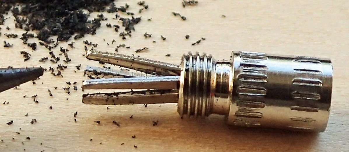

                I still have my old Faber Castell clutch pencil sharpener, Rotring pens, compass set and set squares. The pencils are hiding somewhere. Sharpeners are still available.
                Sharpener

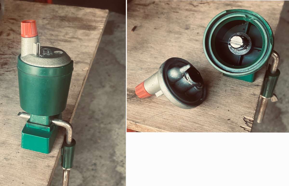

                    The pencil sharpener looks like this. I have no idea how to make one. I think there are 2 parts press fitted into the top button. But how to make such a deep V shape cut?
                    koh-i-noor-sharpener2

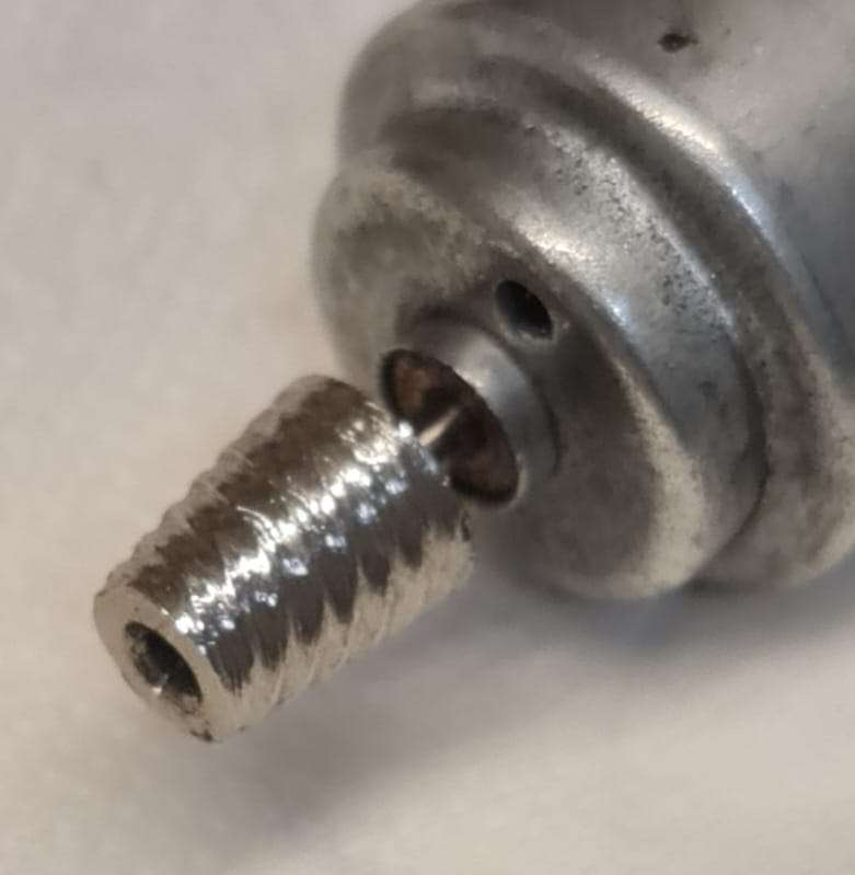

                                          Today I tried to make a grinding wheel to better understand what power is required. So I made this thing from stainless steel. I used a giant file to make the taper because the Sieg C0 doesn’t have a compound slide. The lathe is also misaligned and the tailstock is not adjustable. I was making a circle with the drilling bit! I start to dislike more and more this lathe.
                                          WhatsApp Image 2025-12-07 at 20.48.56
                                          The file was so rough that it magically created a helical pattern. Not bad. Could be sharper but since it came for free… I tested it in this way
                                          I discover that a motor of this size is struggling. It could be also because of the non ideal grinding pattern. I’ll try to make some axial groves with Dremel. Dividing head seems overkill for this job.

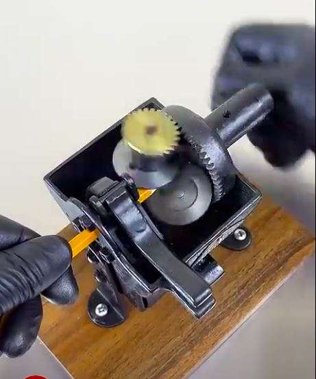

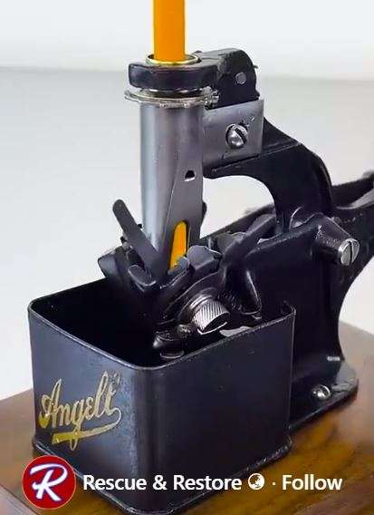

                                                    I just came across this video of an original machine for sharpening pencils.
                                                    Pencil sharpener 2
                                                    https://www.facebook.com/reel/868754285910298
