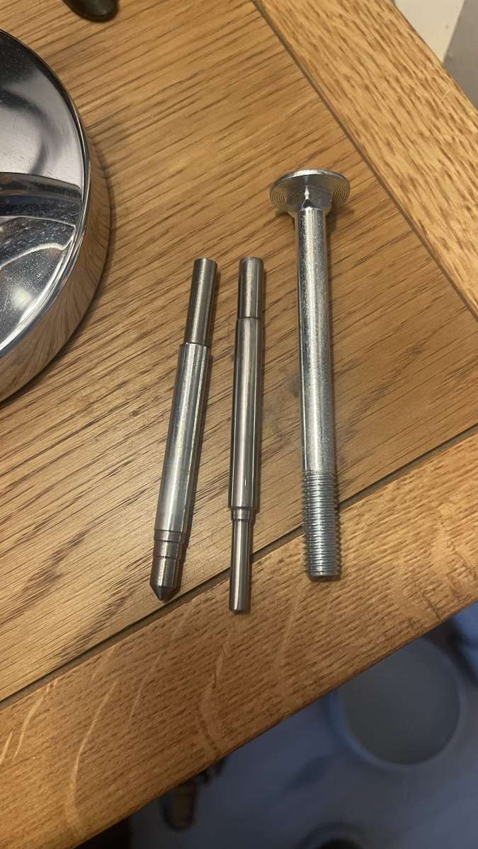

                    #751678
                    gareth689
                      @gareth689
                      On bernard towers Said:
                      Gareth, stay away from unknown bolts some can be horrible to machine, try and find some EN1A steel or Cz121 brass and possibly 6082 t6 alu to practice on.
                      It wasn’t as easy as I expected.  Second attempt was a bit better with smaller cuts.
                      i made what are probably completely useless punches from the bolts but I’ll have to try them one day to see if they stand up to anything…very much doubt it.
                      IMG_9508
                      My end goal is I now want to make a coffee tamper from stainless.
                      I’ve ordered a load of offcuts of various stuff on eBay to practice with.
                      #751715
                      noel shelley
                        @noelshelley55608
                        Is that material stainless or is it the picture ? Noel
                        #751720
                        gareth689
                          @gareth689
                          <p style=”text-align: left;”>I have no idea what it is, it started as the bolts on the right.</p>
                          #751984
                          noel shelley
                            @noelshelley55608
                            Hey Gareth, try a magnet on it. If strongly magnetic then steel but it doesn’t look like BZP or hot dipped. Slightly magnetic SS 304, little or no magnetism SS 316. These numbers are only a guide. Put some of the swarf in a cup of water does it rust overnight ? Just curious. Noel.
                            #752002
                            gareth689
                              @gareth689
                              It is magnetic.  Just looked at the Screwfix description from when I bought them and it states carbon steel?  Not sure if that helps.  I’ll see if it rusts.
                              #752009
                                Keep Bernard’s warning in mind!   Beginners often start by assuming that their lathe must be able to cut whatever metal is put into it.   I fell headlong into this trap by picking up a random collection of scrap to practice on before buying a mini-lathe, and it took me several months to twig that my metal was all unsuitable, and I wasn’t the incompetent owner of an inferior lathe.
                                Many manufacturing processes do not require alloys to be machineable, and even if the one used was, the finished product is often hardened.   Scrap can be very nasty indeed, either from the get go or as a surprise in the middle of a job.  About half the Stainless Steel family work-harden, so if at any point the tool rubs instead of cutting, the job suddenly becomes very difficult.    Other metals are too soft, won’t produce a good finish, tear, or otherwise misbehave.   Bernard mentions EN1A steel, CZ121 brass and 6082 Aluminium all of which are specifically made to be machineable.  Look for words like ‘Free Cutting’ in the spec.
                                When things don’t go well the most likely cause will be either the tools, the operator, or the material.  I recommend learners start with known metal because trying to machine unknown scrap is an avoidable source of trouble.   Don’t dismiss scrap forever though!  With experience comes the ability to recognise and adapt to less suitable metals.  Rarely impossible to machine them, but they need more skill and may not be suitable for the job for other reasons.   Nuts and bolts aren’t beginner friendly for practice because what they’re made of varies enormously.
