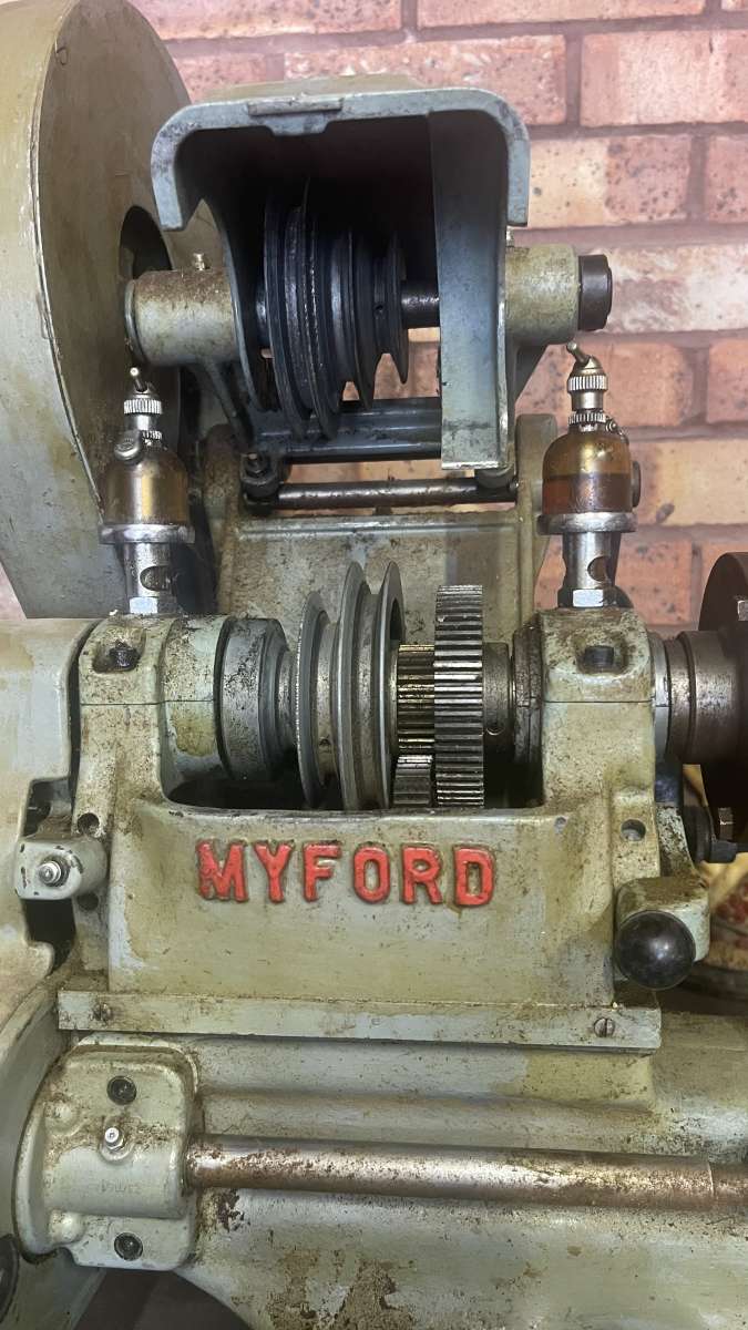

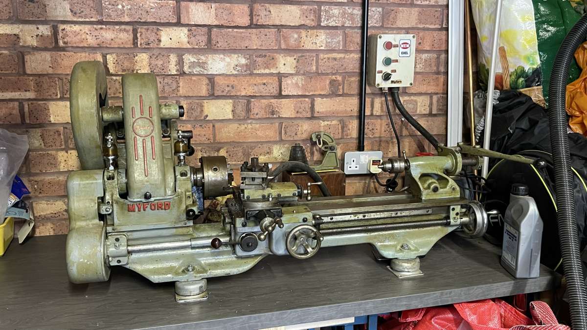

      Hi all, just picked up what I think is a Myford ML7.  Never used a lathe before but it was £200 so just had to.
      it does however need a belt to go on this part?  I don’t even know what to search to find it, as I’m clueless.
      Could anyone tell me what belt I need for this?
      Thank you ☺️
      IMG_9479IMG_9475

        Not a Myford owner but probably an “A” section belt.  Wrap a piece of string around 2 opposing pulleys cut at the overlap and measure the result. That should give you the belt length
        #750406
        Diogenes
          @diogenes
          It’s an A23, as discussed towards the bottom of this recent thread
          https://www.model-engineer.co.uk/forums/topic/myford-countershaft-and-belt-help/#post-749144
          – do read Hopper’s comments about shims etc. which will be encountered when removing and replacing the spindle!

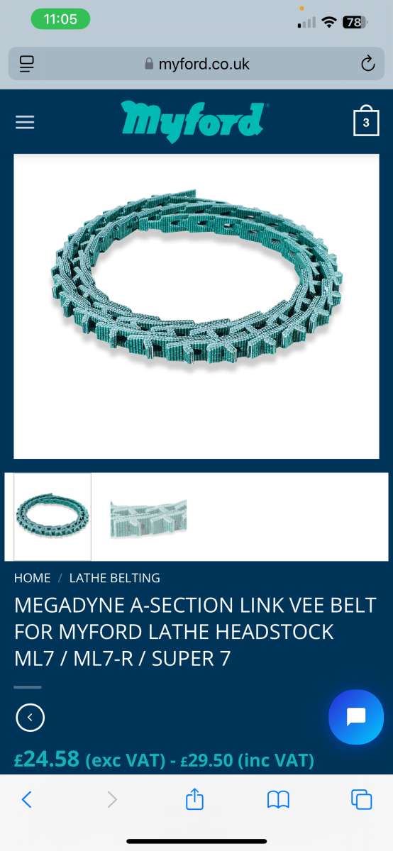

            If you are not used ot working on this type of machine I strongly suggest you do not disturb the spindle but use a link belt instead of a conventional type. Example from “new” Myford:
            https://www.myford.co.uk/product/megadyne-a-section-link-vee-belt-for-myford-lathe-headstock-ml7-ml7-r-super-7/
            Other suppliers out there.
            You can fit this with just hand tools and no disassembly.
            You got a bargin for £200 enjoy!
            Robert.

              Mark Rand
                @markrand96270
                It’s an ML7, not an S7.
                Take the bearing caps off.
                Lift the mandrel out.
                Move the counte rshaft over to one side after loosening the thrust collar and pulley.
                Then fit an new A23 belt.
                Far better than the link belts (which don’t fit between the pulley and the counter shaft bracket on early ML7’s).

                    On a ML7 the belt is an A23 and a link belt has NO benefit. I would not use link belt, it is for lazy ——-s may well slip and cause vibration. Just do the job properly ! Noel.

                                  <p style=”text-align: left;”>That makes sense.  In that case I will try the link belt.  Nothing to lose really.  I have some mechanical experience and have stripped and rebuilt many engines but completely new to lathes and not sure I can be bothered taking it all apart, especially as I’ve checked it with a dial indicator and there doesn’t appear to be much wear in it.</p>
                                  Would this be the correct one?
                                  or are there any others that you would recommend?  I read about Fenner but can’t find in stock and is significantly more costly in most places.

                                        I’ve ordered the link belt from myford.  Than you for the advice.  Maybe one day I’ll be confident enough to put the correct belt on it.
                                        I will no doubt be back for more advice when it gets delivered.

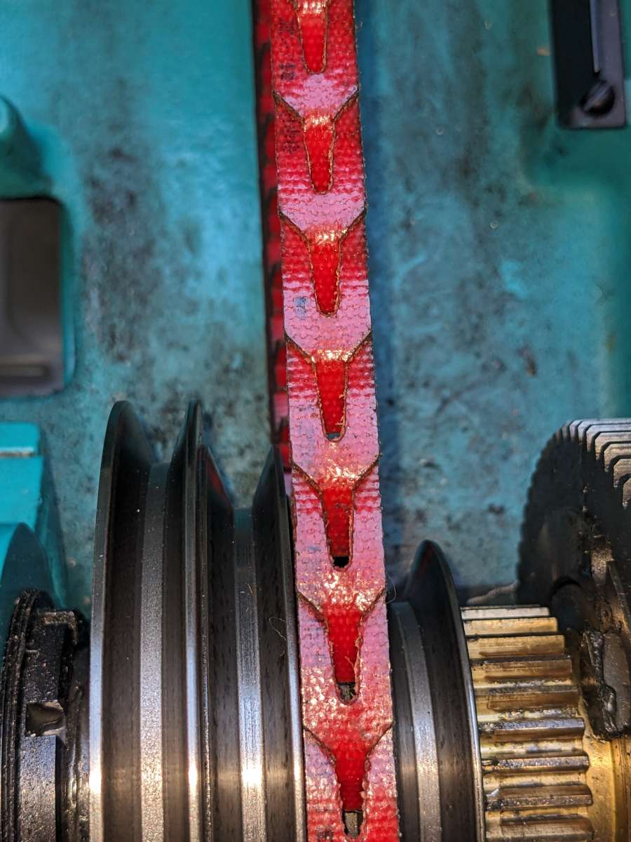

                                          On John Haine Said:
                                          Link belts are fine if you use the right one and fit it the right way round.
                                          What way is the right way round? My S7 could do with a new belt and I cannot be bothered to pull the spindle out so fancy using a link belt. Could someone post a pic of which way round the belt goes please.
                                          #750526
                                          John Haine
                                            @johnhaine32865
                                            PXL_20240901_163632773
                                            #750528
                                            John Haine
                                              @johnhaine32865
                                              this on a Super 7
                                              #750535
                                              Baz
                                                @baz89810
                                                Many thanks John, a picture is worth a thousand words!

                                                  noel shelley
                                                    @noelshelley55608
                                                    is the belt in John Haines picture fitted the right way round ? Noel
                                                    #751084
                                                    peak4
                                                      @peak4
                                                      I didn’t want to be the first one to mention that 🙂
                                                      If one is familiar with NuTlink belts, it might be easy way mislead yourself, as I did originally when I bought one of the original RDG plastic ones.
                                                      The NeoLink ones, apparently run either way.
                                                      Bill
