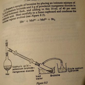

                                #450955
                                  The flasks should probably be ground glass stoppered rather than rubber or cork.
                                  Potassium Bromide and Manganese Dioxide are both readily available. Strong Sulphuric Acid is controlled, but 40% is roughly the strength used in Car Batteries.
                                  Note warnings in other posts about toxicity and my photo instructions mention of a Fume Cupboard. Nasty stuff – under no circumstances get any in your lungs or eyes.
