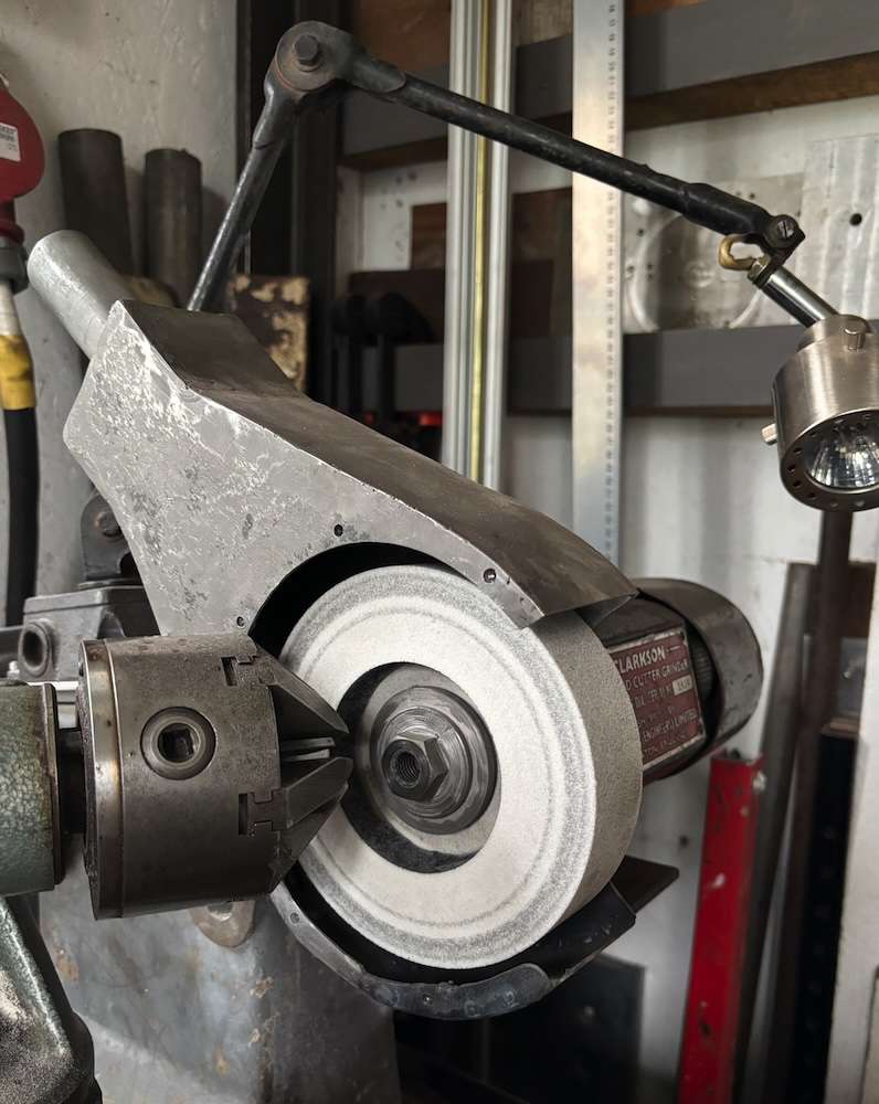

          Teaching grandma to suck eggs comment. Generally Clarkson wheel guards vary from hopeless to inadequate so please don’t spin up any wheel you don’t know to be good. I automatically bought new for mine.
          If you fancy something better I have “OK (ish)” drawings for a near copy of the latest full guard set up with dust extraction tube welded up from steel sheet. Drawn up from photographs of the real thing. They are what I made mine from but I never went round and properly corrected discrepancies found in the build or desirable modifications. No great issues if I recall correctly but a few “Hmm, maybe I wouldn’t do it exactly like that next time. Intent was write up in MEW but it all seemed too much work to produce a properly validated design.

              This is the guard. Lesson 2 of Teach Yourself MIG Welding so sticking together isn’t pretty. But it works. I leave the outer cover off for drill sharpening. Wheel is Axminster Grinding Wheel Code 400074 (Wide Wheel for AC150WSG Grinder). Inexpensive at the time, about 7 or 8 years ago so may no longer be current, and works well for drill sharpening although it needed dressing down a bit on the fron face to get inside the guard. It will be dressed before it gets used again. Marks photograph much more impressive than they are.

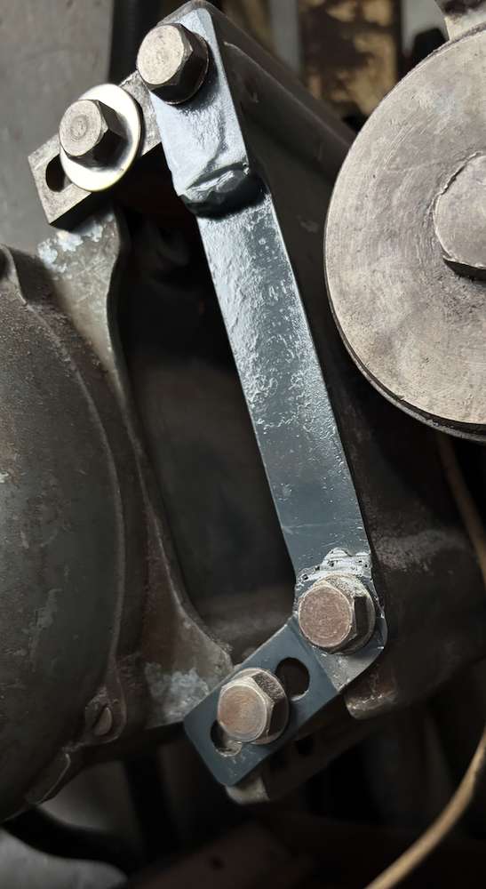

              Whilst I was at it I modified the never-to-be sufficiently-cursed motor mounting system whose four independent brackets seem to have been designed to make it near impossible to simultaneously get both belt tension and alignment correct. I welded a copy of the brackets at a suitable angle to the bottom ends of a pair of bars running between the tapped holes in the motor mount. Now only the top brackets pivot so its all much better behaved.
              6) Motor Mount R

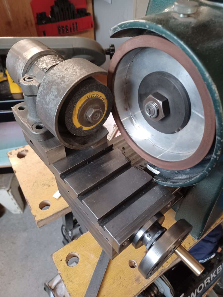

                    If you want to grind carbide cutters you will have to use a diamond wheel and that needs a diamond wheel dresser attachment.
                    20250220_154229
                    It uses a grinding wheel which makes contact with the wheel and rotates on contact but with a centrifugal brake trues and dresses the wheel.
                    David

                      What is the advantage of that style of diamond wheel truing attachment over simply accurately mounting one of the usual type for properly controlled traverse at exactly 90° to the diamond wheel axis? Which would be fundamentally using same method as you do for ordinary wheels.
                      How is the grinding wheel on the attachment properly trued and dressed before use?
                      Looking on t’net those devices are impressively expensive for something that seems so simple a concept. Over £1000 for a Norton one and approaching £300 for the MSC “cheap far eastern knock off” version. Yikes! Interestingly MSC are probably cheaper than direct from China via Alibaba once the delivery and duty stuff is done and dusted.
                      Seems a valid DIY project if a simple drag brake will do rather than the centrifugal device used by Norton.
