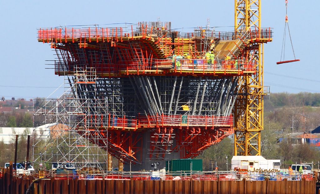

                                    My worktops came from a reclamation yard. They were used as shuttering for casting bridges etc on local road building projects and appear to be an exterior ply with a coating to prevent the cement from sticking. Mine have the trademark "PERI".
                                    Perhaps we have a member who works in the construction industry who could elaborate.
                                    Brian

                                            Posted by Brian H on 20/03/2020 12:53:00:
                                            Brian
                                            PERI are a German construction company specialising in Formwork and scaffolding. The photo shows their formwork system on the Mersey Gateway central pier under construction four years ago.
                                            And I would think ithe shuttering would make a very good worktop too!
