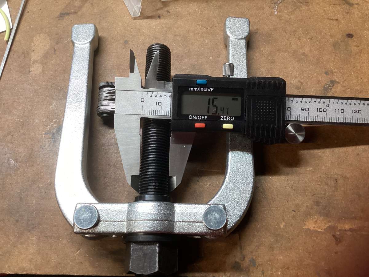

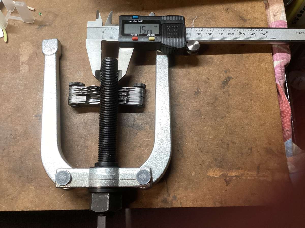

                        Bill Phinn
                          @billphinn90025
                          I don’t know whether there’s meant to be a photo with your opening post, Rowan, but I can’t see it.
                          Anyway, here are two photos of a Chinese-made bearing puller of recent vintage. The intended thread is almost certainly M16x1.5. It displays the notorious (to me at any rate) Chinese undersizing of major diameters.
                          IMG_1501IMG_1500
