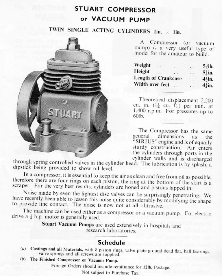

          can anyone tell me what the oiler is off, no markings on it apart from the plunger which is marked ESS the second item looks like a compressor of some sort, very small maybe for an air brush. no makers name on it, gary.

                The compressor looks like a Stuart design that is based on their Sirius engine, which is 1" bore and stroke. That should give you a starting point!
                    From the 1972 catalogue.
                    Rod

                        Gary, Rod
                        Thanks for starting the thread and for the info on the Stuart pump.
                        Reminded me that I have one somewhere in the black hole storage "under the bench".
                        At just over 1 cfm it might be enough to run one of my Bjur spraymist units. Last seen around 2005 so it may be hard to find.
