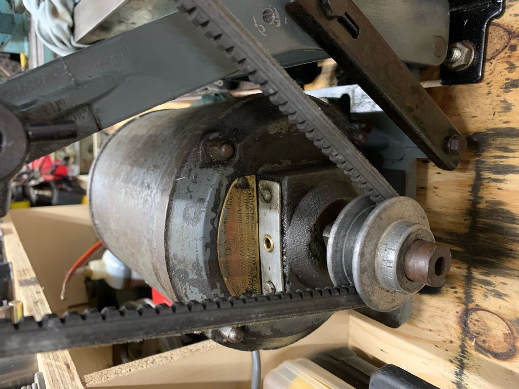

      used my lathe yesterday morning just to run a small piece of brass down for a meccano project, went back to it in the afternoon, push the start button and its starts up running backwards, it hasn't got the reverse option. any ideas

              Hi there David, it hasn't got a capacitor coil that i can see, its an old motor one with the wick string packed around the bearings i'll go and take a few photos

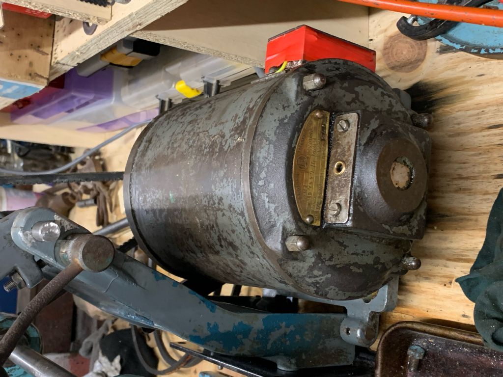

                here are a few pictures of the offending object the old motor theres more in the folder

                  What about the other end of the motor ?
                  There's a type of older motor that uses brushes to start which can be reversed by rotating the brush carrier, no cap involved. So if they come loose……..

                          Your picture album shows the label telling you how to reverse the motor by swapping leads about. The rectangular box attached to the motor could well contain a starting capacitor, they don't have to be in cylindrical form. How that can switch to reverse on it's own I don't know unless the motor has ingested swarf into the internal wiring and that is providing the new starting "wiring"

                                I agree. There's no sign of a capacitor so my guess is it's a split-phase motor. Probably the start winding has failed, but that type also has a centrifugal switch that might be stuck, dirty, or the contacts are badly worn. Worth having a look. The switch will be under the cover with the motor plate at the red-taped box end. Undo the 4 nuts and ease the cover off to see what state the switch is in. With luck some tender loving care will put it right.
                                Otherwise time for a new one because the motor is ancient beyond repair. The other brass plate says the bearings have to be manually re-lubricated every 3 months, and avoiding the need to pay men to do that was a major reason for replacing old motors in the distant past.

                                      i have taken the box off the side of the motor and found the wires have cooked the isolating outer cover on the wires has fallen off leaving bare wires all the way into the windings….. bugger.

                                            Bad news indeed. Likely cause is an insulation failure inside the windings. It's unlikely to be worth fixing.
                                            Deserves an honourable retirement. I don't suppose English Electric expected it to last until 2022!
                                            On the plus side, the photos show it shouldn't be difficult to fit a replacement. Is it worth going 3-phase with a VFD to get smoother turning and speed control?
