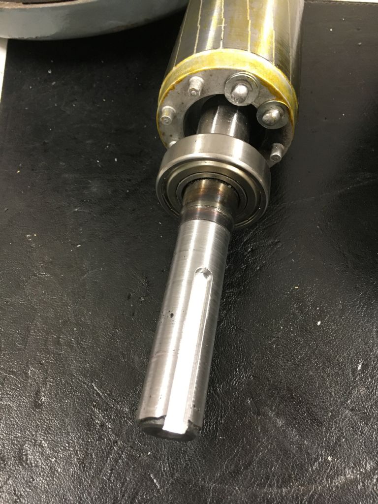

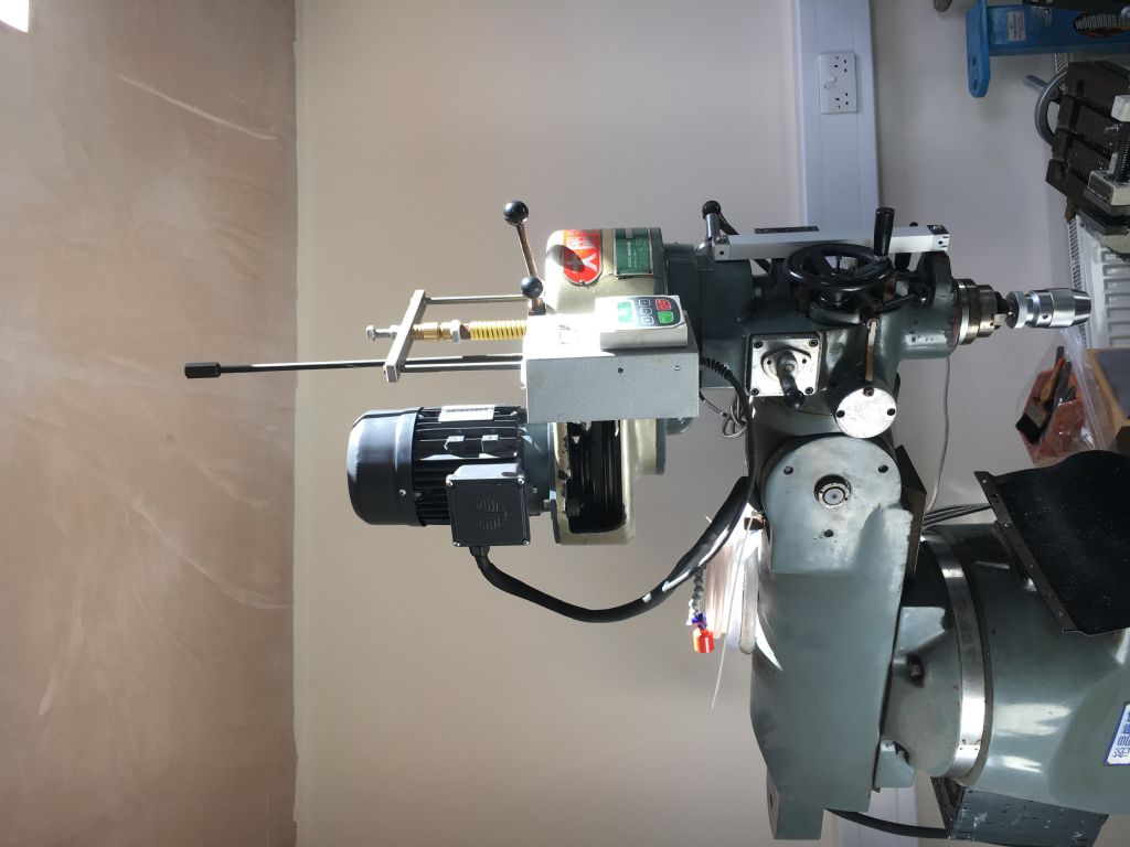

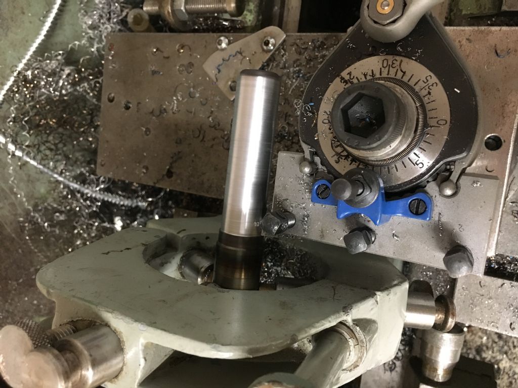

                                  Some time last year I was able to acquire a more powerful (2.2kW) new motor for my Bridgeport clone milling machine from John Stevenson. The original, standard "pancake" motor is only 1.5hp (1.2kW), with 1500rpm base speed. That's a bit underpowered and the top speed is a bit low for some of the modern carbide tools. Besides, when used with a VFD, it's best to have some spare grunt to avoid having to keep change the belts over. Being a Taiwanese clone, I've found that mine is a bit of a swap meet, with metric and imperial threads and various other deviations from the original.
                                  Seems that my motor spindle / drive pulley bore diameter differs from the norm, so when I finally got round to trying to fit it on Friday evening, I discovered that there was some work to do. I'd need to build up the motor spindle from 19mm up to 22mm. It's not sensible for someone like me to attempt to make an adaptor sleeve, as it would only end in tears and massive runout.
                                  So we've all seen how JS routinely builds up motor shafts with MIG wire and turns them back down to size. They don't call me The Sorcerer's Apprentice but that didn't stop me. What could possibly go wrong? I stripped it down to the bare rotor on Friday evening and got it set up, ready to start welding. I managed a quick chat with JS to check I wasn't missing anything and off I went.
                                  Yesterday I was under strict instructions to lift 3 layers of kitchen tiles but managed to keep sneaking off to lay a bead on, with plenty of time between beads to cool down. Then machine it down on the Bantam using my fixed steady for the first time, mill a keyway (manual mode on the CNC milling machine) and reassemble. This morning it went back on. No obvious runout and plays well with the VFD. Job done.
                                  Windows 10 photo orientation issues again. Sorry – forgot to frig them in Paint before uploading.
                                  Murray

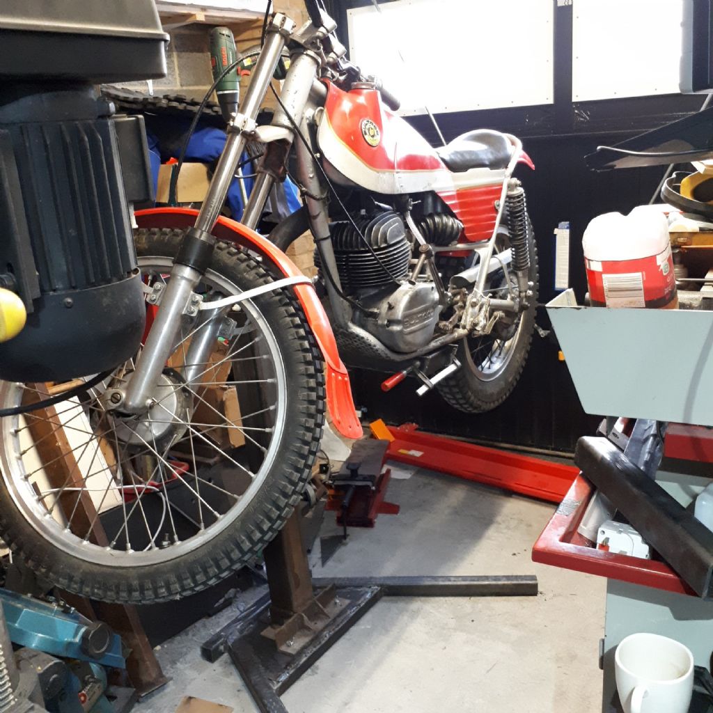

                                      Made myself a motor cycle lift to save my aching back. It's not quite finished but not much to do.
                                      Can get all them little jobs done now!
                                      Michael.

                                        Is that a battery drill providing the power lift?

                                                    Hi Bazyle
                                                    Yes, seems to work ok. Bike's not very heavy.
                                                    The thread is M16 on 2mm pitch, time will tell how well it wears.
                                                    Michael.

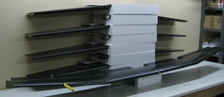

                                                      The Forum 'Tea Room' Topic says 'What did you do Today' (Engineering related), so maybe this (slightly) off-topic post gets shoved somewhere else – but if Farting Dogs qualify, then maybe I will as well ( Qualify, that is..)
                                                      Well, anyway, I thought it fits in the Tea Room..
                                                      Not really what I did 'today' but what gets done here when not doing stuff in the Metalshop..
                                                      We ( my Good Wife and I) play around with a lot of other things here as well. I have designed and do manufacture a small Fixed wing UAV, which is used actively by the Ministry here in there anti-poaching efforts. The Aircraft carries a Day/Night Thermal IR camera, with direct video link to the ground from a max of 20km away, is fully automated, takeoff, flight plan, and landing. I did all the design, molds, composite work, CNC Foam cutting for the wings, etc – A lot of work, but actually great fun too!
                                                      Then we are also very much involved with The Desert Lion Conservation Project – a project which maps the lives, habitat and nature of the desert adapted Lions of Namibia – all in an effort to try staunch there destruction due to human/wildlife conflict. We have developed some 'smart' RF/GPS based logger collars, with a ground base Data logger/early warning system that detects said collar at up to 2km away, and then sets of a siren in the village, with flood lights that point N/S/E/W and a range display that gives the general direction and range to the Lion. Folk are then trained to set of fireworks and make a noise to chase the poor Lion away from there kraals and cattle..The Logger also sends a message to the Ministry, and to us as well as the Game Rangers, a Short Burst Message, via satellite – alerting all to the problem and location. Here is some info on the Desert Lion Project for those interested..
                                                      **LINK**
                                                      And then there is a love of the wild, the bush and the desert that drives us to enjoy play with the animals as well..
                                                      Hope you all will not lambaste me/my post too much..
