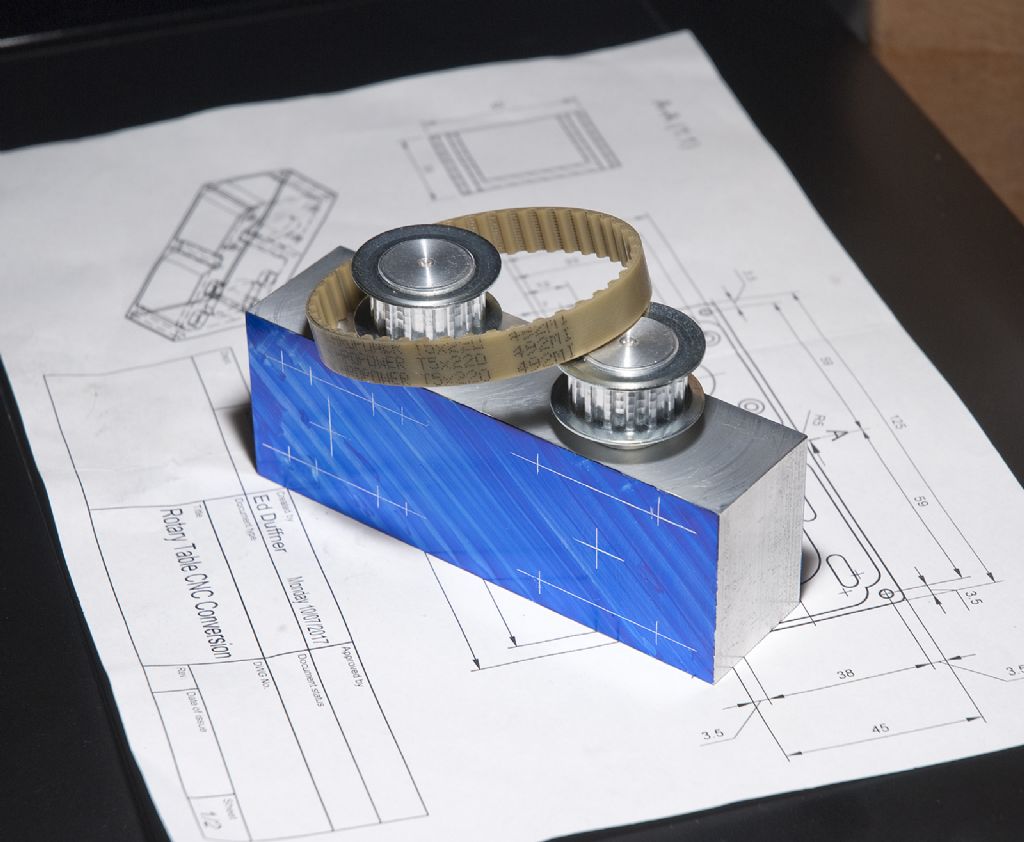

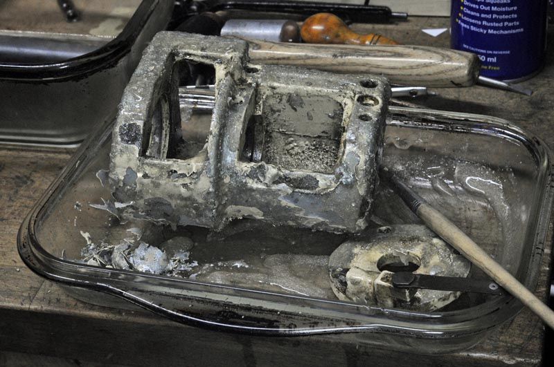

                          Having a break from work this week and doing a bit of online shopping this morning, tools etc – all essential stuff ! and also came across an enjoyable scenic model railway video on youtube (Black Forest area of Germany).
                          Yesterday, made a start on one of my projects. A conversion of the Vertex HV4 rotary table, to stepper motor control. Drawn up in Fusion 360. Hope to get it near finished today, at least the machinging part. The electronics are already done and tested.
                          Ed.

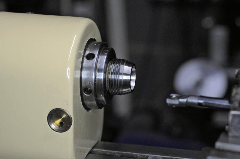

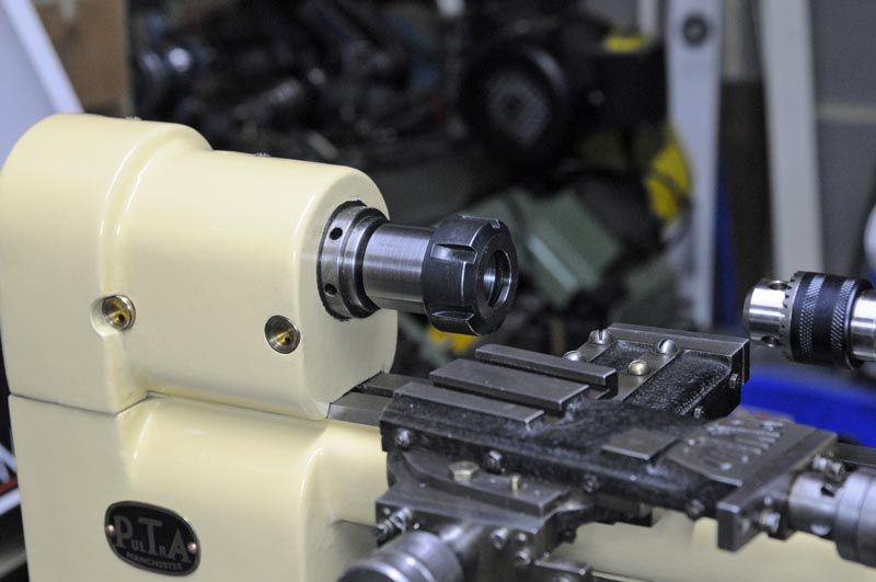

                            Made an ER25 collet chuck for my Pultra. This fits on the spindle nose rather than on a 10mm collet. 7/8" x 26 tpi thread and a 40 degree angled register:
                            Most of the ER chuck was made on the the Myford, I just finished the collet seat taper on the Pultra.
                            The ER 25 chuck actually has slightly less overhang than the 3 jaw mounted on a 10mm collet.

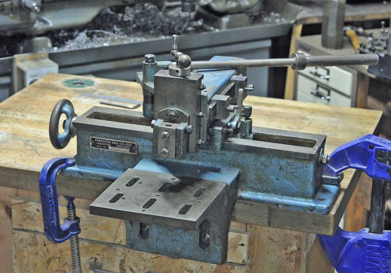

                            Also have to find room for this:
                            I've never touched a shaper before – needs some fettling. The auto advance moves towards the end of the power stroke not, as I would expect, during the return. Perhaps the ratchet needs turning around. At least now I can kill my ebay search and get rid of all those pictures of comfy ladies squeezed into strange shapes surprise

                                A shaper should feed at the end of the backstroke, so something is the wrong way round.

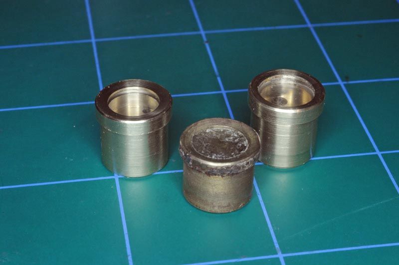

                                        Thereby hangs a tale, which I am considering writing up for Neil. I'd assumed the transparent bit was glass so left them in when stripping the head:
                                        Wrong! They were plastic so I had to make some new ones.
                                        Very impressed with the bearing design, even on this earlier all plain bearing model. The bronze bearings sit in tapered housings with buttress threaded rings either side to control the clearance on the spindle. Absolutely no sign of wear on disassembly.

                                                    As far as the shaper is concerned, rotating the engagement knob on the top of the ratchet through 180 degrees makes the auto traverse work in the correct manner.
