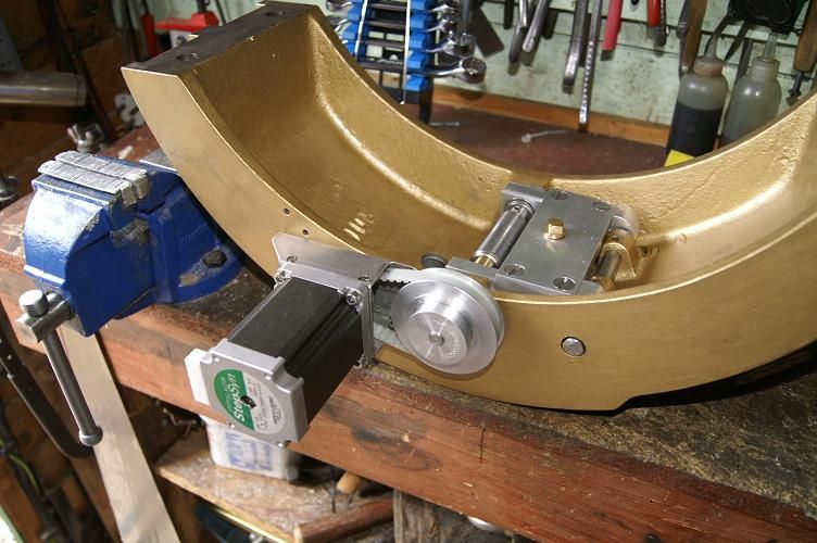

                              Today I made the stainless bracket to take the RA motor with a low backlash belt and pulley set.

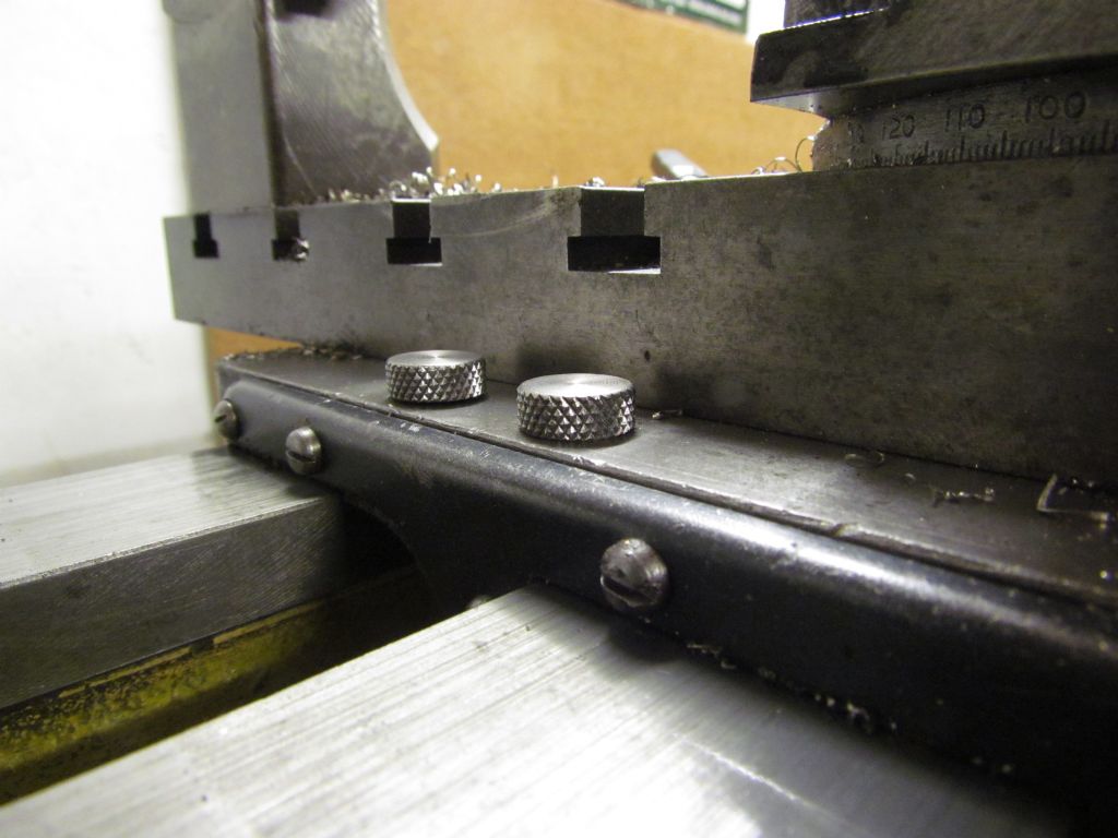

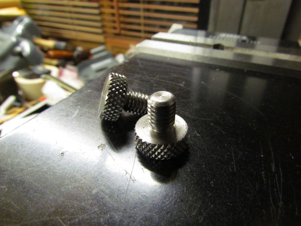

                                Today (well yesterday looking at the time!) I made up 2 knurled 0ba thumb screws on the myford
                                I'm quite impressed with the quality of the knurl, considering the cheapness of the knurler. we could never get it to produce a good knurl on the mini lathe, and machining on the Myford is an absolute joy compared to the mini lathe!img_0488.jpg
                                They are to plug up the 2 holes on the super 7's carriage to stop the swarf from filling the holes up. fun little exercise which I'm quite pleased with the result.

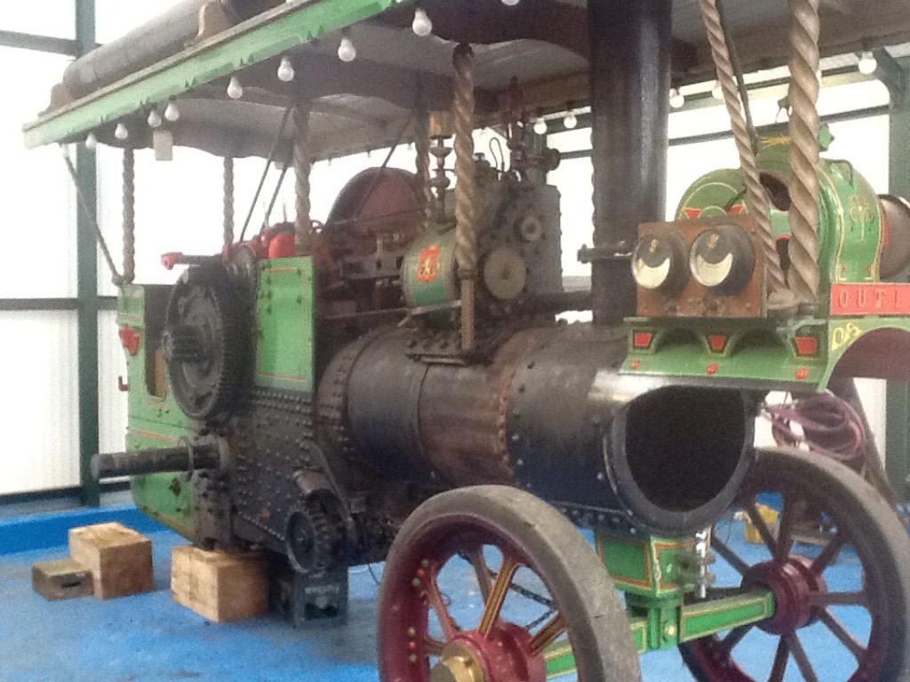

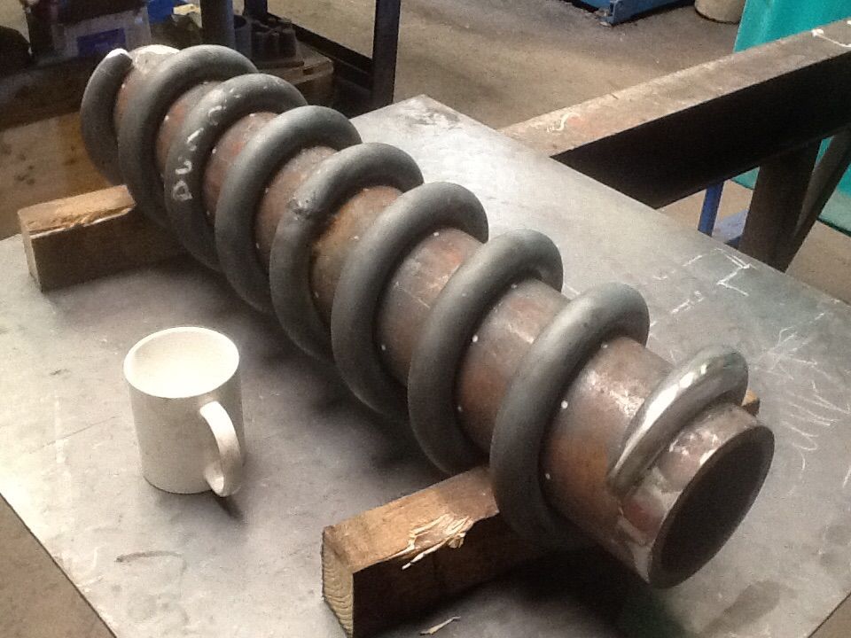

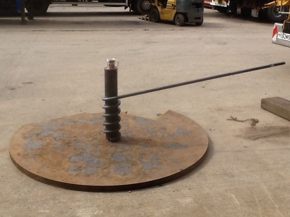

                                    I have been working on repairing and restoring this Burrell Showmans Engine at our works. It was originally just a working engine, and was converted to a Showmans many years ago.image.jpg .

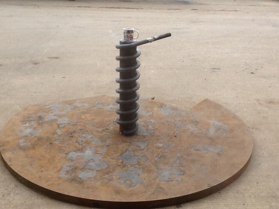

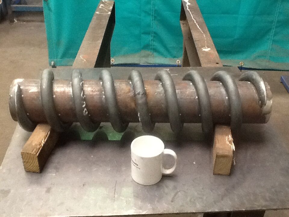

                                    ……One job was to make a new steering drum, with a spiral design to locate the steering chains as they wrapped around it. The one on the engine was just a plain fabricated tube with flanges at each end. I wanted to try and produce one similar to the genuine original cast iron spiral design found on some of these engines.image.jpg.
                                    ……So in two stages a total of almost 4 metres of 30mm diameter solid black bar was heated up with the Oxy/Acetylene torch, and steadily wound around a 125mm diameter thick walled steel tube.image.jpg
                                    …….The 30mm bar has a pitch of 31/4 inches, about the same as the genuine item.image.jpg
                                    …….The bar ends have been trimmed and blended in flat, it is quite a weight already, and there is still plenty more to do to it. The spiral bar will be fully welded all the way round.image.jpg

                                      Hope you have Doune it the right. Hand 🖐️

                                        Yes before bending I checked that, then double checked and finally triple checked. Still worried it was correct while bending it, and was then convinced it was the wrong way round when completed.
                                        #309407
                                          Bet that kept your tea nice and warm
                                          Neat work.
