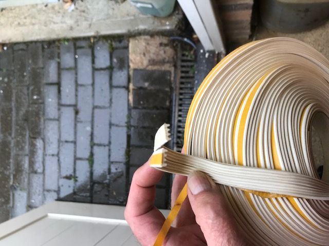

        Assistance required please to locate a sealing strip. The strip is required to seal a thin metal plate which goes over an aperture in the top of a boat's hull. The metal plate is removable for access to a battery and other gubbins inside the hull. The metal plate will not be below the waterline but very close to it and will inevitably get wet when the boat is in motion. I would like the sealing strip to have as low a profile as possible. The metal plate will be screwed down onto the sealing strip to give a bit of squeeze. Does such a sealing strip exist ?

                  10 * 3mm rubber type sealing strip, adhesive one side compresses to 1mm thick
                  Tape
