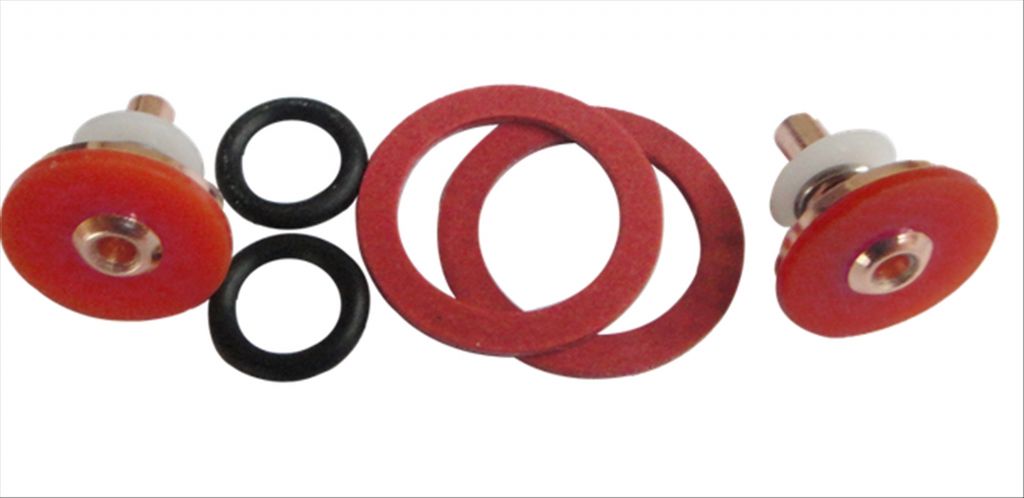

      Gentlemen My hot water tap downstairs develops a squealing noise and the tap vibrates. The stop tap on the hot water is upstairs. Do I open the bottom tap and close the stoptap to empty the pipe, and then open the stoptap with the bottom tap open then close the bottom tap, or do I open the stoptap with the bottom tap closed  or what ?

                        We even put one of the hammer arresters on the outlet pipe of the pump on our traction engine to soften the thumping action of the piston. Made it a lot quieter.
                        Another option is to use an anti-hammer tap washer. These are spring loaded and close more slowly.  Other types are available from plumbing and hardware stores.
                        Paul
