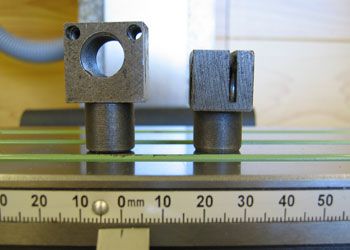

            Journeyman
              @journeyman
              On my much smaller WM14 the lead-screw nuts are adjustable by virtue of a split in the nut which can be adjusted by tightening a couple of allen headed bolts. These are not evident without disassembly, I don't know if the WM18 is fitted similarly. On mine much of the backlash comes from the handle end and can be adjusted to take up the slack.

                #443377
                Journeyman
                  @journeyman
                  On the WM14 there is only one handle on the X-axis and I found that by tightening the nyloc nut at the centre of the handle I could remove quite a bit of the backlash from this axis. It might be different with a handle at each end like yours. Similarly with the Y-axis handle some slack can be removed by tightening the nut.
                  The adjustment on the lead-screw nuts really needs the table removing to get at them. The larger of the two is the X-axis nut. The small holes take M3 allen head bolts to squeeze the slot up
