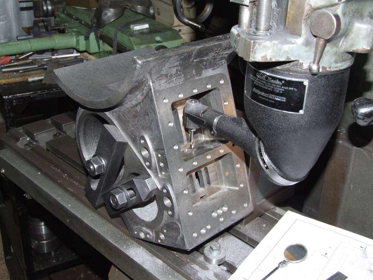

                          Picking up on a few points regarding Bridgeport Series 1 mills:
                          • The Bridgeport is a big machine by hobby standards, over 7 feet tall with the non-pancake motor. I have to stand on tippy toes to get a spanner on the drawbar.
                          • My Bridgeport used to be a corner but, as Clive says, that didn’t work well so it is now against a wall but twisted so the table is at an angle to the wall.
                          • A Bridgeport is flexible, in two senses. First it is versatile in the work it can do but in a less good sense it is not particularly rigid.
                          • Depends on the work in hand but I run my Bridgeport to the limits when I need to shift metal; if I really need to shift metal I use my horizontal mill as it leaves the Bridgeport standing.
                          • I use the ram now and then to get coverage on oversized work but haven’t tilted the head in many years; it’s a pain to reset and is easier to tilt the work.
                          • I run on a 3-phase supply; just makes life so much easier. When I moved into my current place I needed to upgrade the 60A single phase supply anyway so it seemed sensible to go for 3-phase at no extra cost.
                          • I think that the need for condition is rather overstated. My Bridgeport has around 0.8/1.2mm play on X and Y but, with the addition of a 2-axis DRO, it is no problem holding tolerances better than a thou.
                          • Due to the large installed base a huge range of spare parts are available for Bridgeports, albeit at a cost, and will remain so for the foreseeable future.
                          • A little mentioned advantage of an industrial machine tool is that accessories are available that simply don’t exist for machines aimed at the hobby market. For instance I have a slotting head on the back of the ram on my Bridgeport, and some accessories come in useful for those awkward jobs:
                          2021_10070004
                          If space is available and power requirements can be met I’d go for a Bridgeport over a Warco.
                          Julie
