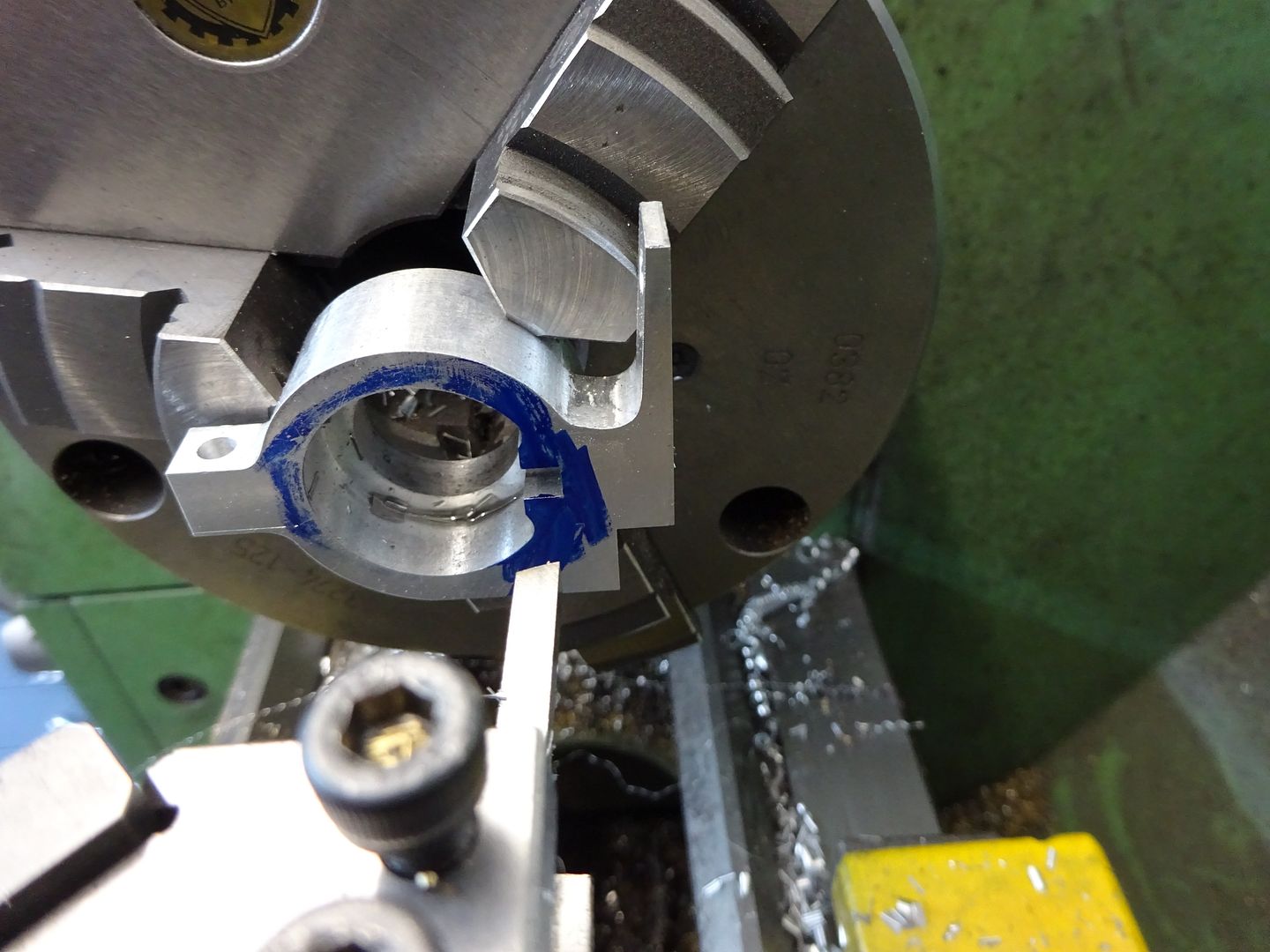

              James, the tool would normally be HSS ground to size and held in a boring bar in the tool post,  then  fed using the carriage hand wheel depth of cut applied on the cross slide.
              The usual way of locking the spindle is to put the machine into a low gear and hang a weight on the chuck. This method was discussed in another recent thread.
              This is a good way of producing  keyways although a bit slow and tiring on the arm.

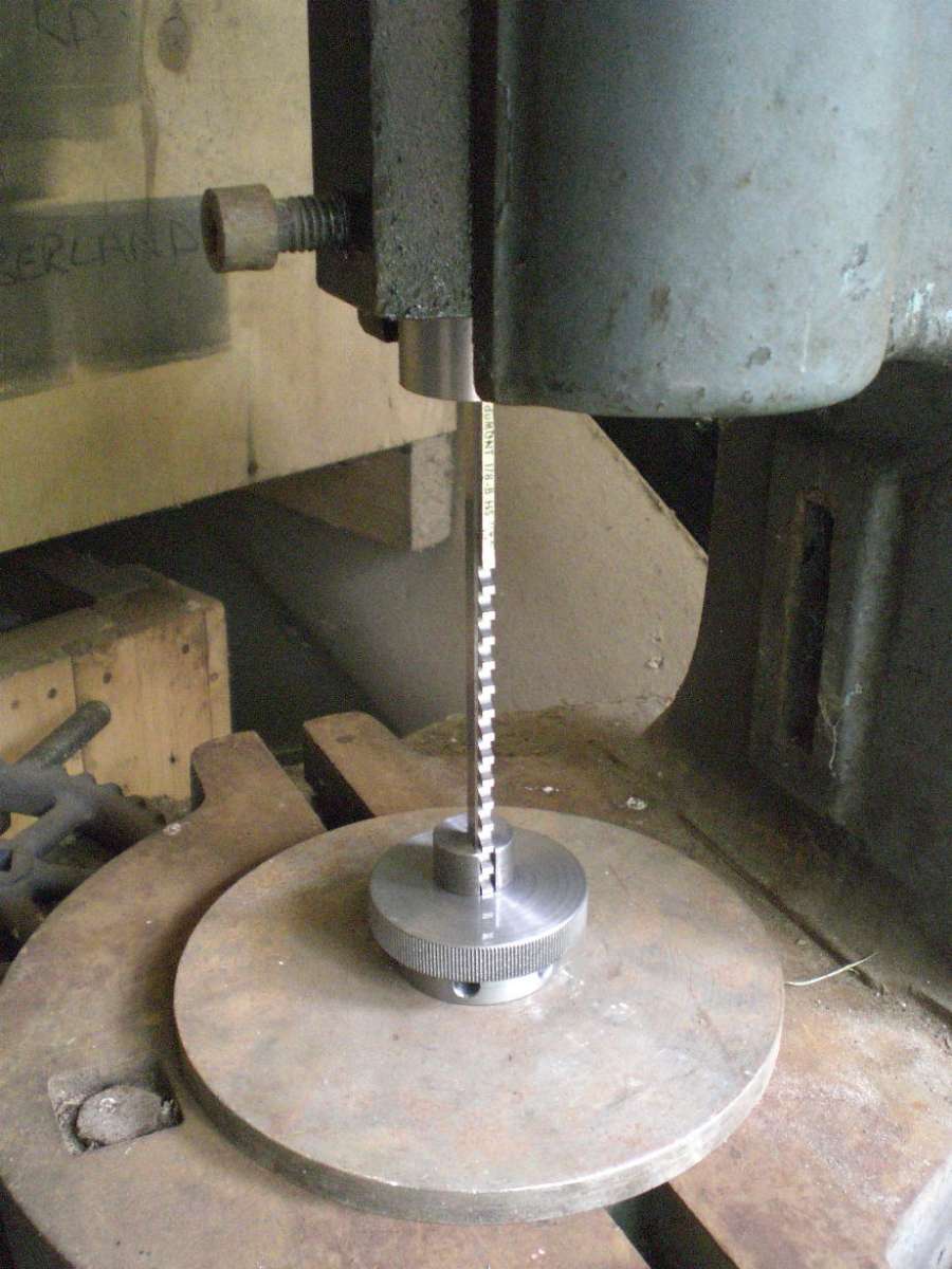

                  Hi, yes you will need a guide bush with a broach, and probably a shim or two, to get the depth of the keyway that you need. Yes they can break.
                  BROCHING
                  Don’t know how you would use one in a vice, as you need a space on the other side for the broach to pass through.
                  You can also cut a keyway using a shaping machine, with a boring bar type tool.
                  Regards Nick.

                                I always plug the centre hole and run a drill a bit smaller diameter then keyway size through where its is going. Drill running half in the plug half in the part getting the keyway.
                                Shifts most of the material so the key cutting bit or broach has less work to do. Few strokes of a file to clear a bit more out of the corners too.
                                Makes big difference to the effort needed, especially if planing on the lathe, which is good thing when using improvised methods. If planing on the lathe with a boring bar arrange some sort of support for the bar immediately in front of the work to combat deflection. Adjustment can be a right pain but it seriously reduces the chance of deflection as the cutter enters the work.
                                The art with this sort of planing job seems to be to get a good clean entry with the cutter working nicely. If you get the angles right there seems to be an element of self stabilisation under cutting loads helping against deflection. My experience is that with a relatively long keyway, where deflection is most likely to be an issue, if the first half or so goes true the back seems to follow just fine. If you have issues close to the front the job turns into a right battle with lots of scraping cuts to get the taper out.
                                I’m certain there is an art to getting planing speed and cut depth balanced.
                                As ever for me third time was the charm! First couple of efforts were, ahem, “seriously disappointing after all the hard work and verbal encouragement”.  Penny dropped on third go. Later I bought a broach set which is much easier. I do think the planing experience helped with the broaches tho.
                                Set something up and practice. It really isn’t that difficult but you do have to dial in the feel for the job.

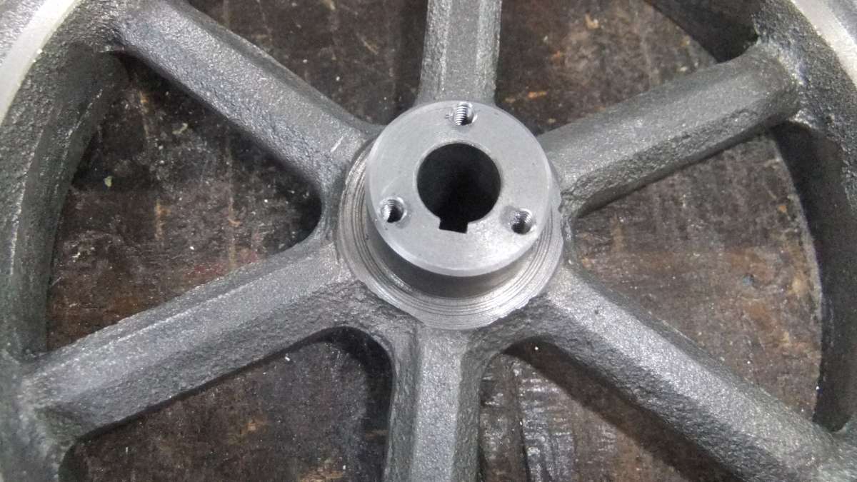

                                    #790818
                                    Dalboy
                                      @dalboy
                                      Having broached the flywheels on my Farm boy I certainly would not try a vice as already mentioned because of the play in them, it may not seem a lot, but I know from experience doing other jobs the amount of side to side movement of the vice jaws and the small nature of the broach it could end in tears.
                                      Even a press needs a careful approach push a little ease off the press and repeat until finished.

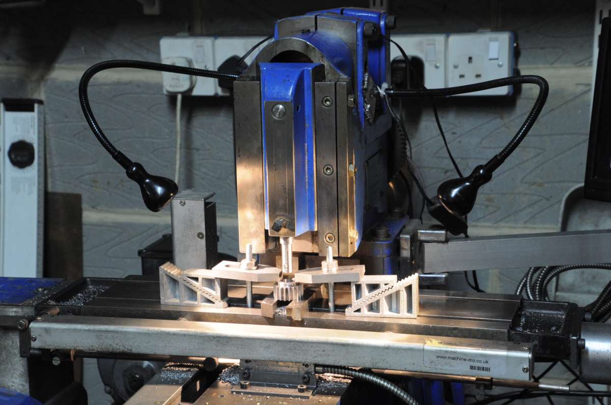

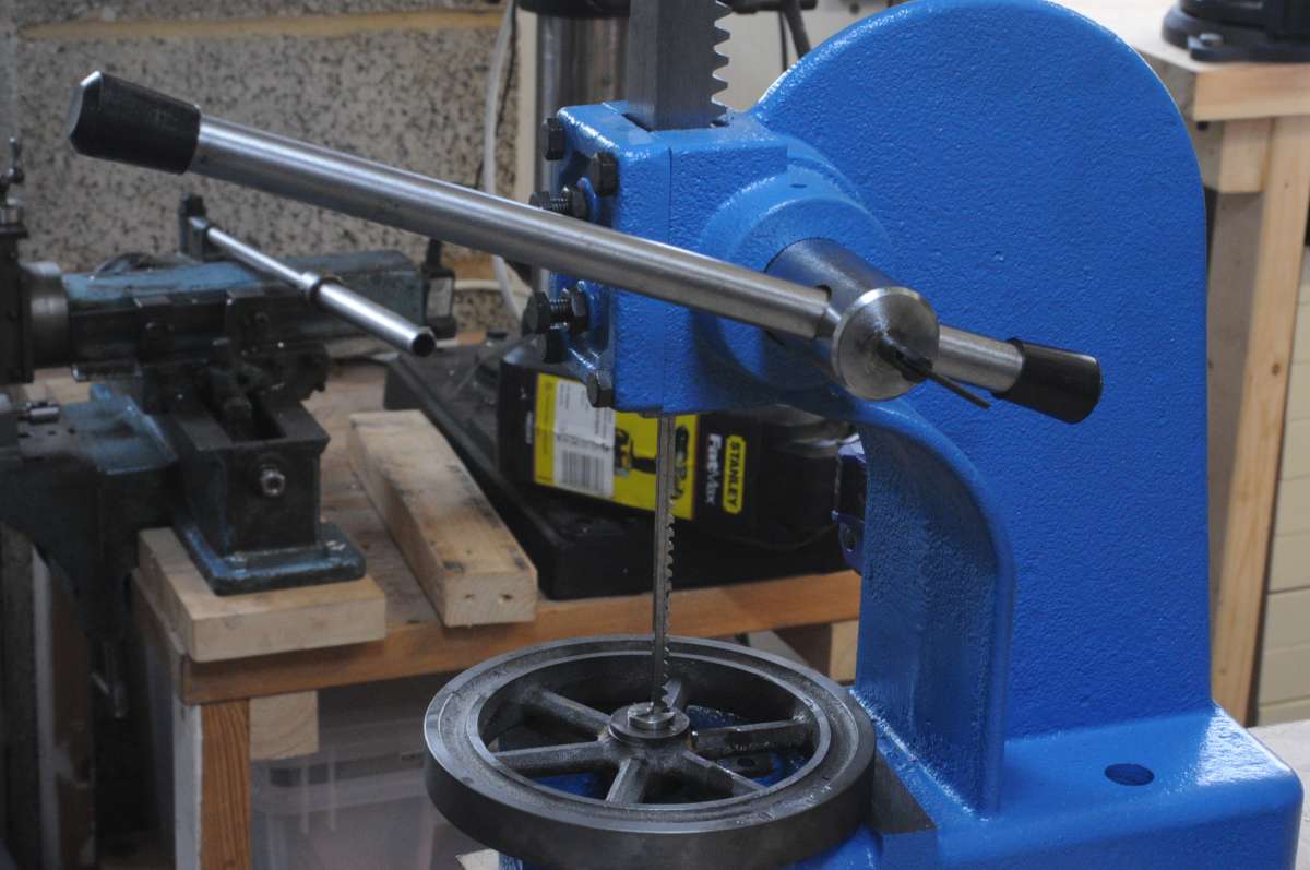

                                        Roderick Jenkins
                                          @roderickjenkins93242
                                          On duncan webster 1 Said:
                                          My mate had a slotter, which is a bit like a shaper but arranged vertically. I bet nog many amateurs have one of those.
                                          I have, as an accessory for my Sharp milling machine
                                          DSC_5506
                                          but when I made my Farm Boy I used a 3mm broach
                                          DSC_6234
                                          but had to make a suitable guide to fit the imperial bore of the wheel
                                          DSC_6233
                                          Rod

                                          Nicholas Farr
                                            @nicholasfarr14254
                                            Hi Rod, I had to make the guide in my photo above as I only had the broach, easy enough to do.
                                            Regards Nick.

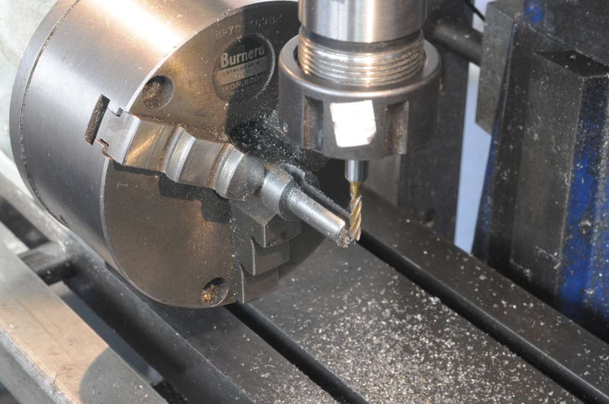

                                              When I had to do this on a model with a 2mm square keyway, I made a cutter and used the ‘lathe as shaper’ method, which worked well enough but was quite a lot of work.
                                              When I replaced the motor on a small woodturning lathe and needed a pulley with a 6mm keyway, I used a different approach (for which I claim no credit as I’m sure I read about it somewhere). I machined a sleeve with a bore to fit the motor shaft and a wall thinness of 3mm, then mounted it in the mill and machined a 6mm wide slot through the wall and along the length.  I bored out the pulley to take the sleeve and located it with JB Weld after a thorough clean.  The job has happily transmitted power from an 0.25 HP motor for several years of fairly regular use with no sign of problems.  On a small model the stresses are pretty minimal – but I guess you could also cross pin if you wanted ‘belt and braces’.
